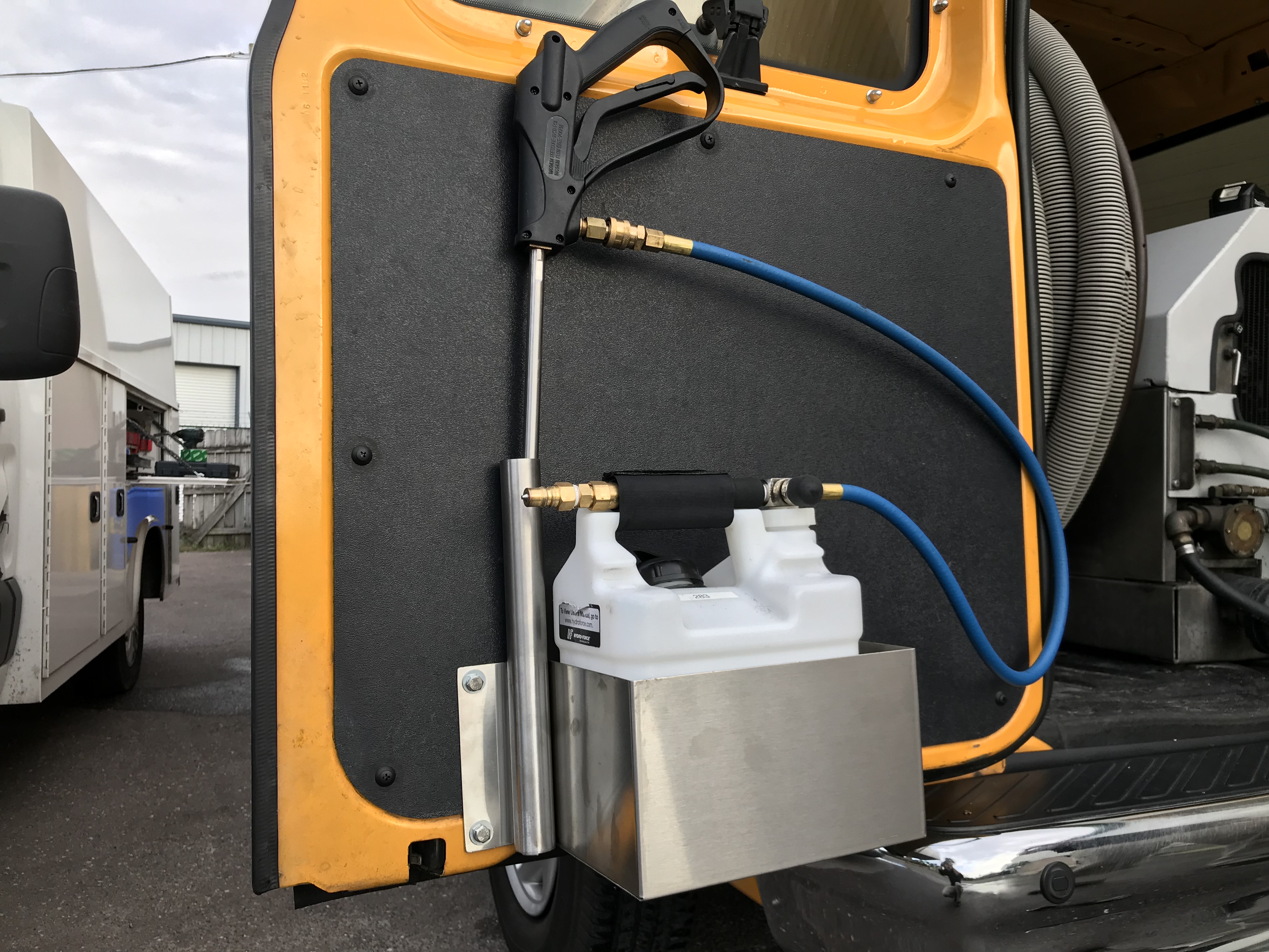

Give them a hydraforce type gun/jet
They can spray out most of the crap that collects behind the brushes between jobs.
Especially pee jobs.
We Pre-Spray with a Hydroforce. Just kill the solution feed or pull the hose? Good idea, thx again for the suggestion

I’m sorry was that English? If the question is “what do we use to emulsify soils?”... the answer would be yes we do pre-spray each carpet. Previously using electric sprayers or B&G cans. Last year we converted to hydro force revolutions. (For pre-sprAy only). B&G for other products
No put the gun on a quick connect at the end of the 3ft hose.
We use just the gun to rinse showers, wash the trucks, rinse lint filters, dirty hoses, muddy shoes, CRBs...you name it.

I see in your photo you have a QC on the gun already but it's the wrong type.
Use the same as that's on your pressure hose.
