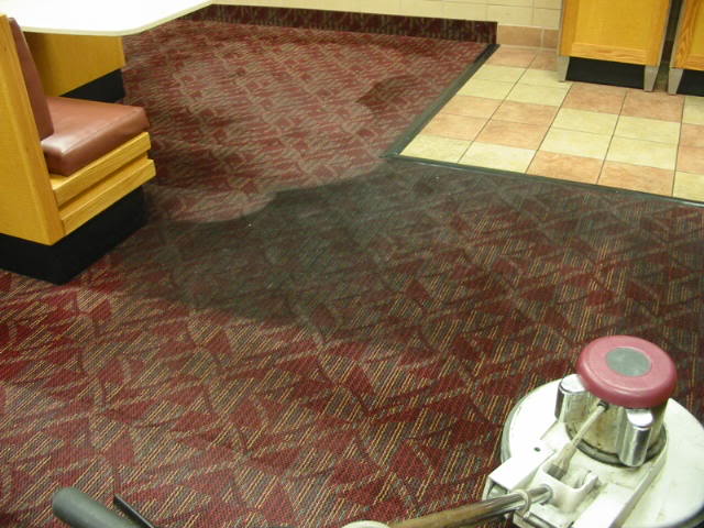

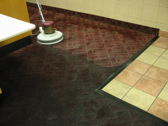

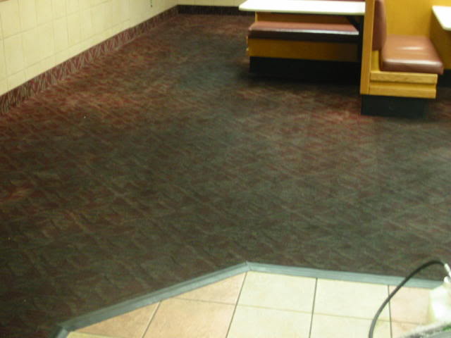

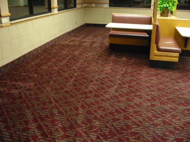

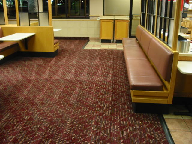

Well I had some fun doing three locations last nite. Haven't been cleaned since Feb.
Glad they called to clean again, guess they sold enough burgers. Used do every month now they say probably be every other month.
Presprayed with Cleanstreak then scrubbed and rinsed with high heat and Dry Slurry.
Before when I walked in not presprayed. DOH!
Scrubbin with the minuteman
After the rinse
Later

I used to have a minute man 175. I used it on every single job, but it got stollen off my truck and I replaced it with an EDIC Saturn. Now I use the 175 about once a month. The Saturn is heavier and does not run as smooth. I really want a minute man except for the latch. Cleaning restaurants is a walk in the park. Any good enzyme prespray will cut through the grease with ease. I think a post pad would be more beneficial than a pre-scrub.

Daniel on this job the pre-spray was sittin on top of the grime. Brad is Nationally Ranked Carpet Cleaner. He did the right thing. Pre-Scrub was a must. The only thing I would have done different was Pre-Scrub with a Green Pad. Daniel if you ever want to be a Nationally Ranked Carpet Cleaner a Pre-Scrub is a must. Scrub and run guys need not apply.

That carpet has a very fine denier, Waldo. A green pad is too aggressive.

Porky they are moving all the tables and chairs prior to me arriving this go around.
Daniel this location was hammered. I hear ya on its easy to clean resty's. When I sprayed it just sat on top so it had to be scrubbed. Why do the slow pull cleaning pass when you don't have to?
Time is money and the truck ran less doing it this way.

I clean a lot of dirty restaurants and agree a pre scrub and post pad is a good idea, but not feasable when you are cleaning 3 thousand square feet for 450 and you are trying to get the job done with one truck in 4 hours. Powerburst applied heavy will cut right through the grease unless they have not had the place cleaned in years. I did clean an auto dealership a couple weeks ago and had to presrub with a green pad and then post pad it. They were paying me good enough that I did not mind spending a little extra time to get perfect results, but please don't ever call me a suck and run cleaner because I can run circles around most of the fat out of shape old timers on this board. I run a first class referral only carpet cleaning service in a city with 10,000 plus carpet cleaners and janitorial services and give customers exactly what they want.
You did a great job by the way Brad

With that type of commercial nylon carpet a good prespray and Steam would have done just as good a job. I do them all the time, I think you wasted some time using a srubber on that carpet but, to each his own. I hope you charged enough doing it that way.

Jaimie what is your resty prespray of choice?
Maybe I wasted 10 min but the end result is what I am after. Thanks for the reply.

Results look great! Which pad did you use with your 175 for this job? I run into new clients where this is probably what I need to do. I can get the same results with a wand but it takes a l o n g time. I have a Versa Pro that I seldom use and would like to get a little more ROI for it.

I usally use Quake from Hydramaster, works great on grease industrial and food grease, I'm not criticizing your job, looks great
but, To me the srubber was unnessary with that type of carpet, Unless you had a helper with you and needed to give him somthing to do.

Don't don't know what kind of prespray you use but that carpet would have cleaned up beautifully with out a srcubber, Maybe you should switch presprays :wink:

Jimmy I did get over 90 bones but not by much. They must have that same beautiful carpet up there?
Billy I used just a white pad for use on VCT. That's what was on the truck and also use them to encap with. White is pretty safe, you can go with a beige for more aggression.
Not a big fan of using the heavy duty green and red pads, I'm skeered of them.
