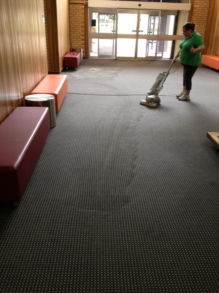

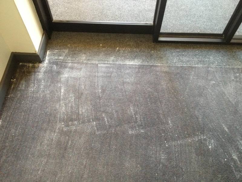

Not sure if this is the kind of feedback you were after but I do some absorbent compound cleaning when needed too and it has worked well. Areas that need absolutely minimal down time can be given a freshen up and put back in service very quickly indeed.
I do some work at the local university, this is an absorbent compound job I did last year in a few corridors.
http://youtu.be/zlaUoUq8Vb0
Did well from a beautification perspective. There were coffee marks in the corridors and the absorbent compound was oxygenated and seemed to deal with them well.

It was a cheap, home user product I bought from the supermarket. In Australia it is called Vanish in the States I think you guys call it Resolve. It is sea sponge absorbent powder which has been oxygenated.
This tells me any brand you like will work OK.

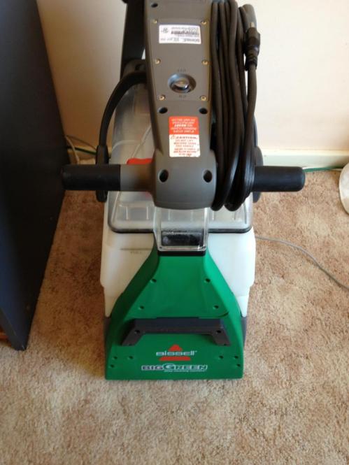

But your comment here kind of concerns me a bit. Looking at his video, there is just no way that he was insufficiently resourced to clean that carpet. You know I'm not in ANY WAY taking away from what he did because he's a titan and I'm an ant, but even as an ant I could have cleaned that job too, and I have a 175 and a Bissell Big Green. Now what would have happened if I had been given the job is that it would have taken longer and I would have had to have done a lot more manual work than he did. And the drying time will favour him too.
Now to be honest, I also happen to think you could have done that job. But the limiting factor for you will be volume of soil recovery. You will clean faster than me, I will clean deeper than you.
