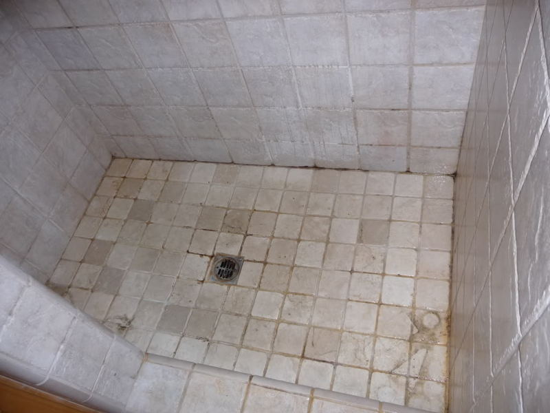

More and more hard surface!
Floors, decks, counters, showers, even fireplaces.
Most just need good chems, some elbow grease and a quick rinse.

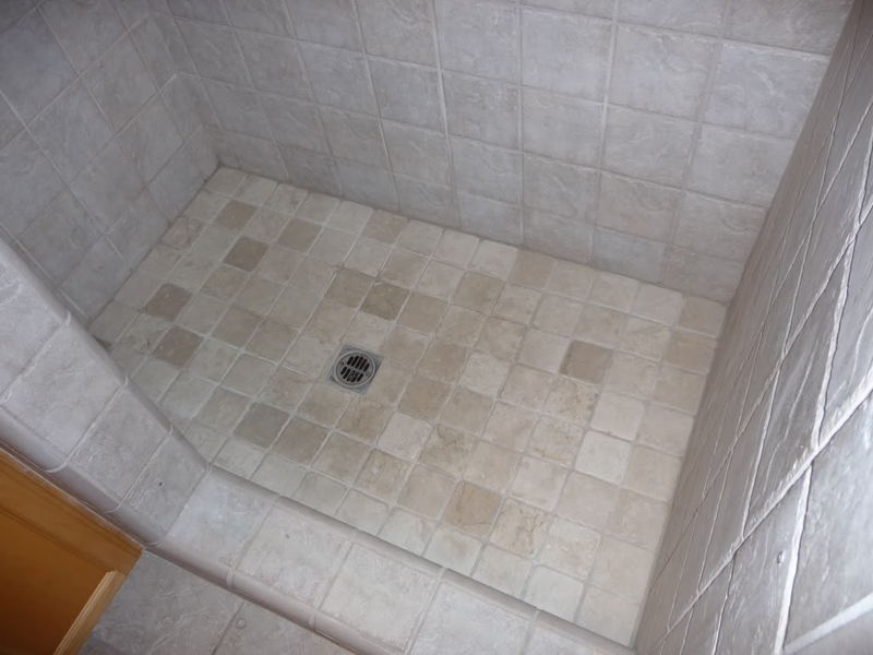

I did that shower and another tub (more pics tomorrow) in 2.5 hours for $715, including some grout repair and re caulking the tub.
Gave two more estimates today., one for 2 showers, counter top and a fireplace. Any one in your slum doing this stuff?

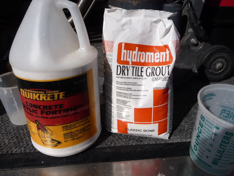

Al's non acid soap scum remover, Stonetech Restore(acid) five razor blades, a grout saw, a small grout brush, a pressure washer(your V and a HF gun), some cotton towels, the Acrylic fortifier and matching non sanded grout for repairing the cracked edges and a well formulated sealer.

Killer, the shower looks great. What do you do when the grout is stained

Albert, use the above tool to scrap off the stained area and cover it with the acrylic non sanded combo

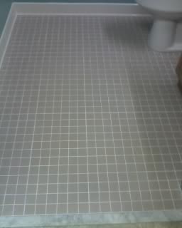

4 restrooms in a doctors office like this one 4 hours spinner tools grout restorer and sealer $850 ticket; nice!!

Mikey, I know that concrete doesn't stick to concrete. Does grout stick to grout. I worked for masons and had to apply latex adhesive to get concrete to stick to its self. Is there something in grout that makes it stick to itself.
Scuff up or dig out some old grout and use the Acrylic additive instead of water and it will stick
