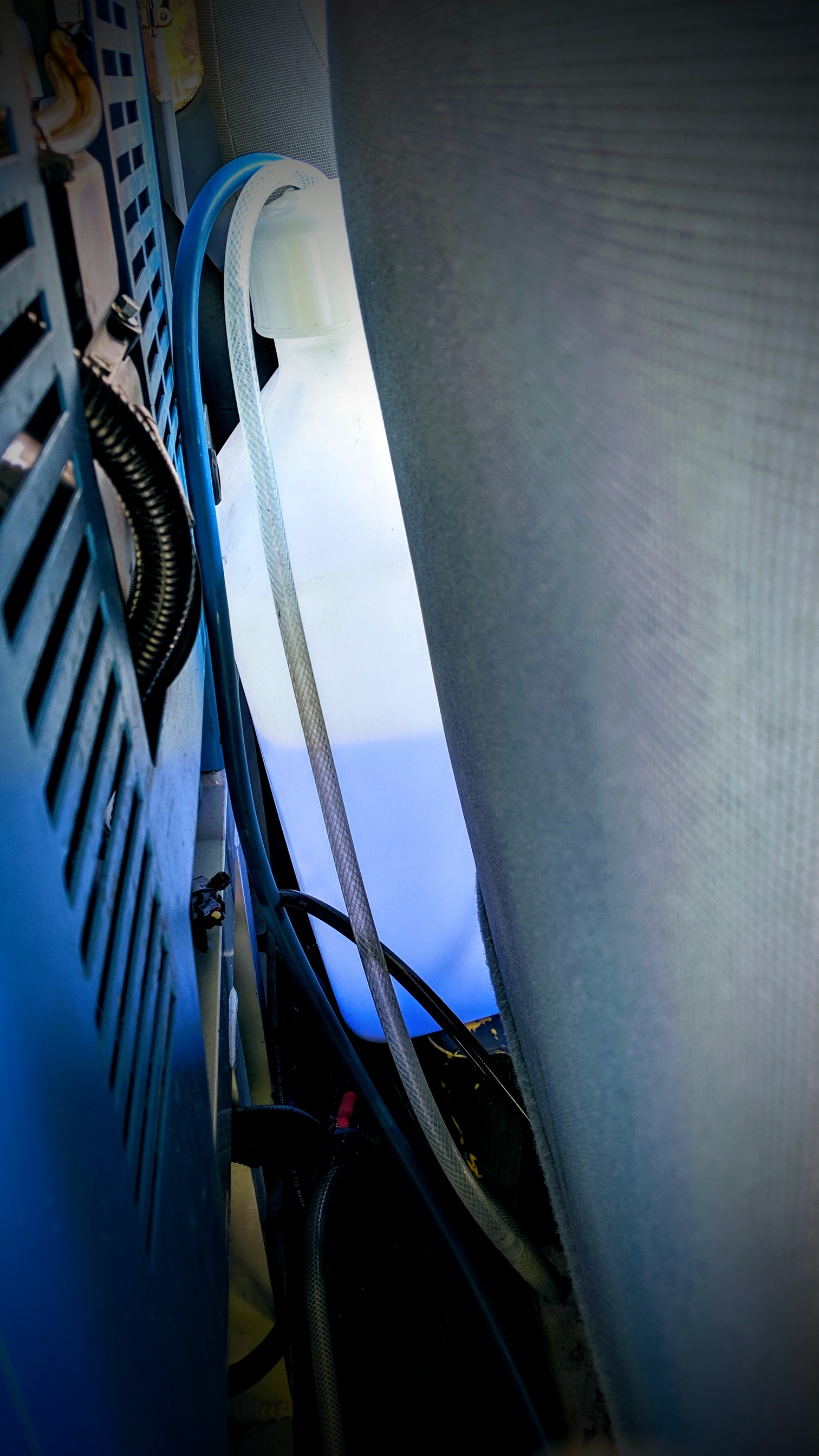

The return on cost is repeat and referal work.
My water costs include sewage which is fixexed at $50 and then water which runs about $20 a month.
Salt I go through about 6 bags a year at about $6 ea and the electric to run that.
The last 6 month's or so I've gone through about 3 or 4 gallons of rinse. A couple glugs per 5 gallons of concentrate that gets me through a 100 gallons of softened water. Sometimes I just fill the jug with water no rinse.
Fuel is about $6 an hour and I can go through the 100 gallons in two hours but it's usually 3 or 4.
That little bit of rinse is a blip. And it looks and feels better than just water. I used just water rinse for about 6 months when first got the WM then I got the feed fixed.
Used just alkaline rinse for about 6 months then started dabling with acid rinses. Then doing all three for awhile before settling on what I'm doing now.
Oh yeah then there is labor costs for each hour worked.
And I make 3 to 4 hundred per 100 gallons of water.
