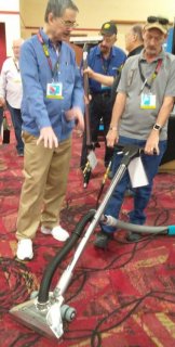

Well, since nobody has really commented on the Bentley PRO, I'll give my opinion.
Downforce of the 14" tool was greater than Lockharts 15" Zipper
(I think Jim noticed the high downforce)
That should give very good recovery of water.
I really liked the large view window. I thought is was a big plus.
More visual indication of any liquid recovered than I have ever seen before.
The 4 Floodjets should cover the 14" and have substantial impact.
The glides are a reinforced polymer that is tougher than PTFE and should wear longer.
The only drawback I saw was that the prototype had cleaned a lot of carpet and the two glides were not perfectly in line with the bottom of the rear wheels. Shawn has promised to address this concern in the final product.
"Big plus" really Larry? :headscratch:
How do you see the window while operating the tool?? From the operators angle you'd need a giraffe's neck to see the front of it. ???
If anything the black hose should be clear so you can see whats being extracted. Who picked black for the hose? Gezzz! :dejection:

Yeah, but you opinion is invalid because they didn't run any water through it. So, you don't really have any idea of how it performs. And it is still a freakin knockoff. Anyone who buys this or a bonzer is defrauding the original designer and inventor, imnsoho
I don't know but just looking at it I would say it nose dives going forward...as you say- downforce - and lifts up on the pull back...Is that what you are blaming on the wheel alignment? That's my observation watching video from the event of people trying to push it...dry without actually spraying or recovering water...even though there were some Morons feeling the floor and saying... "Look how dry! "

When both Jim and I ran the Bentley PRO wand, it was spraying @ 500 PSI.
Vacuum was provided by two 3-stage hi-airwatt vac motors.
I went to dry areas and cleaned with it in both directions.
Extracted some wet areas where some water had spilled.
The view window was very easy to observe.
28,273
I guess you were the lucky one who had water to spray.
Come on really, its impossible from the operators angle to see the front of the tool. A window there is pointless. Then in the spot where you can see the water being extracted you put a black hose!
:oldrolleyes:
Busting balls? Foolish design. Its not Larry's fault he didn't build it. But the man stepped in doodo when he tried to pass them off as features.

Both Ray and I agreed that the large view window is a very useful feature.
It is easily cleanable,
and allows you to really see if there is any moisture at all left in the carpet.
I would like to test the 15" Zipper (adjusted) and Bentley PRO side-by-side on uniformly wet carpet for just water extraction ability.
