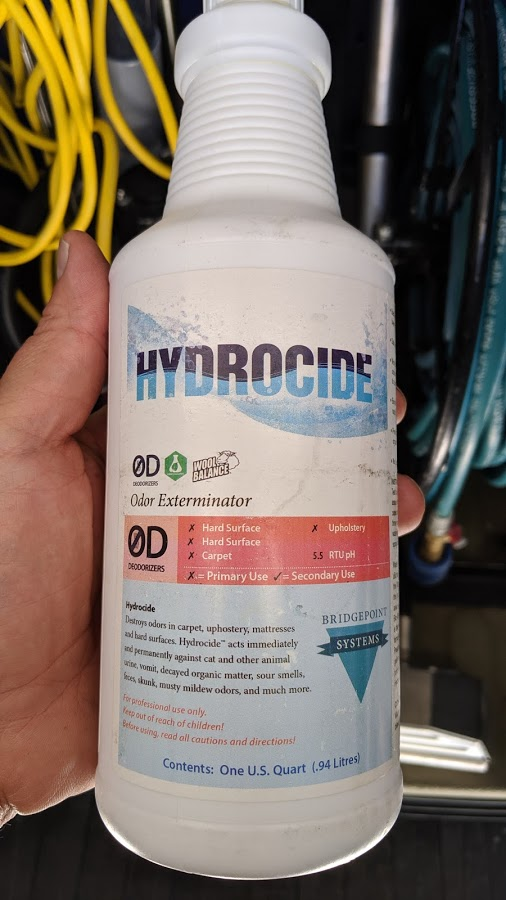

Mikey, your ph wasn't low enough on that hydrocide. Do you have an acid rinse of a ph around 2-3? Just use that diluted at 4:1.

I have some Hydrocide and Saigercide on hand..
@Nomad74 and @hogjowl how wouuld you two pisspros deal with it?
Add 2 cups of Hydrocide per gallon of V-40.
Soak each spot with a pump up, USING A UV LIGHT, to make sure you get the complete spot.
I also add 1 cup of deodorizer to each gallon.
Set up, clean as usual....
