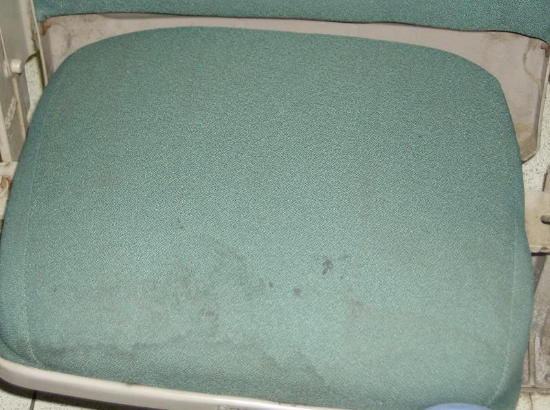

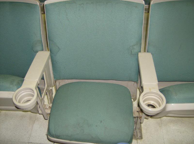

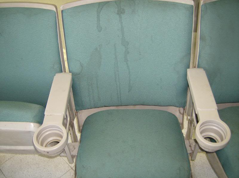

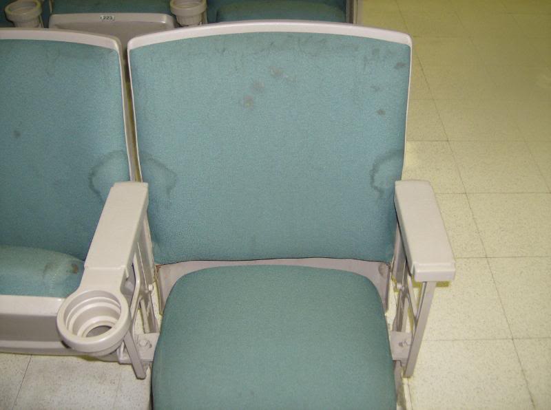

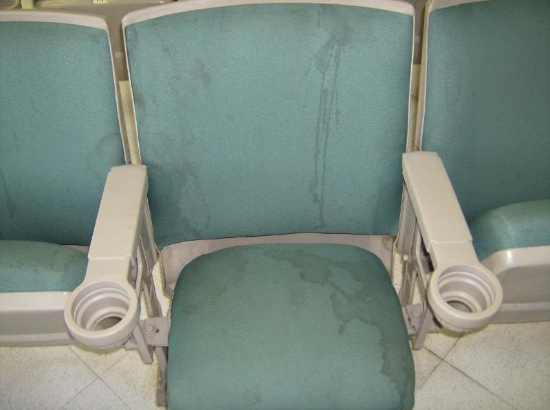

300 of these, they are all pretty bad

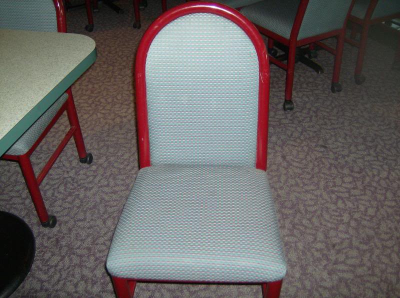

and 400 of these...these are really not that bad at all

Man, that looks like a huge PITA, with the hard floor under them and HWE overspraying on the floor. Lot's of drop cloths. Encapping would seem more logical, but will they feel sticky after encapping?
Also.....would the overspray from HWE remove any floor finish, which might cause the owner to complain about his "waxed" floor?

Enzyme prespray with an oxy booster added then use a furniture tool.
The enzyme and oxy would disolve the drink spills.
Or hose them down with vacaway HOTKNIFE and towel off.
Never had much luck using any kind of drill/brush.Too awkward on your wrists.
Or you could use a cyclo brush machine to scrub and then towel off.
But me I think using HWE with a guy prespraying ahead and you using the furniture tool would be fast. Set them up all in a row and do the assemble line.

Variable speed grinder with heavy duty Velcro and a 7" Tuway thin one pad. need a grinder in the 2-3000 rpm range. Takes about 30 seconds to do each one of those chairs, even the really nasty ones. I could make big bucks on 400 chairs like that.
Take care,
Lisa
Greenie
6,820
I'll try an lend a helping hand.
Like Lisa said, get the variable 7" grinder (jimmy will sell his cheap), and then throw the stock "velcro" drive pad away and use the FLAT SMOOTH one that comes with the kit, it's the one for use with self adhesive sandpaper disc.
Then buy some Industrial Velcro, Lisa and I used this, it was the best I've ever seen, "normal" velcro ain't gonna cut it.
http://store.ccsop.com/catalog/product_info.php?cPath=32&products_id=74
If you are super nice maybe John or Patty will sell you a full square piece before it's cut round, so you can make more than one pad driver down the road, cut and piece works here.
Then use some CONTACT cement to stick it, in case you aren't the handyman, you brush on a coat to the back of the vecro and a coat on the smooth drive pad and let it TACK UP for a few mins., then CAREFULLY line them up and roll the velcro carefully onto the gummy drive pad, you only get ONE shot at this. Let it fully cure overnight.
Gorilla glue will work in a pinch, but it's not as good, I used it mainly to repair a feathered edge later as the velcro wore.
Then, get some of those 8" Tuway bonnets but NOT the ones with the green stripes, just the REGULAR all white ones, you will only use one side of the bonnet for about 50 chairs, don't flip it.
IMPORTANT technique note: "feathering" the trigger is the key to making the variable sander wok well, resist the urge to stay on the trigger, or you'll launch juice and bonnets.
And no matter what ANYONE tells you, do not get the "hand mit" type bonnets and try and cut them and separate them in two halves, this is a big no no, it will SHRED. just buy a small box of the regular 8" bonnets they will make you thousands in their lifetime.
Then get some Xerion (xerionsolutions.com) and have at it, once quick spray and one guy buffing and it's 30 sec. a chair like Lisa said.

Production speed is important on those jobs but appearance is to. Sometimes when encapping dirty chairs you come across some that can eat up alot of time trying get the appearance right while other just go by like nothing.
If that was my project I'd handle it as follows: (assuming hose runs are reasonable)
Take the movable chairs and separate them into two categories, encapable and needing hwe. I would hwe the fixed chairs as they look like some could be a problem to encap.
I would have 3-4 upholstery tools running off of 1 tm. For us that would mean 2 2.5 hoses y'd to some 2" then to the tools in the production area.
Dave don't break you back on that, get some helpers and push them through the job. If you don't have the staff on hand, go to a temp agency, I like Manpower. $14hr each for some guys to stand over those things is worth it. You can easily teach them how to operate a tool and that's all they need to know. All the chairs are the same, and you or a member of your staff can oversee them.

i was planning on hwe the stadium chairs (they are the really dirty ones) the other chairs are not bad at all..the hose stretch is pretty bad, it takes 6 sections of hose to get to where we need to be.
i was mis leading when i said it was a back breaker, it is not to me but is to my guys. i am always looking for ways to help my guys work smarter and faster but with out compromising the quality of the job. they know that they will be soar the next day but they will also be making about 250.00 each for the days work.. i expect a lot out of them but also want to make sure i am doing everything as smart for them as i can.
