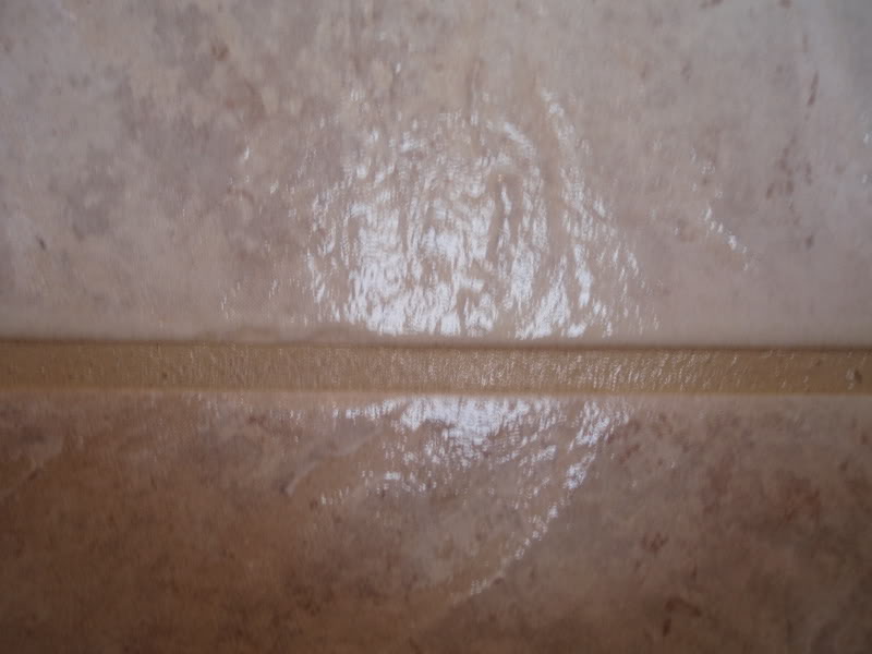

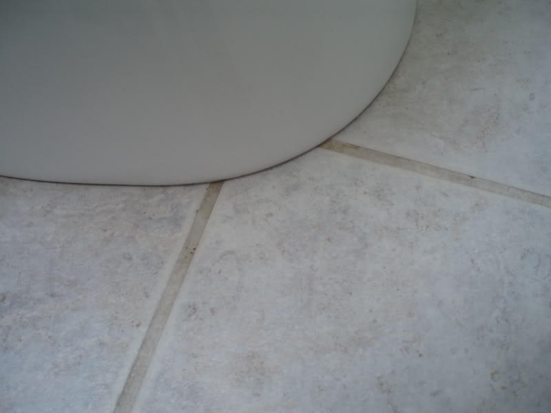

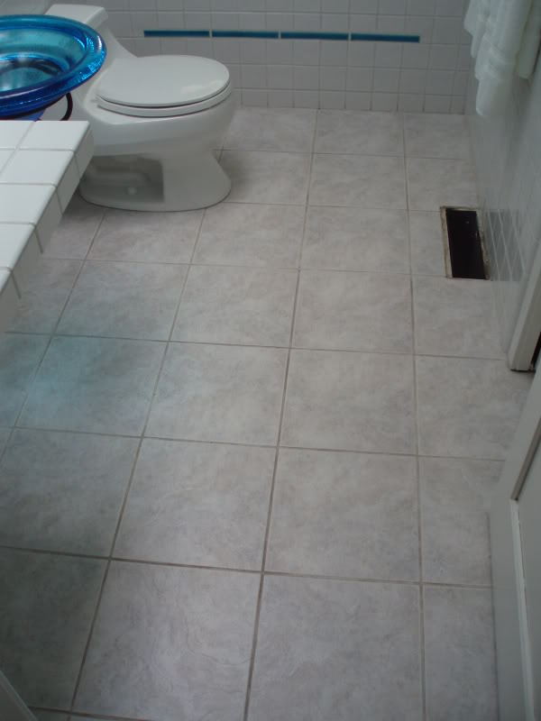

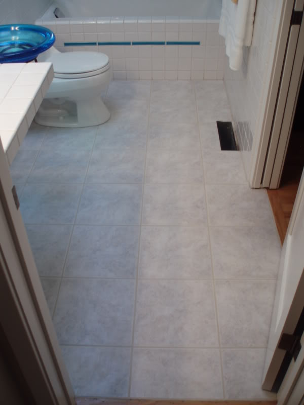

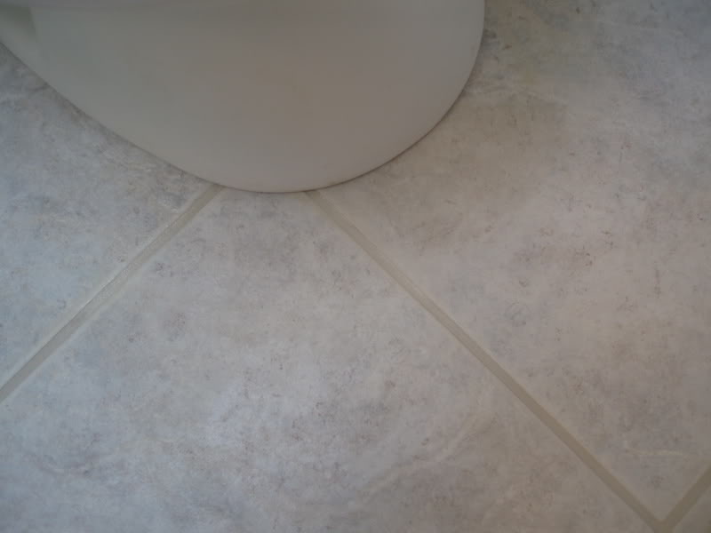

Can you tell this has been color sealed?
Not horrible but urine stained none the less.
B4
After

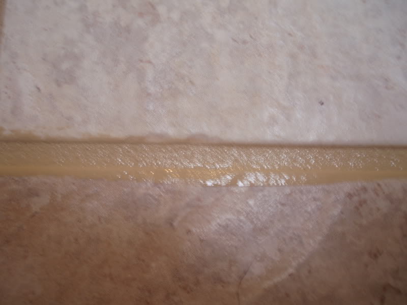

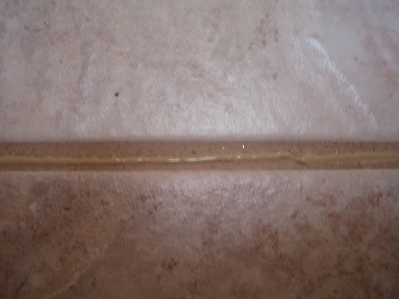

Apply a very thin line..

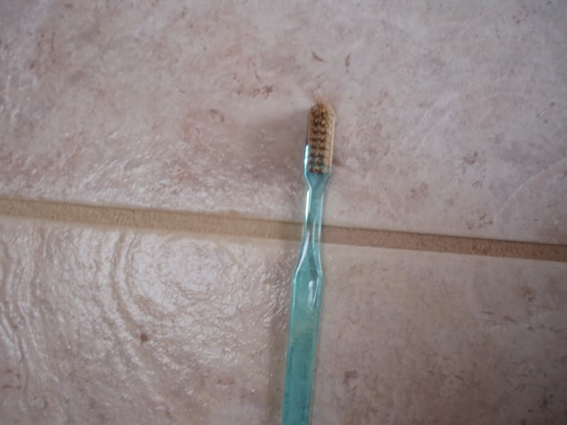

Scrub it in with a tooth brush..
And wipe off!

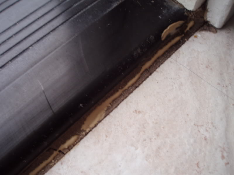

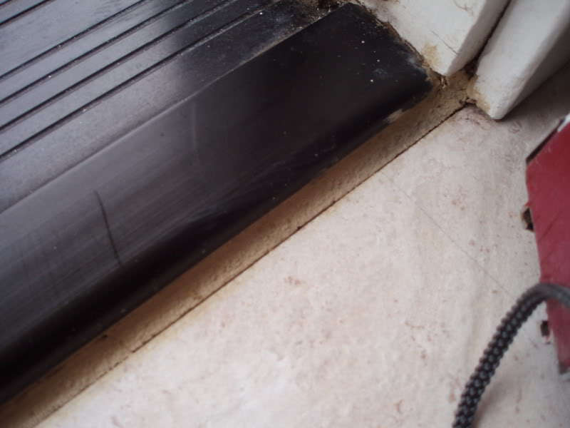

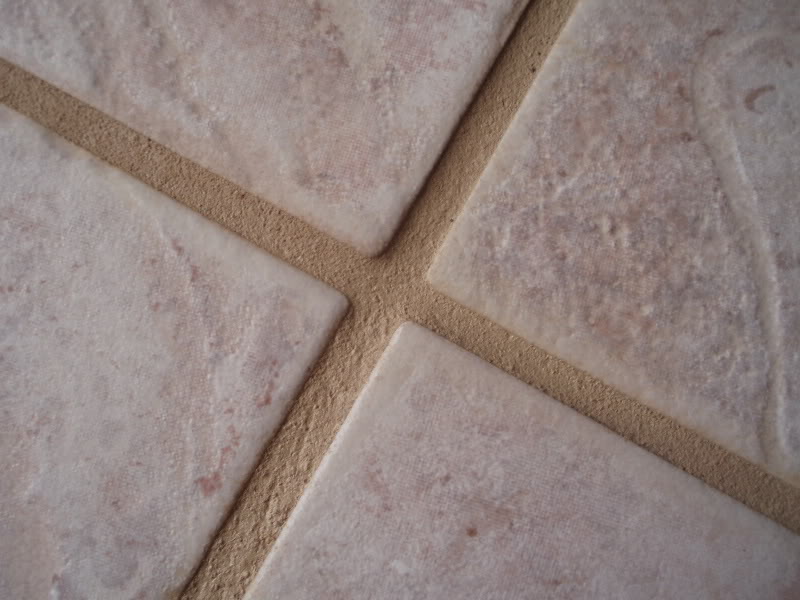

To the left is Color Sealed..
Nasty door jamb area full or Mop staining.
POW!
b4
after

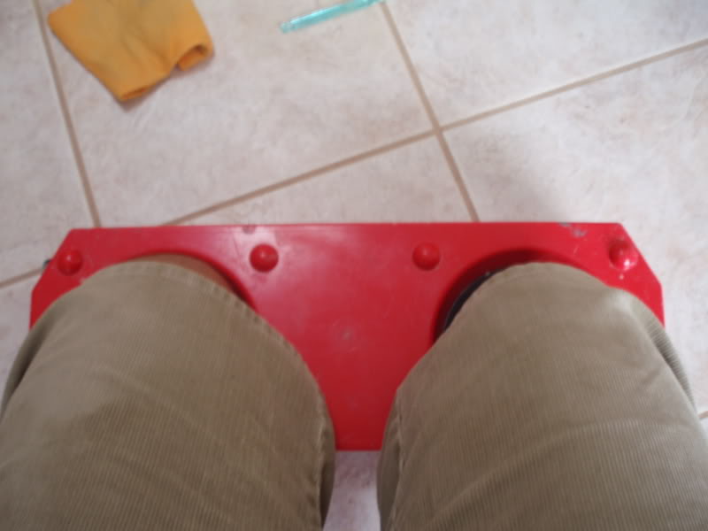

A must have..
safeclean

I love my knee roller specially the sound it makes when I run over grout lines it means i am making top dollar :lol:

And for gawdsakes, get those knee rollers.
