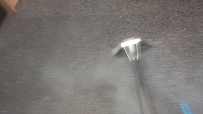

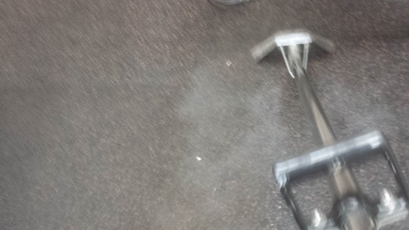

The pics I posted yesterday didn't show the heat I get because of lighting. This is a nice black recycled tire floor in a greasy mechanic shop. Needed the heat to bust up the grease.
