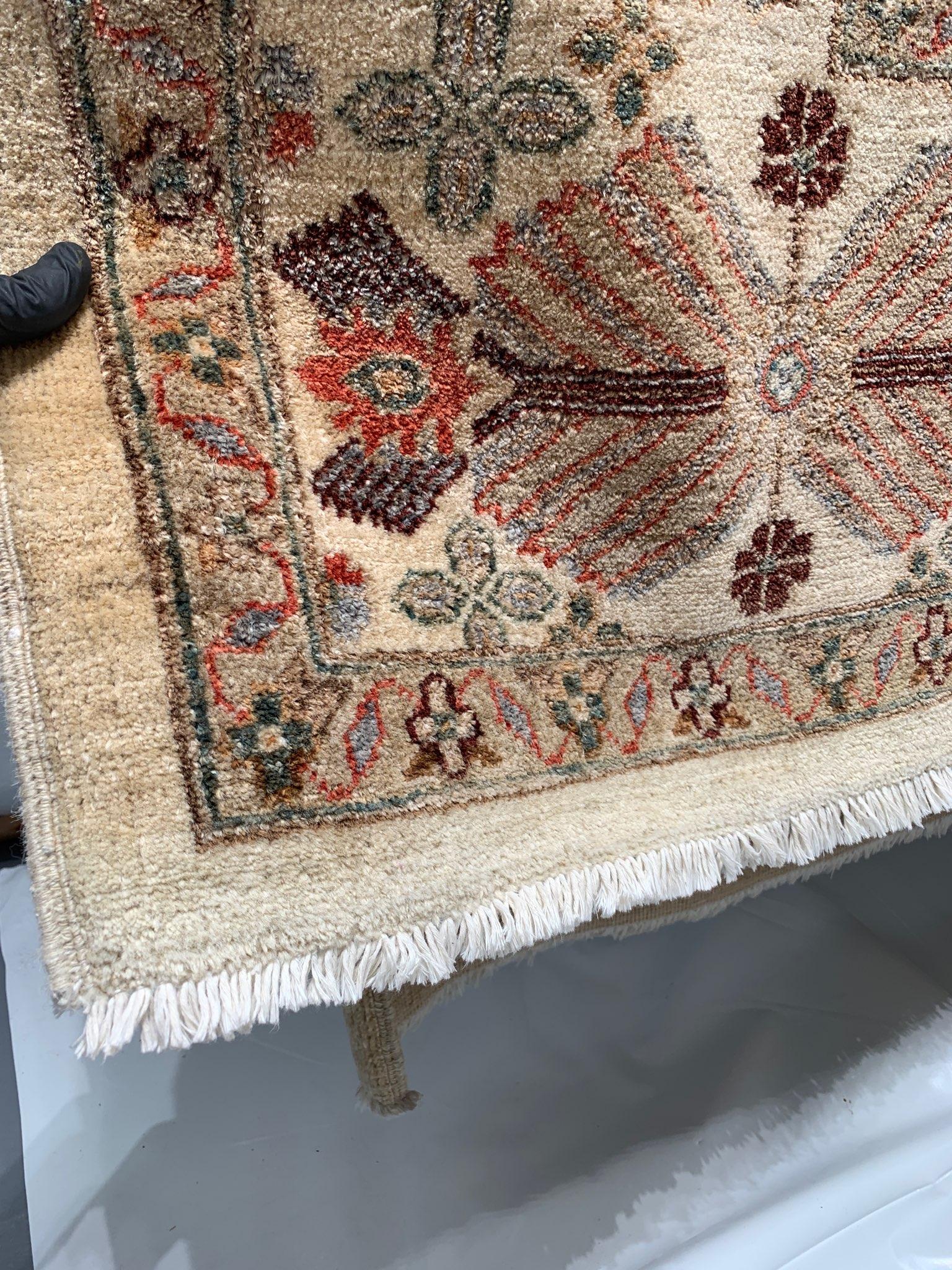

When I pick rugs with fraying fringes, or if the client raves about how brightly white were the fringes when the previous cleaner returned them- I gently pull on the fringes' end. If some of the fringe stays in my hand I know that the previous cleaner was generous.
Generous with the bleaching (oxidizing).
Anybody done some testing on how much damage is done to the fringes with the "safe" whitening products?
12,849
Anything that bleaches damages fibers, especially natural cellulose fibers. Browning damages fibers for that matter, but oxidation especially so.
Its much better not to brown or have dyebleed into them in the first place.

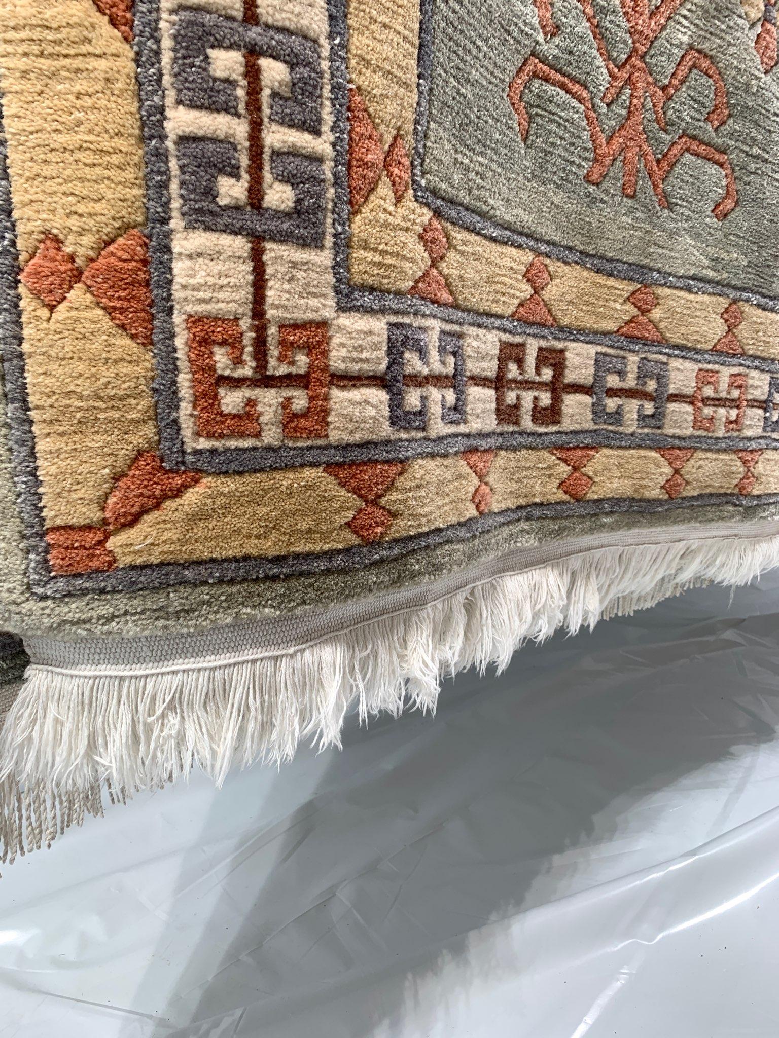

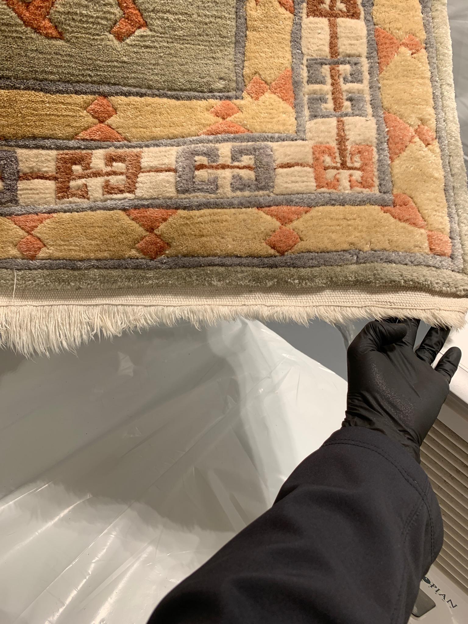

As a general guide, if you see nicely twisted fibers like the extreme left side of the top pic, it will likely be OK. When it has lost the twist and is just individual fibers you'll be able to easily pull it off.
