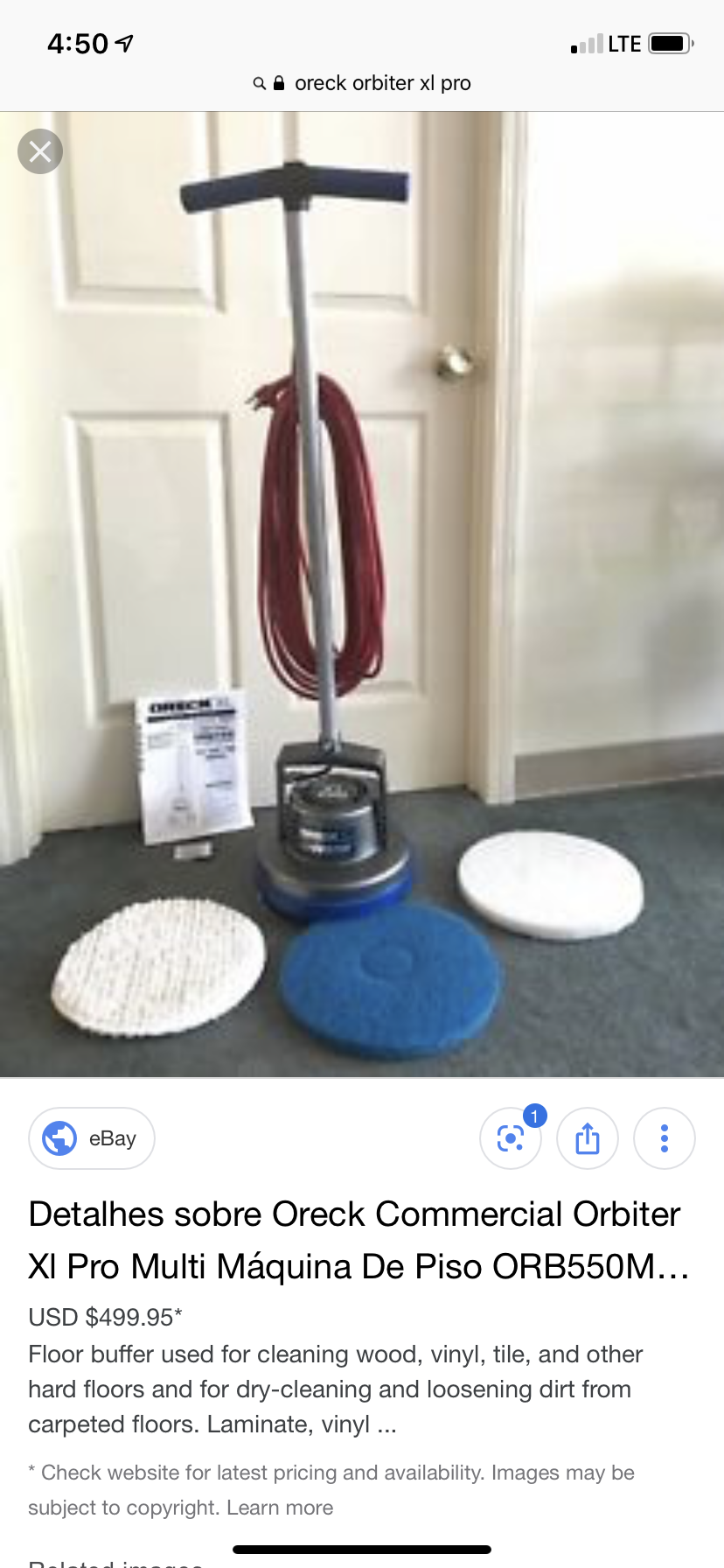

Yup, Oreck orbiter ‘professional’....
I use it on stairs almost everyday.
When I encap, I use a pump up, then run a red pad(presoaked), then a cotton bonnet.... the thing is made for stairs... 29AB79AC-9DF8-45F1-AA9E-D2234FB04431.png

I was thinking about the oreck but still seems a little awkward. I don't know if I want to clean 150 stairs with it. I have a handheld orbital car polisher that seems to have enough power but I can already feel my back aching just thinking about it.

Ron, it’s the only choice.... and ALWAYS scrub from the lower stair ... trust me on this one..
I’ve watched my help trying to work top down...
Yes, it’s a back saver...
I’m sure you can find one on Van Craig’s list....
One hand on the top handle, one hand about 1/2 way down the shaft....
It’s works very well....

Theres a shop down here that sells them and pads as well. Ill have to take a look.
For stairs, they can’t be beat... DON’T go with the homeowner model... shorter cord (30’), and a smaller motor...the professional model has a 50’ cord, and larger motor. And, on startup, ALWAYS HAVE THE UNIT LIFTED UP.... will extend motor life by triple....

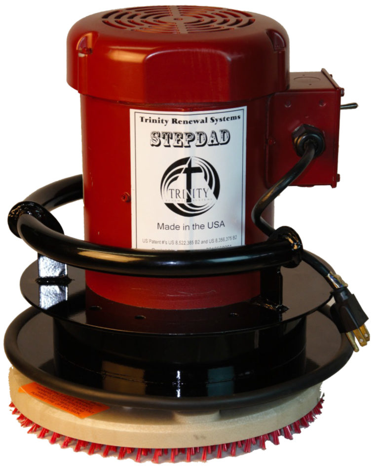

Here ya go, only $1500
encapman

Several good ideas above for encapping stairs. The Oreck Orbiter is good for stairs. A small rotary/175 can also be used. The Orbot Micro is another good option.
