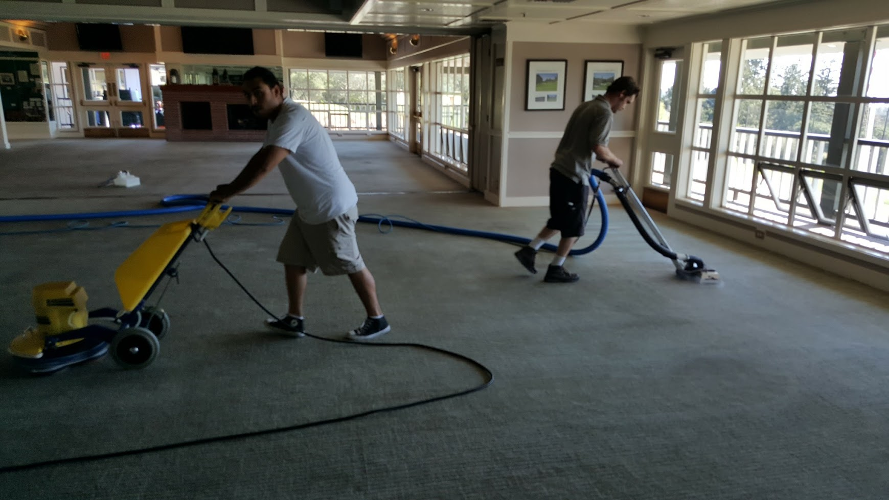

Are they using the cimex to pretreat the carpet or to post encap it?
scotty747
Oct 19, 2006
922
Post encapped for the first time Sunday. Hoses left snail trails in the prespray that wouldn't come out. Spotter took them out but now I had super clean snail trails that looked even worse. Matrix encap and I was shocked how good it looked. They even called early Monday morning to tell me no other carpet cleaner has been able to get this traffic area that clean.
