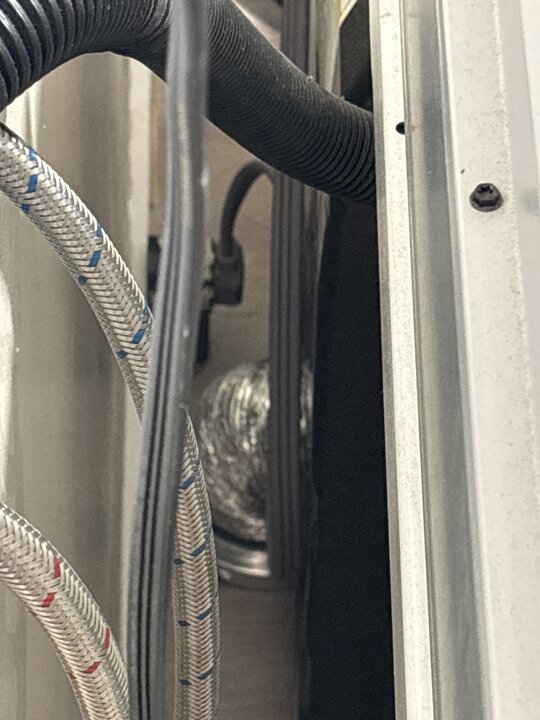

I just installed one on my laundry closet where I can’t get around the stack washer and dryer to connect the hose. I had a 6” drop from the dryer to the vent. I just pre aligned it and slid the washer and dryer in until I heard it click in. Got the first try.
