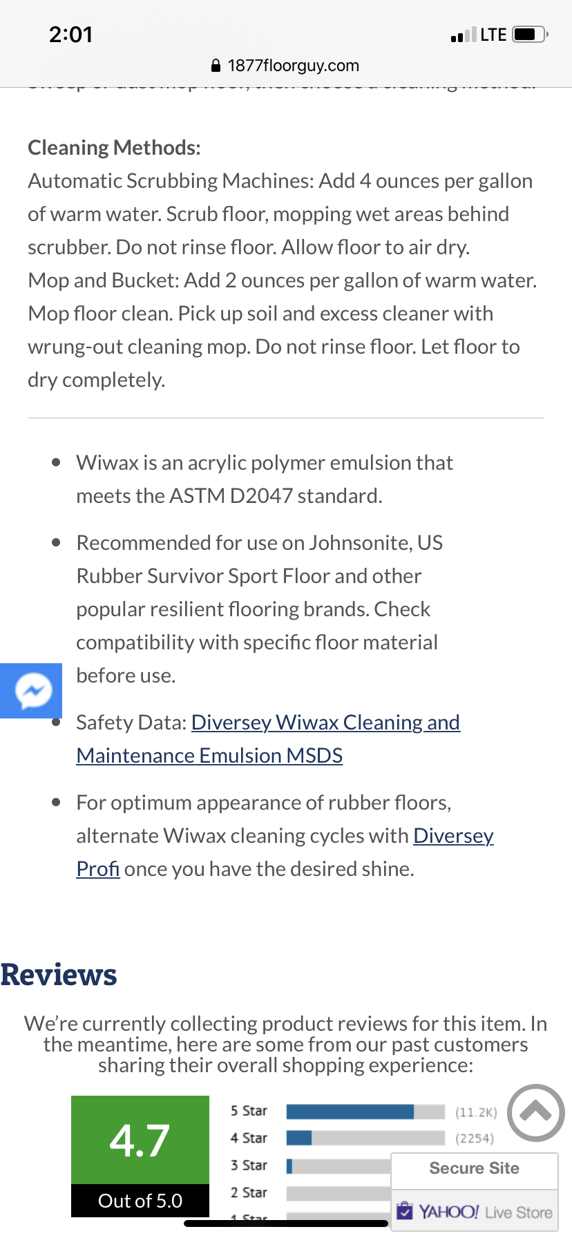

I guess. Mondo recommends using a product called Profi. I get it from Massco, my disty here. It works. I use spp’s on the initial cleaning. Those floors are the birds, but after the initial clean, you can move to green an red pads. But, it takes time. I have 3 basketball courts with it.
