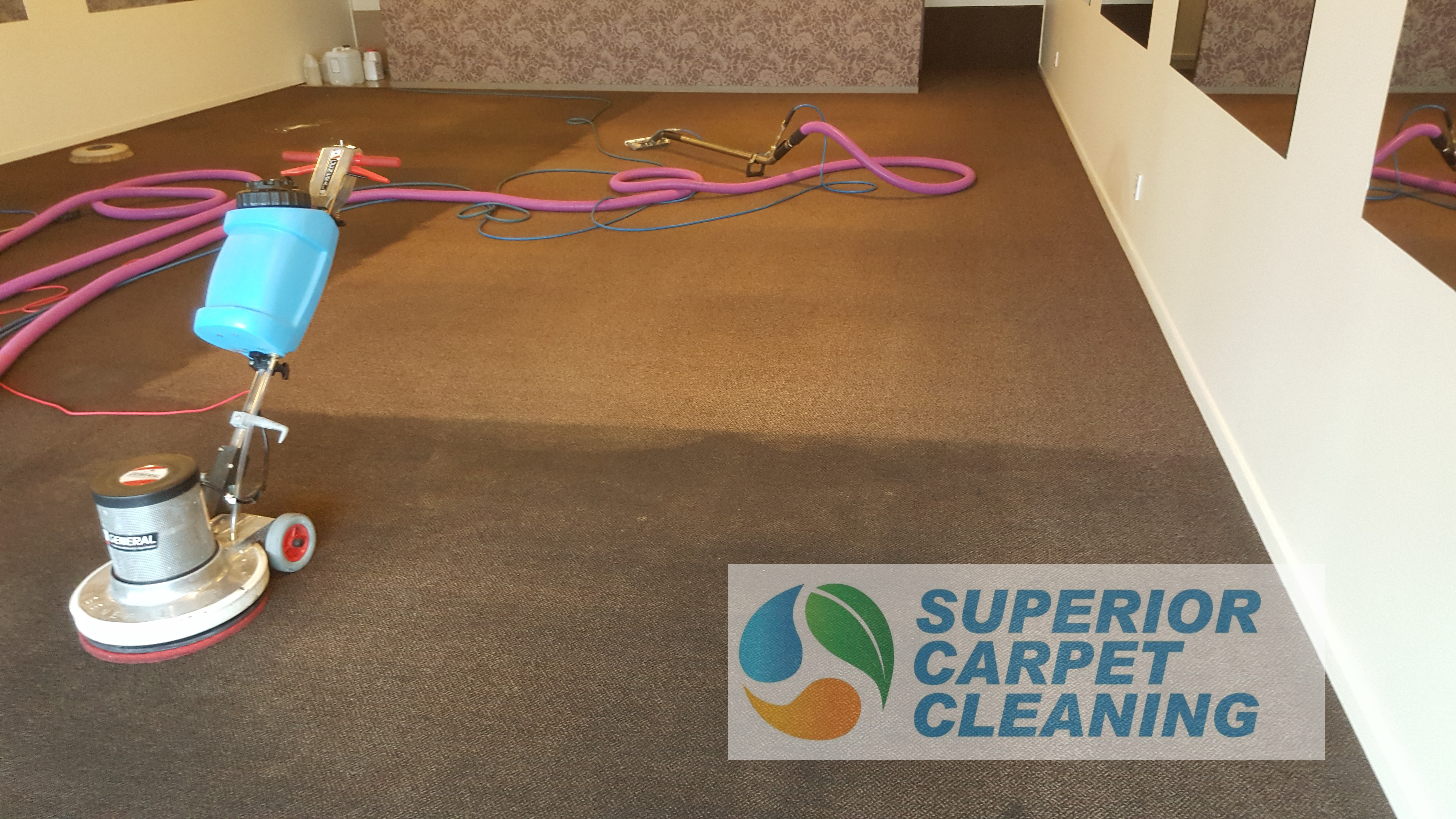

@CJ-FL yeah 175 is a slow speed buffer I use a variable speed 175-330 higher speed is more manouverable and less inclined to bite but you better keep it lubricated...:shifty: cimex has faster learning curve if you can mow the lawns you can use it, i dont do enough commercial to have one.
But I love a red pad scrubbing..
