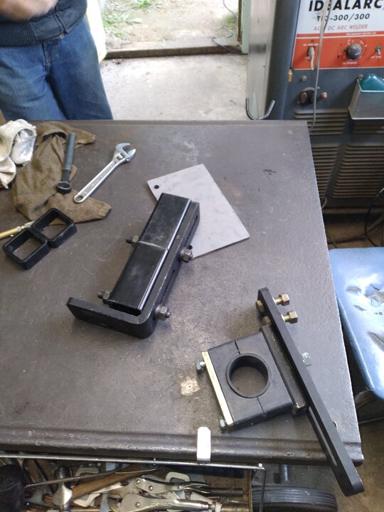

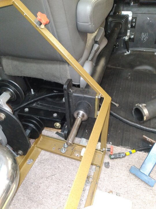

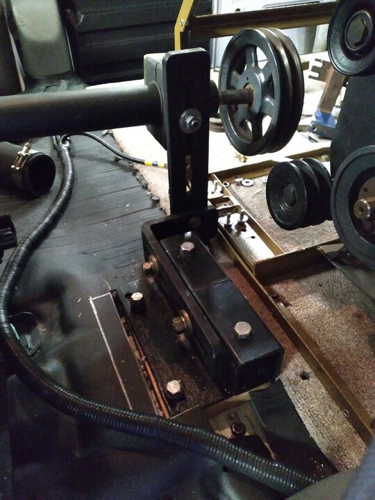

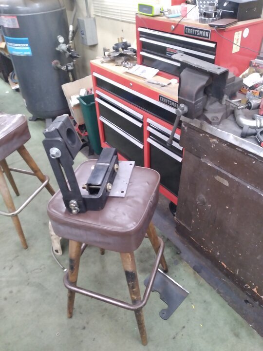

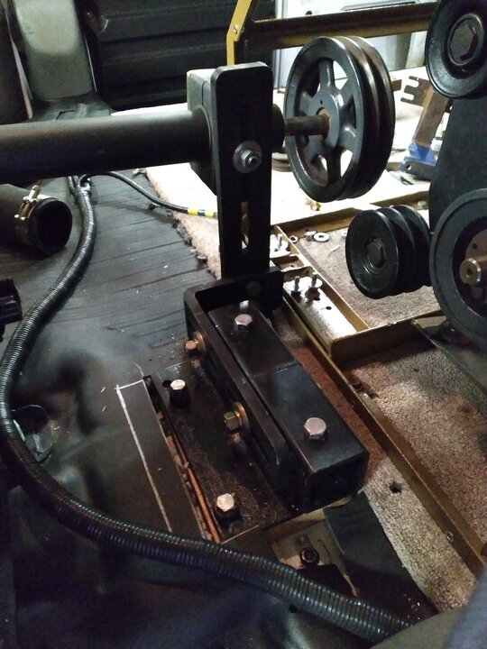

When i installed frankinstien i had to fabricate a rear mount from cleanco parts to allow me to raise and lower and move right or left the machine end of the driveshaft to align
20220312_124318.jpg 20220312_134513.jpg 20220321_095834.jpg 20220321_100043.jpg
