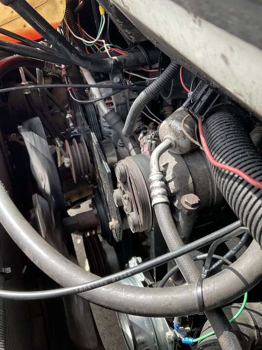

clutch pulley alignment
scotty747
Oct 19, 2006
922
I put a new clutch in a few months ago. i'v gone through two gates belts, looks like the clutch pully is a hair to far out. I engaged the clutch and tightened the center screw to try to cinch it back on. Is there anything else I can do to make sure the pulley is fully tightened down to the shaft?

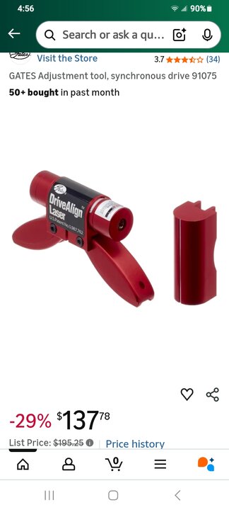

When i built frankinstien i got a gates laser alignment tool. Of all i looked at it was the best ( i did the video below when i was installing my driveshaft and was having a problem aligning it. In that situation the shaft was too far to left) Screenshot_20251211_165625_Amazon Shopping.jpg

Ive been thinking about your problem. A couple of questions. First, did you move anything other than the single center bolt on the clutch? Second, did you replace the clutch with same manufacturer, make,model #? If not there can be slight differences between between manufacturers and or models both of the above could require re alignment. If all the above a are the same . Check your woodruff key and or keyhole for burrs and or debris that could cause the clutch to not completely bottom out on the taper of the shaft. Maybe try temporarily installing the clutch without the woodruff key and see if it pushes farther down on the shaft. If it does the problem is with the key

Thanks Dwain. I was thinking I would pull it off and try to re seat it. The clutch was the one everyone said to get from Napa, They took to long so I got it from Orielys, with the same numbers as the one pictured from Napa.

When you get it off, lay it side by side with the old one and see if there's any small differences. You probably don't have any inside micrometers. But if you lay them both on a flat surface with the magnet side up, place a ruler across it . Using a new, unsharpened pencil or similar item use it to measure from the bottom of the tapered hole to the ruler/straight edge also from the top edge to straight edge . Mark both measurements And compare with the old clutch (hope this makes since) also measure the outside upper(innermost) and lower(outer most) belt groove (edges where belt goes) to see if theres any differences. Easiest way to do that is to set the 2 clutches side by side touching and compare ( both magnet sides up and magnet sides down) if the clutch fits and the belt simply doesn't align you'll eighter have to straight edge align it or pop for a laser. The alignment tolerance for a standard 6rib Serpentine belt is ½ rib for every 6" between closest pulley meaning that if the next closest pulley is 12" away from your clutch the belt can be 1 full rib outa perfect alignment and be in tolerance but if the next closest pulley is 3" away that tolerance shrinks to ¼ rib. Not knowing your equipment that's as close as i can get to advising. Frankenstein is in a 2020 van pulleys are close and alignment has to be made with a laser however my backup machine is a 2000 and the distance between pulleys is much much greater and till Frankenstein I've always aligned the driveshafts by eyeball and straight edge and had no problems

I think I paid around $150 for a laser alignment tool on Amazon. It helped me solve my ongoing PTO alignment issues.

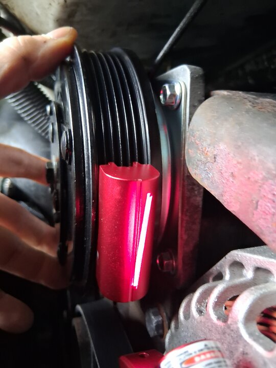

I pulled the clutch, and when I spun it I could hear something grinding, the bearing or the outside thing that pulls in when engaged. I'll throw the new one on today. The magnate had a mark on it too so I know it was not aligned properly. Thanks, Dwain.

This is from the alternator to the clutch. if I shim the bottom bolts to straighten it out will it mess up the parallel alignment? Any thoughts on how to fix this. Thanks,

Raise front of shaft or lower rear to make the line straight (parallel) but first check the laser with the adjustment plate provided with laser to be sure that laser its self is correctly adjusted and aligned . Once the laser line and target lines are parallel then move in or out to align i just changed my thought from raising the rear or lowering the front because of the position of your target and laser. I place the laser on the clutch and move the target to different pulleys for reference, you have the target on the clutch so the read will be opposite . eighter way the back (machime end) of the shaft has to be adjusted up or down to straighten the line (hope this makes since) if you like or need more information for this to make sense there's a diagram in the laser instructions.if you need more personalized guidance to make sense of this feel free to call me 707 357-1982

Thanks Dwain. The belt jumps to the back of the pulley. How do you raise and lower the shaft?

Lower front of shaft or raise rear to make the line straight (parallel) but first check the laser with the adjustment plate provided with laser to be sure that laser its self is correctly adjusted and aligned . Once the laser line and target lines are parallel then move in or out to align
Also take a reference shot to another point
