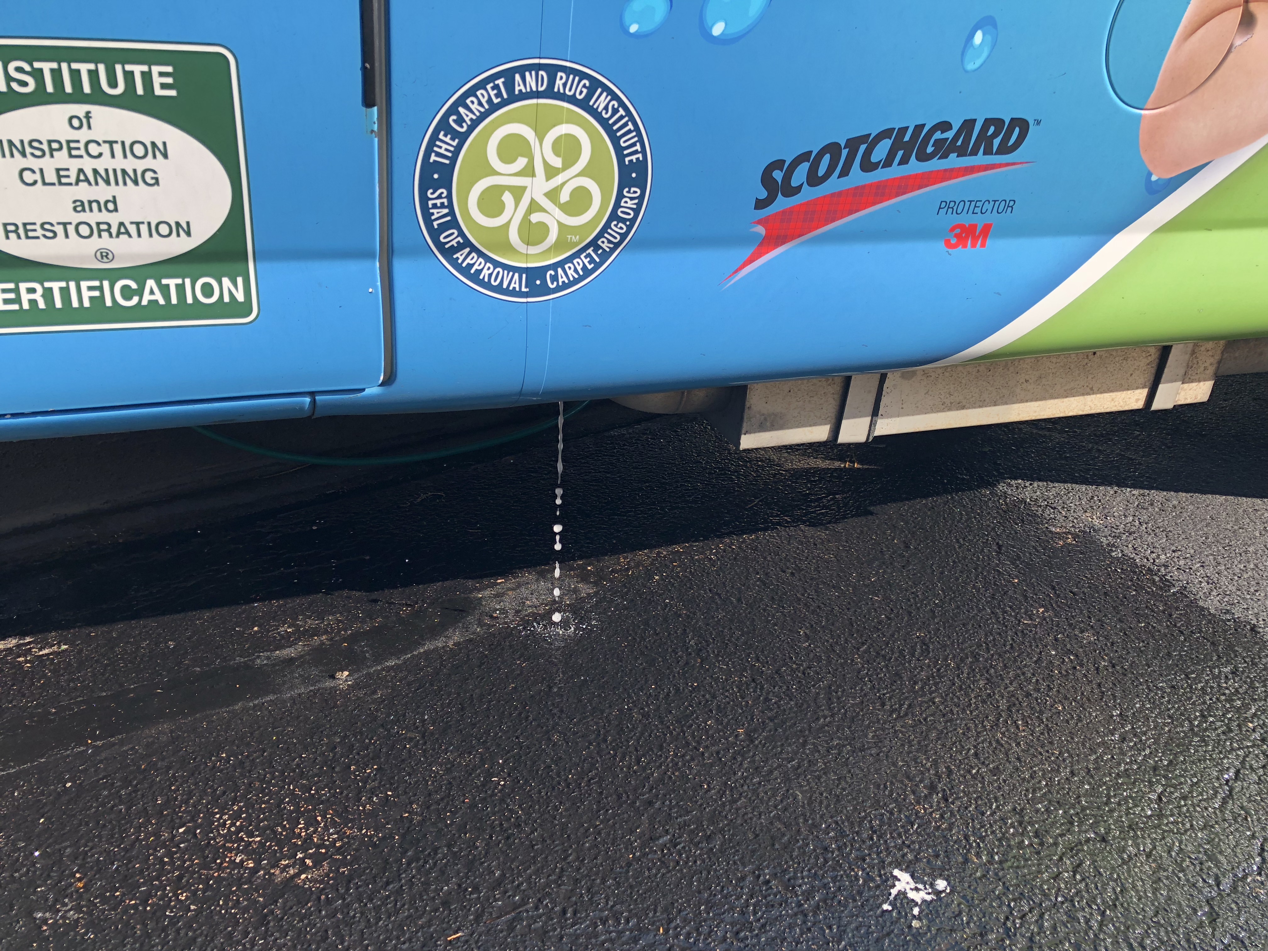

Does your Butler constantly put water out the overflow port. I had this unit since new and it always has done some but I not sure if it is slowly doing more and more or if it is just me. I am very tempted to reroute the water back into the fresh take.
The video is the unit running at about 500 psi.
If this is not normal what do I need to replace the pressure relief valve?
Thanks for your help.

It is probably the high pressure relief on the heat exchange. When it is leaking you should see soap flow on the chemical gauge without the trigger pulled on the wand. It is a wear part and failure can be cause by the condition of your water.

From the location of the leak, it looks like the pressure relief valve on the side of your heat exchanger is malfunctioning. I have replaced mine a couple of times, although it never poured water like that.
When I had a leak in my (max heat) lower heat exchanger water blew out through the blower exhaust.

You have to remove the pump and blower cover, slide your drivers seat as far up as it will go. Replacing the valve will take you 2 minuets, easy as it gets.

Take the hose exiting from the pressure relief valve off first. Unclamp.. Then unscrew the relief valve... Install the new valve, install hose again.
It should be that simple..
Or if prefer. Pull hose out of hole in floor and out of holder... Then can spin off relief valve and hose together
