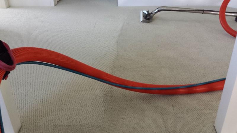

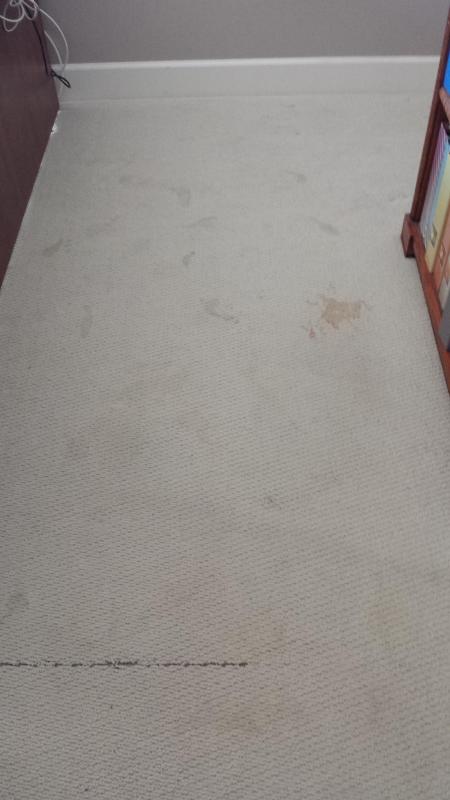

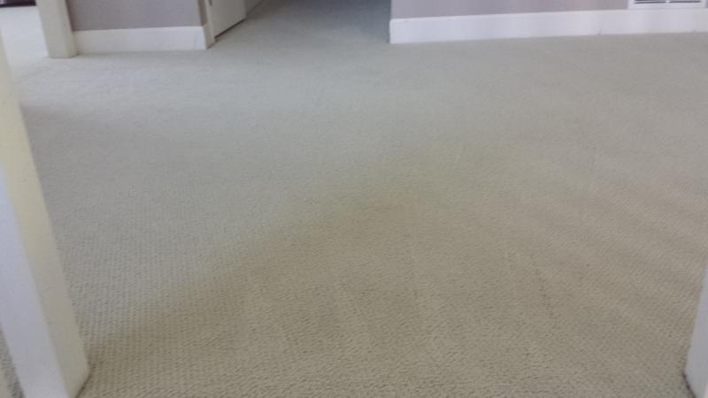

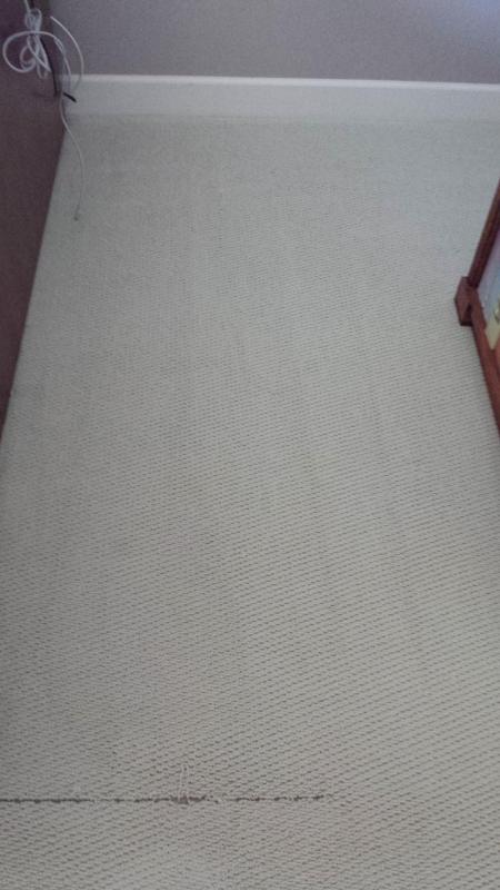

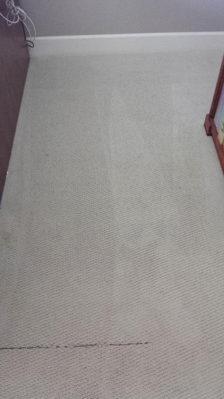

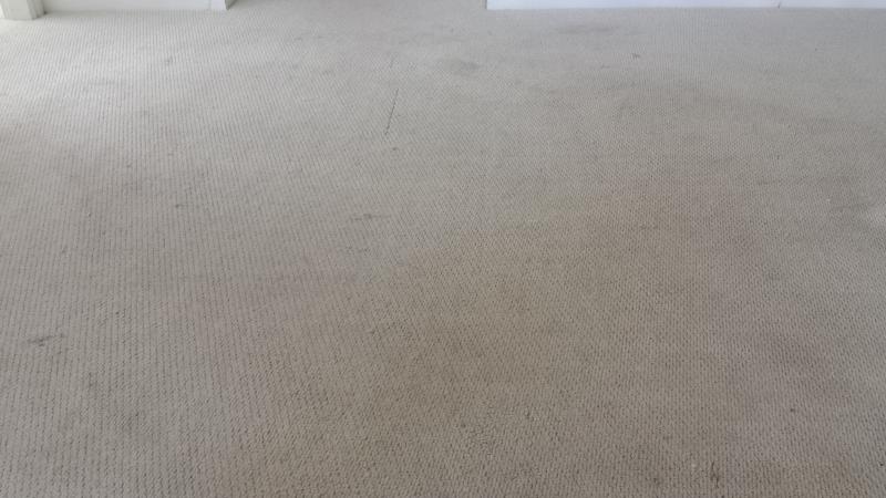

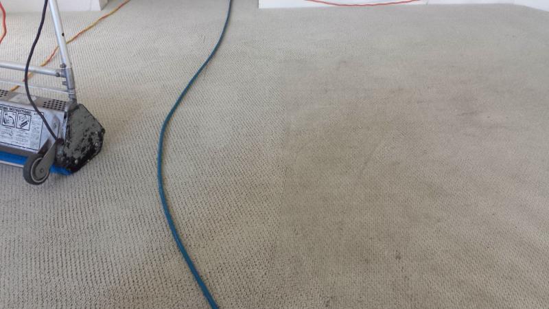

Back to this mix. I used today what I mentioned above, 4oz of Attack and 4 of S&G in a HF with no tip. Presprayed and scrubbed and rinsed with Esteem Ultra Release (customer vacuumed...yeah...I know :errf:). I'm just posting this because I got great results. Maybe it'll help someone, maybe it won't. But since the mix worked so well I'll probably try it again.
Before- cat vomit/hairballs. no urine, dog oils (English Mastiff-HUGE DOG!! Slobbers like crazy!)
Scrubbed
And rinsing
