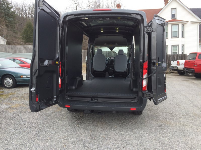

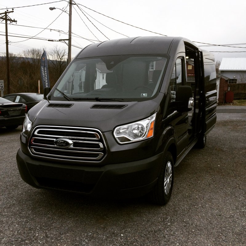

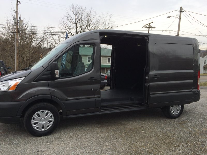

Picked her up this week, custom ordered with everything I thought I'd ever want and then some...

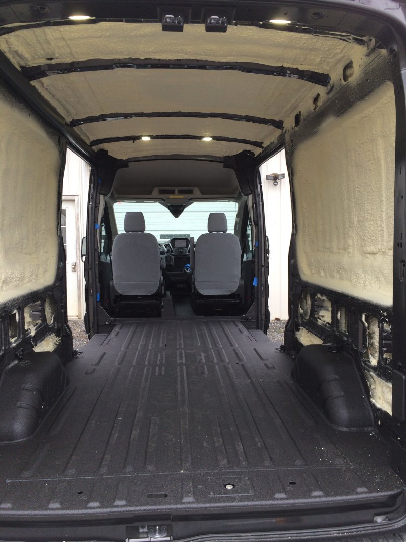

I would be worried about getting moisture trapped between the steel floor and the plywood. I had a ford van that happened like that. I had to reinforce the floor before I sold it. I am sure it wasn't "installed" correctly. I am just thinking that spraying the liner down over the plywood might not seal correctly at any joints and edges. Ideally, if you had the money, it would make sense to treat the floor, then treat the plywood as well.
Jun 22, 2016
206
Toronto
Kevin De Medeiros
It will be getting rhino lined or Linexed but I also knowthe floor of the van can get pretty cold when its -10 out. I'd rather take care of it now then wish I had down the road.
I had the floor of my van linexed and then put a VanRug down.it was the best thing I could have done. It's soft so when u go in its soft on the knees and cleans up with a steam cleaning. Also seems to aid in keeping t he van warmer Durning the colder months.
We normally put plywood and then coat it. A barrier between the the seats and coat 2 foot up the walls and out each door.
Never had one rust out but once they get over 100k I'm using them as trade in on something newer.
I suppose its possible but I would guess whatever little could find its way there is drying out. ???

My original plan was to pull the factory liner and Linex it and then put the liner back down but theres a padding underneath the liner that would hold moisture so i'm not sure I want that. I was thinking marine plywood and then Linex because I was afraid the plywood would also hold moisture. But i can see having an issue if I ever get moisture trapped under the plywood. I'm planning on getting 15 years out of this van so I want to make sure I do it right.
Shane T
Nov 7, 2006
1,663
Waukesha, WI
Shane Tiegs
I removed the OEM floor mat, had the floor and up the walls sprayed, laid down plywood, removed the insulation on the back of mat and reinstalled it. The mat cleans easily and keeps moisture off the plywood.
