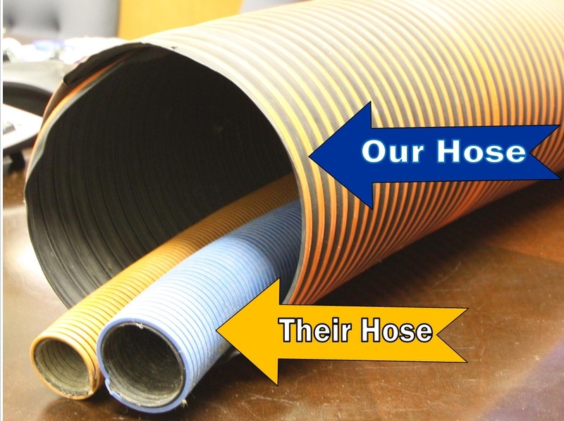

It does not do a thorough job, I can tell you that first hand.
Its like saying you can do a fine job of carpet cleaning with a Rug Doctor. Yes you can use it and it does clean but its not ideal.
Just not enough cfm to move the debris back to the collector and the hose diameter is a joke. :oldrolleyes:
The orange is 1.5 the blue is 2.0 but air duct hose is usually 8-10 inches in diameter.
If you must use a portable then look at units like abatement technologies or something with the power to pull the debris back to the collector.

I could do $99 duct cleaning jobs all day long with that thing, by myself. It was great until one day I got a bad one and filled the whole damn house up with dust... and that was using it with a TM, just can't imagine what could be accomplished with a portable.
I understand trying to get the most out of the equipment that you already own, but I think this is stretching it to the point you are taking risks not worth the savings of not using the proper equipment & tools.

Our vac source pulls around 6500 cfm with 13 inches of service pressure, there are vacs that go to 10k or above, like caddy vacs or Pringle trucks. Yesterday we used 75 feet of hose to tie into a system of 30 or so vents, around 100 feet of mains located in a crawlspace. There was an inch thick blanket of dust throughout the system. How would you be able to do this job with that tool? You can't.
You won't be able to fit a 1.5 inch hose down alot of the vents you come across, so you can't do those jobs either. Some vents are a tight fit for a 5/8 air line.
