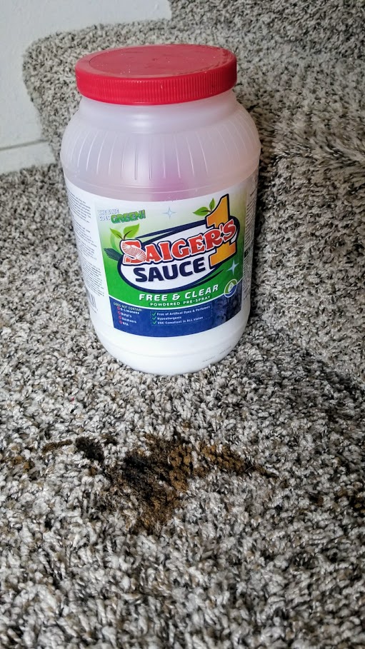

After years if not a decade of testing I hereby declare the best post spotter in the world to be...
9,767
Fels and 40.
Clean with what ever you got and when a stain remains give it a good soak with fresh undiluted liquid 40 and rub
Honestly, if that wonder combo does not take out what your nuke pre spray can't, just admit defeat and move on.
This lump of human doody sat for over a week while the gent was in the hospital.
I hit it with 40 first, no rinse, SS Green which got all the solids and turned it more yellow and sort of spread it out, then the 40/Fels got the rest completely out
Who ever says Fels does not rinse well must use an 02 -03 flow wand.
Never a discoloration issue or a resoil problem if used with common sense.
Thanks for sharing#humandoody
