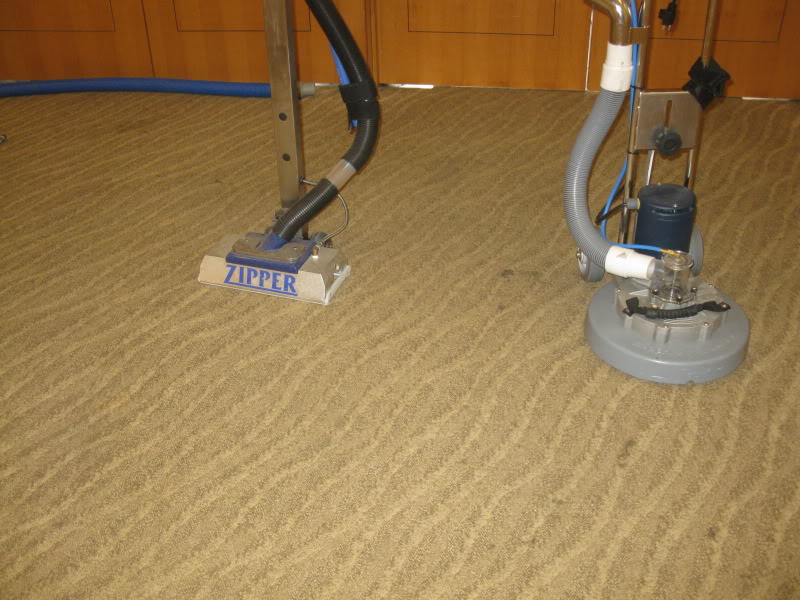

I used the Zipper and it was about 40% faster.
The HOSS did picked the pile up better and my
helper did not break a sweat after 2 hrs. But
the Zipper did a better job extracting water, the
carpet felt dry to the touch. I could extract more
water with the Zipper after two dry passes with
the HOSS.
After drying customer could not tell a difference.
Luis

The Zipper does not work on small areas with furniture, I have used it on empties but a wand
is also needed. But the same applies for the HOSS. Out of the two the HOSS would be my
preference in small areas.

Zipper: full stroke with water and full dry stroke
HOSS: full stroke with water and full dry stroke
2 hoses off the C-4 2600 RPM's
Zipper 100ft 21/2" 50ft 2"
HOSS 100ft 2"
prespray Zipper side with hydorforce, HOSS side w/ penguin

Zipper in my opinion. You need to get use to the motion it is not a wand but you need a helper regardless of tool.

Sight tube? the only sight tube I have is in the Zipper, the HOSS does not have one.
To be fair, my helper with only 4 yrs carpet cleaning experience was using the HOSS (he is a VCT guy with 10 yrs exp.) so maybe he did not know what he was doing. If you think
I am way off I will send off my Zipper to MF in the mail so you can do a one on one comparison. But you pay for UPS to bring it back and are responsible if I do not get it back.
