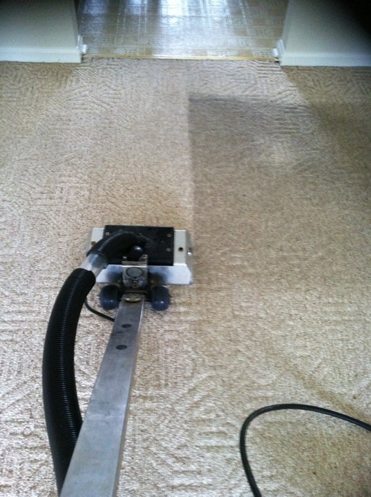

Today's cleaning job on an empty with that sculpted Berber.

On sculptured looped carpets, the 2 hole glides will run the smoothest. You can add the weight for better dry times. You won't feel the extra weight using the two hole glides. As the slot glides begin to wear, you won't get as much chatter on certain carpets.
This is a non-sculptured berber carpet, using a slot glide in the front port.

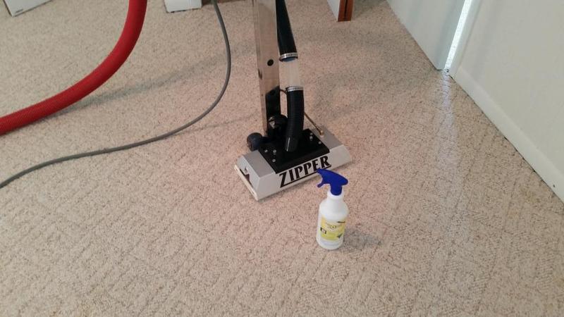

I have cleaned quite of a bit of sculped Berber with them... This photo is from years ago, before I had a big truck, It cleaned up great with one pass and was dry a few hours after we left.
