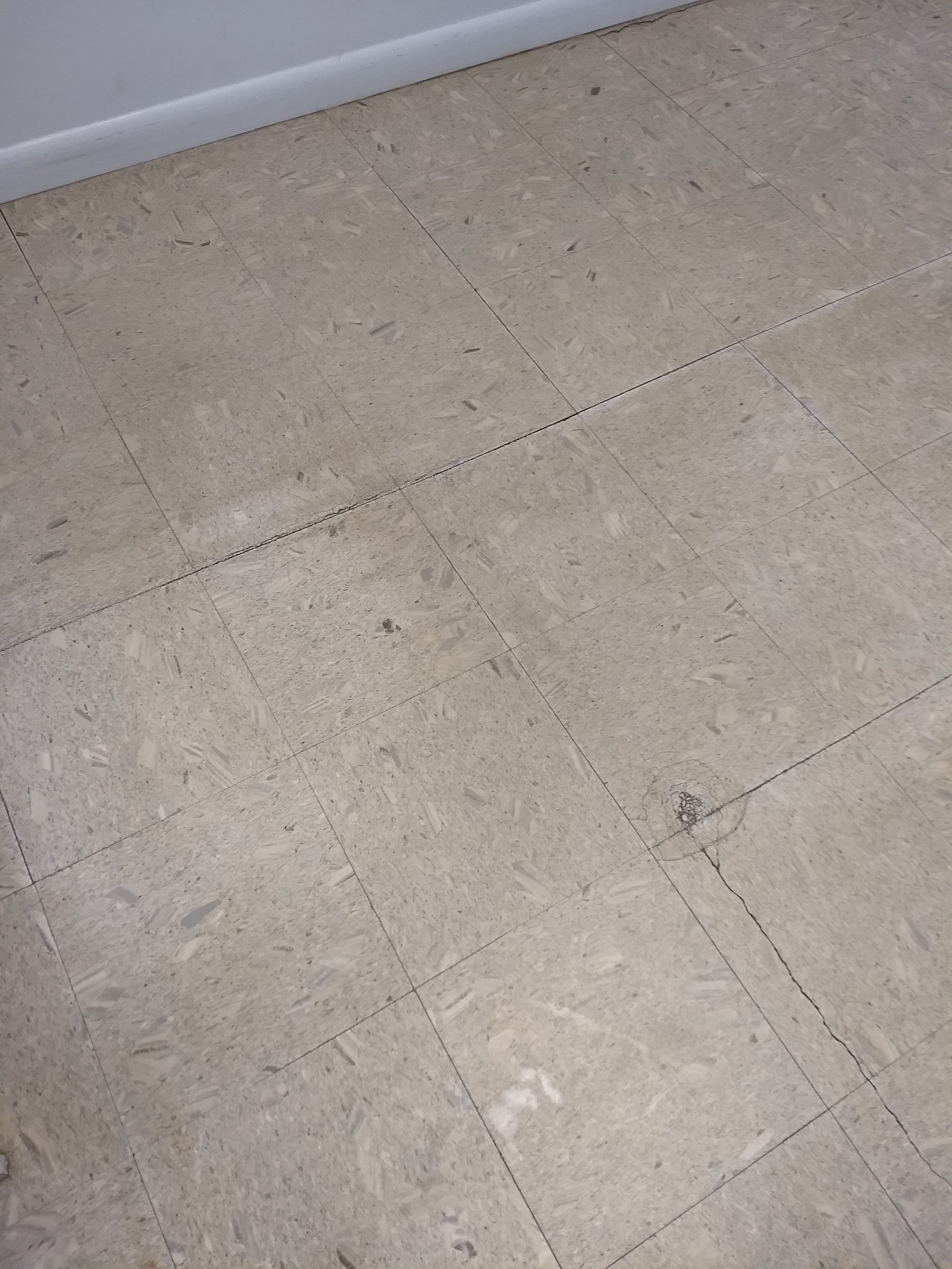

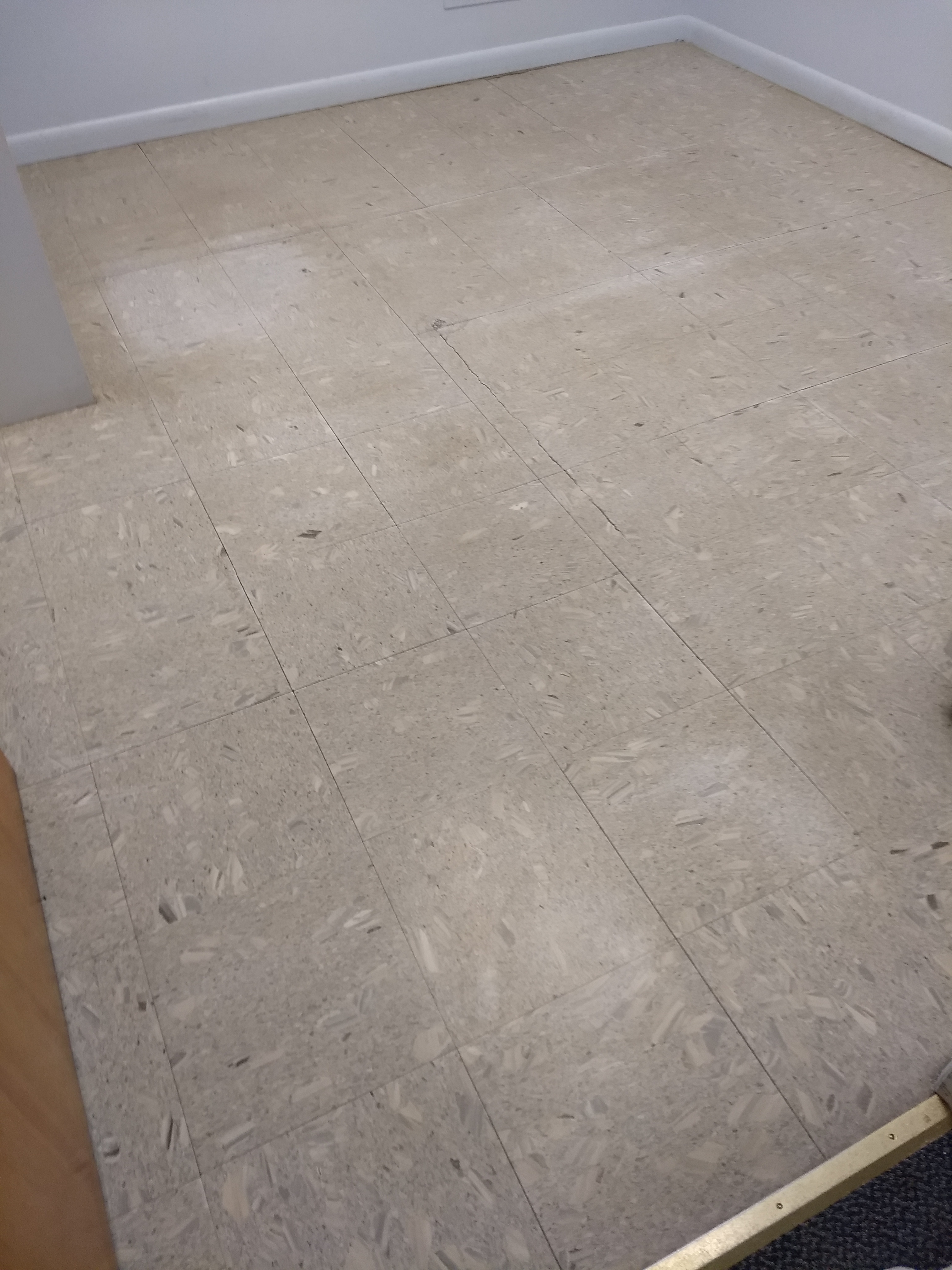

The first time in 25 yrs a vct floor kicked my ass. Stripper and a new black pad would not touch the finish on the tiles. Even tried undiluted stripper, with no difference. Sledgehammer plus was the stripper which I use all the time. Any ideas of what was put down.

White spots are were the finish has wore off. Pics are after I tried to strip.

I’m no guru, but in your place I’d try a brown abrasive pad and water, to wet sand whatever that is off. However, you are unlikely to get a perfectly even shade with an old, weathered and beaten surface. I suppose you could run a hand grinder over it with a piece of the brown abrasive pad, to get in the scoops and hollows, but wow, the work!
On the bright side, once refinished a lot of that variation seems to vanish.
Good luck.

I can’t tell from the pictures but if that is 1 x 1 tile, those tiles are asbestos. If that is the case you can never dry strip that. In those cases there is just a huge accumulation of built up finish so you can put a shine on it but not much else.

What ever the finish is, will not respond to stripping.
9x9 is suspect for acm but not always. 1x1' less so but...test test test.

It actually looks like wear pattern. I wouldn’t grind on it anymore. It is what it is. Clique. At most, do one coat of sealer, #oldschool, then finish. You can too polish a turd, it just won’t look fresh as a daisy again.
