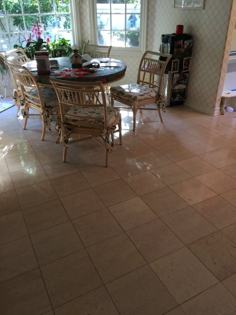

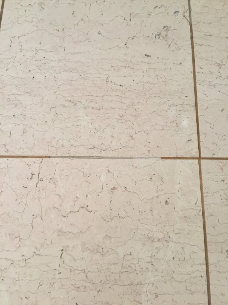

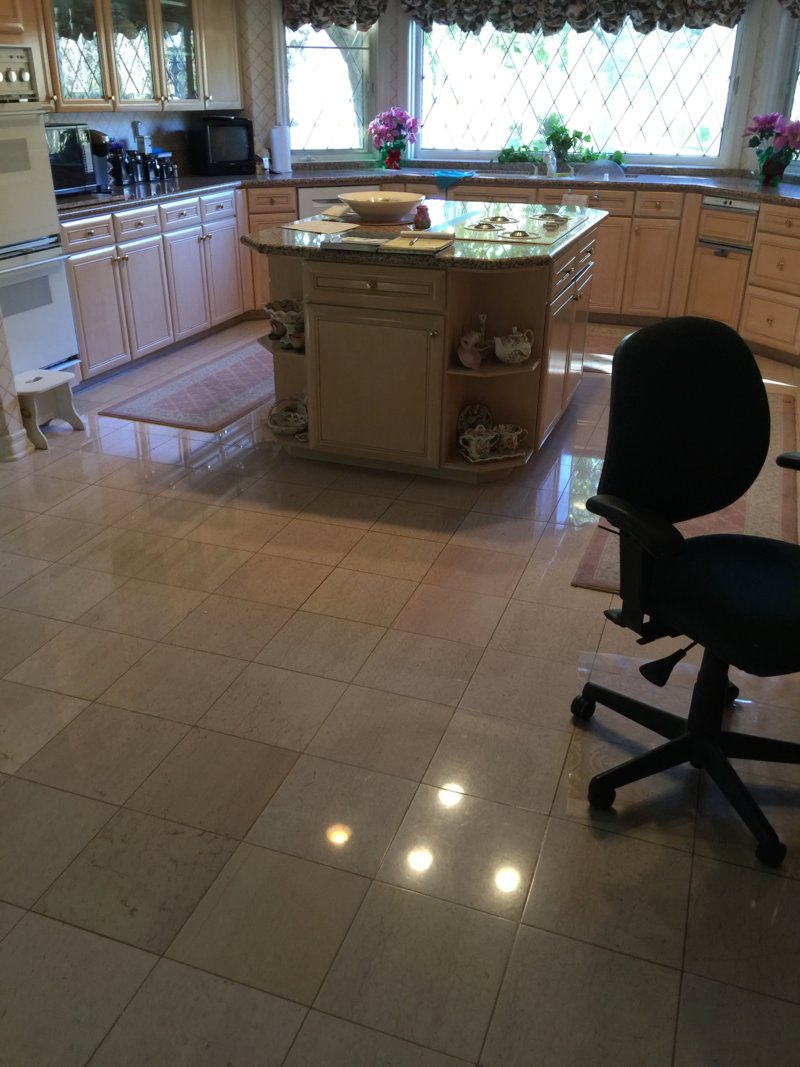

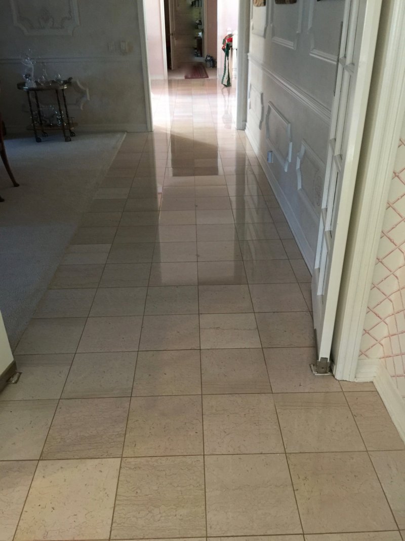

Was supposed to be easy 1000 sqft of re polish until I noticed the wax, good thing I haven't given an estimate yet..stripper recommendations?

Worse case you can razor entire floor and remove and regrout
BTW...that is an improper install, that's why grout is failing..
Butt install micro bevel
Plan on remove and regrout if she is wanting perfect grout.. Easy..

If it's VCT finish/wax the ACE Hardware brand or Zep will take it off but after looking on a larger screen just now, yeah that lippage is going to ruin your day.

Homeowners are in their 80's, the floor has a few etch marks in the kitchen & they just want it "shiny again", they aren't aware of the improper install or lippage, the yellowed wax in the grout lines doesn't even bother them :frown:.

I still question if there is still a topical...because topical a dont etch.
It's hard to tell from your pics..
The grout lines are not shinny...could be a bad angle
And if topical was applied, most of it probably would be worn off in hi traffic lanes. (Why it etched in traffic lanes?) depending on teaffic and care
Did you test it?
I guess he dosnt care about the grout?

Floor is 25 years old so over the years spills in front of the fridge, sink & oven resulted in about 50 small etch spots, that they have now covered with rugs, there is one large etch spot in the middle of the room.
Wife said wax was applied about 5 years ago, I am guessing more like 8-10, I was able to scrape the wax out of the grout, kind of flakes off.
There wasn't a pantry or closet where I can test an area unfortunately
Husbands instructions to me was, wife is the boss of the house...do whatever she wants & make her happy.

Its been 5 days & I still haven't typed up an estimate, best solution for the homeowner & my conscience is for me to use MB-11 etch remover on a few of the larger spots & then just Money Pad the Kitchen & breakfast room & skip the hallways & large entry, I know all the negatives with Monkey Pads & we rarely use them but in this case the low cost, easy of use & hopefully minimum picture framing might be my only option. Homeowner will be very happy compared to spending $10k.

Doug, when one tile is set higher than its neighbor, there is a ledge, or "lippage."
If those edges are not leveled by heavy honing, the polishing discs have to jump the gap formed by the lippage and leave an unfinished zone right there below the lip. That unfinished bit looks like a partial 'frame' on the lower tile, hence the name.
