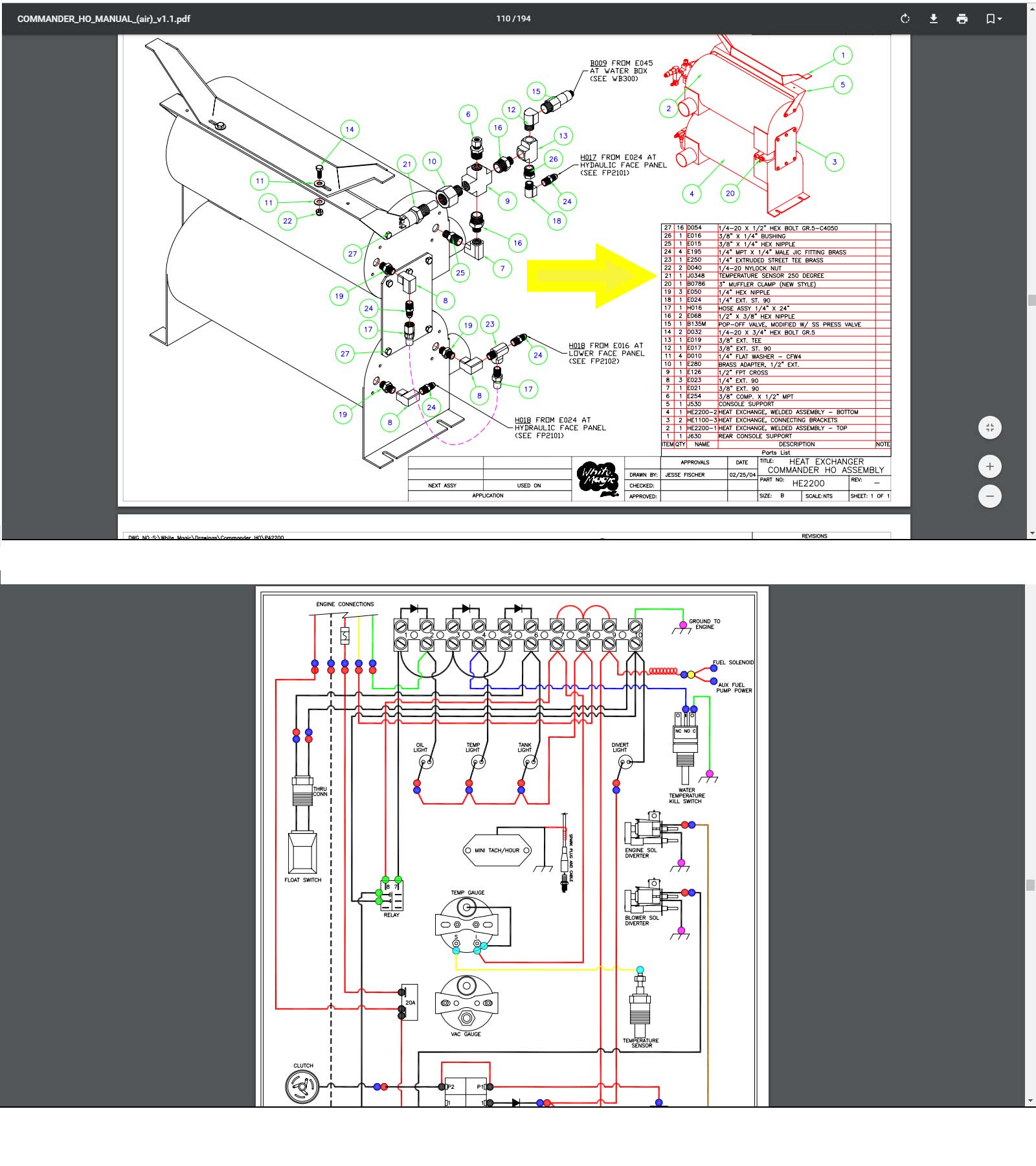

My system temperature light is on. On my white magic commander air cooled. It comes on immediately. Maybe a bad sensor? Any advice would be helpful.

Probably if it comes on immediately
looks to be connected to a kill switch if I'm looking at the manual correctly so I would expect a shutdown if there was an issue
I think this is the switch
https://mikeysboard.com/resources/white-magic-commander-h-o-air-cooled.31/
I can only find that part # [J0348] at steambrite...they also have an alternate listed that can be found at most other suppliers
edit: Also here
https://www.cleanservinc.com/parts/electrical-system/switch-temp-285f-j0348.html

Fred thank you for all the info. That is the exact switch I'm looking for. But the weird thing is the system does not shut down. It still runs with the system temperature light on but when I unplug that switch, the light goes off. Idk what else to check. I might just have to change it to see if that is the problem but I don't want to waste any unnecessary money.

If you have an ohmmeter you put it on the terminals and it should read open. Anything else and its bad.
You could also pull the switch and use the ohmmeter and a heat gun to make sure it "closes" properly.

ok. there are three terminals on the switch but only 2 of them are used. I should check the two terminals that are being used correct? and if I am checking if it closes properly it will read open on the ohmmeter until it reaches 285degrees then it will show resistance?

Correct
The NC terminal (normally closed) is not used
