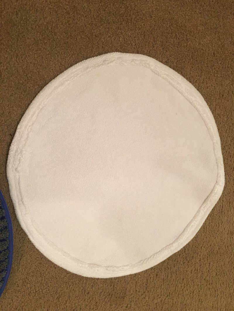

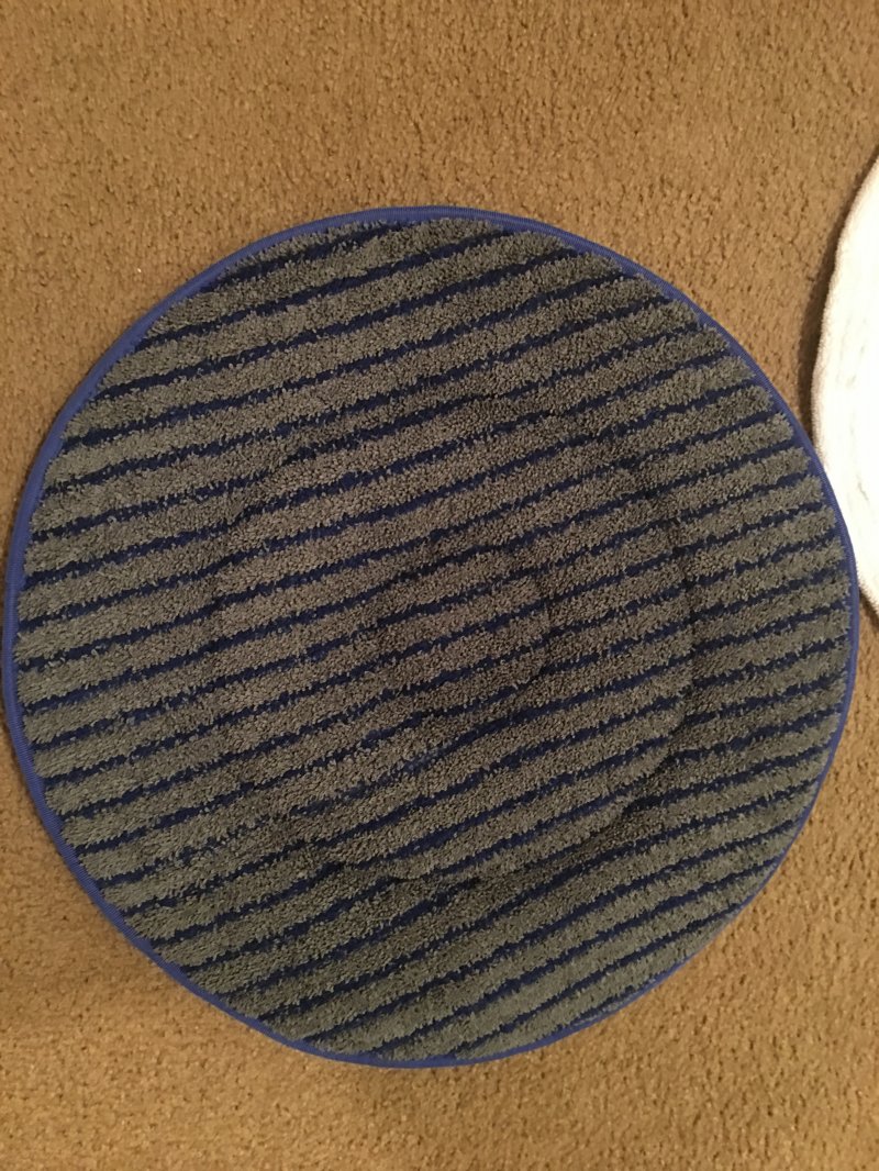

I have a bunch of Superzorb diapers but I also have a MicroBeast Pro Scrub bonnet. Can I use the microbeast just like the superzorbs? Is the microfiber better?

Mike. Your answer is the exact opposite of what I expected. The microfiber pad is really thick and it also has course dark blue lines in it. I would have thought that it would be the better one for filthy floors and would also be more absorbent than the terry cloth pads.

Damon the micofiber works excellent to agitate, loosen and suspend to be picked up with the combo pads. They are more absorbent and will then remove more in heavier soiled carpets.
Not that we won't use microfiber by themselves. We do, but in light soil situations.
1. Vacuum throughly
2. Precondition and agitate
3. Rinse cycle with wet/pads slightly wringed out
4. Finish when need with cotton blend or cotton pads.
Never dry pads, always wet for rinsing and lubrication

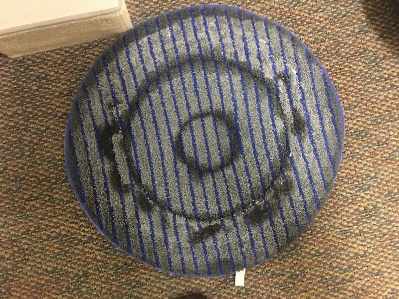

You must not have kept it wet or flipped it. Try flipping it every 300 feet, then switch to a new pad.
No I didn't flip it. I did wet it then post bonneted with the superzorbs. The carpet came out beautiful. Wish I could say the same for my microbeast pad.
