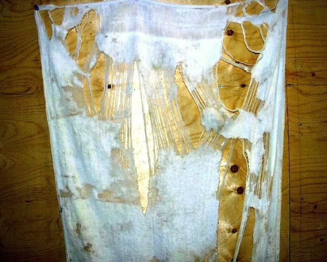

Preventing disintegration of fabric. Here is a shot of a cotton towel loaded with Peroxide that I used to warn my Techs about the dangers of using ANY Peroxide on ANY fabrics.
