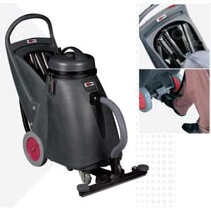

For small VCT this is the one we use now http://www.usviper.com/assets/fulllit/25.pdf
LOL, those hd ones last about 10 jobs.
The proteam one is probably best but $$ too.

We have one of those nobles too but the squeegee mount was not very durable.
We can be a little rough sometimes on equipment :oldrolleyes:
Worked good and would be fine i'm sure. The viper is sturdier but heavier also.
The back has that deep pocket to keep stuff, rags,razors, etc too.
Cleaning Professional
We have had multiple of both units and for us the nobles/tenants have far outlasted the viper counterparts. The vipers are also 50% heavier so it just kills a guy when they work by themselves.
Nobles is something like 40 something pounds and the viper is like 60 something pounds and this make a difference after stripping and waxing a floors all day.

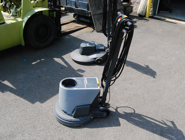

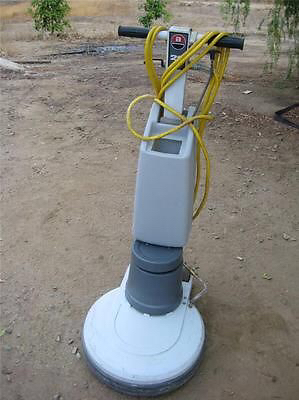

Find a used nilfisk advance matador 20 inch machine with water tank above motor and be done with it.
While adding a tank to your 175 y attaching it to the shaft is good, it also adds weight onto the control surface of the machine and now you will have to counter that weight the whole time until the tank runs dry.
By getting a machine that the water is centered over the pad adds no "work" or extra strain to normal operation while providing a bit more weight for optimal floor scrubbing capability and overall effectiveness.
While both machines posted above are basically the same spec wise( gallons the hold In tank, hp, revs, size of pad) the operation of the one that has the tank centered over the pad will be much easier to use equating to much less fatigue at the end of stripping process when I need them to be aware and paying attention to detail as they start applying the finish.
