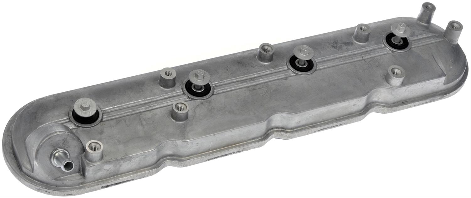

I remember reading you flying off the handles regarding spark plug's for the PC Everest 650..
The valve cover is a bit over priced fwiw..
I'm just being a jackass and glad you're back up and running sMatty boy!

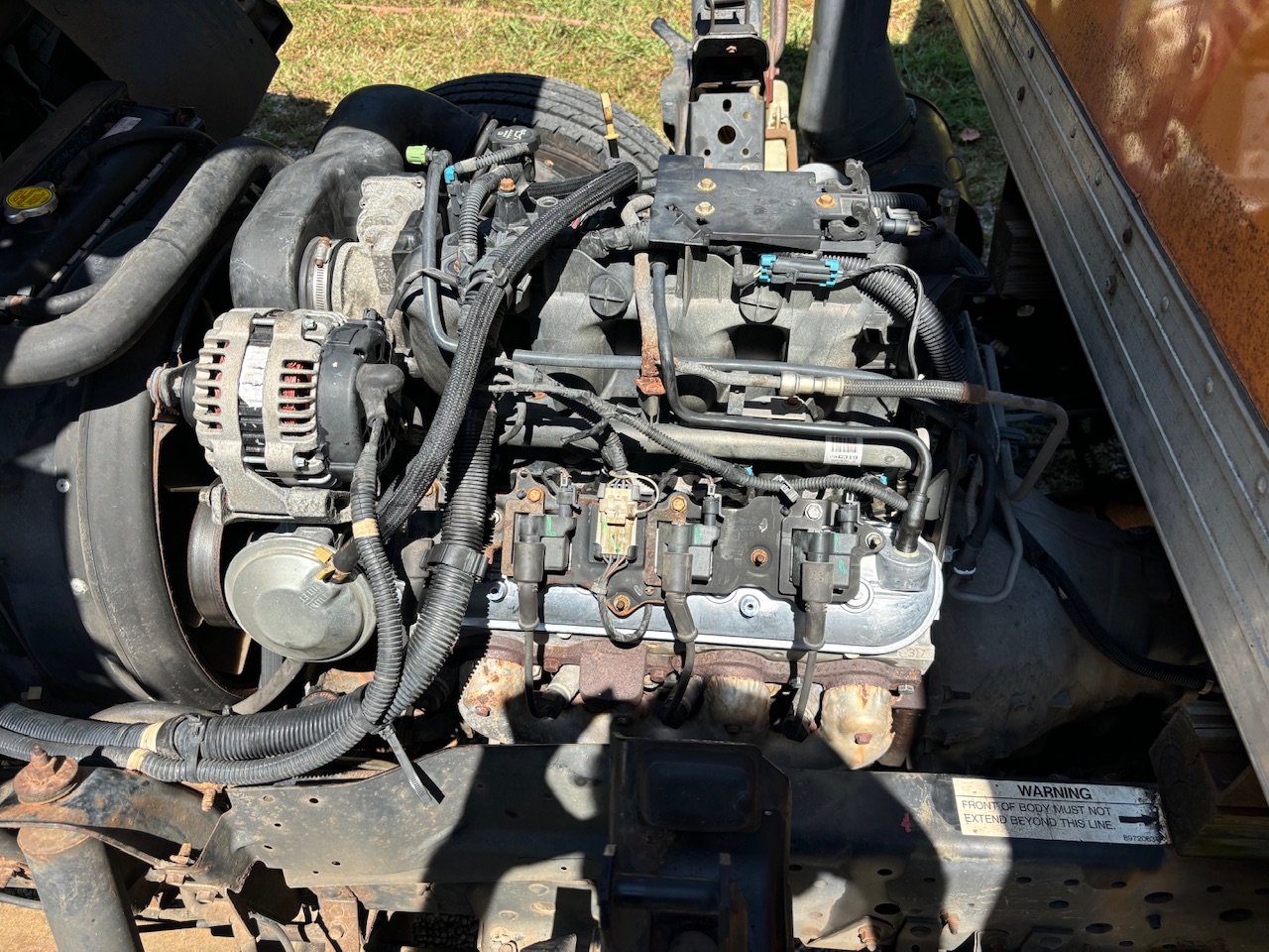

I just picked up a cds with that motor. It's running ruff, only 67,000 miles. Is there a way to check each ignition coil after plugs and wires if it still runs rough?
Also the serpentine belt broke today. Does anyone know the proper drive belt for the cds with the 6.0?

I think the only way to check the coils is when they’re hot. I doubt they’re bad at only 67k miles.
When you said “running rough”, what specific symptoms are you referring to?

I can feel a miss, and the computer code says misfire. I guess I could unplug each one at a time and see if the rpm's drop. probably original plugs and wires

I'd OBDII scan it first, then swap whichever coilpack with another to see if it jumped from the original.. If so, then you know which is bad.. But since it's new to you, I'd do at least spark plugs, so you know they're good..
As for the serpentine belt, the GM LS 4.8L, 5.3L, and 6.0L engines are the same, just different displacement size.. This is what pulled up for a quick google search..

700 hours on the meter. I'll try the ignition swap if plugs and wires don't fix it. I have the tensioner pulley all the way over and I still cant get the belt on with the k061145
