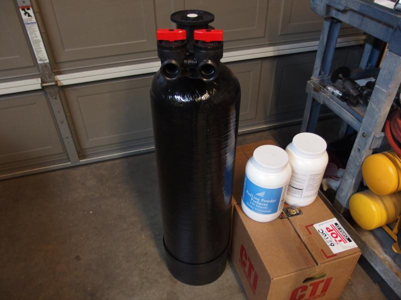

that black one looks like the abc equipment water softner not a kinetico. and i think the manual says not to store salt in it over night. adding salt everyday semms like a pain.
here is a website with lot of info......http://www.qualitywatertreatment.com/water_softeners.htm
id rather have one with a salt tank. there are lots on ebay just search for fleck.
hes said it was Kenetico black...not a kenetico softener..
you add your salt and recharge approx..every 50 hours....

You only add salt when you need to clean the resin from the build up of minerals. Then flush it out and go again. How often depends on your water hardness and volumne used.
