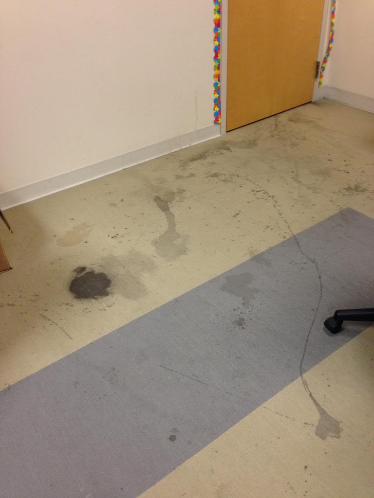

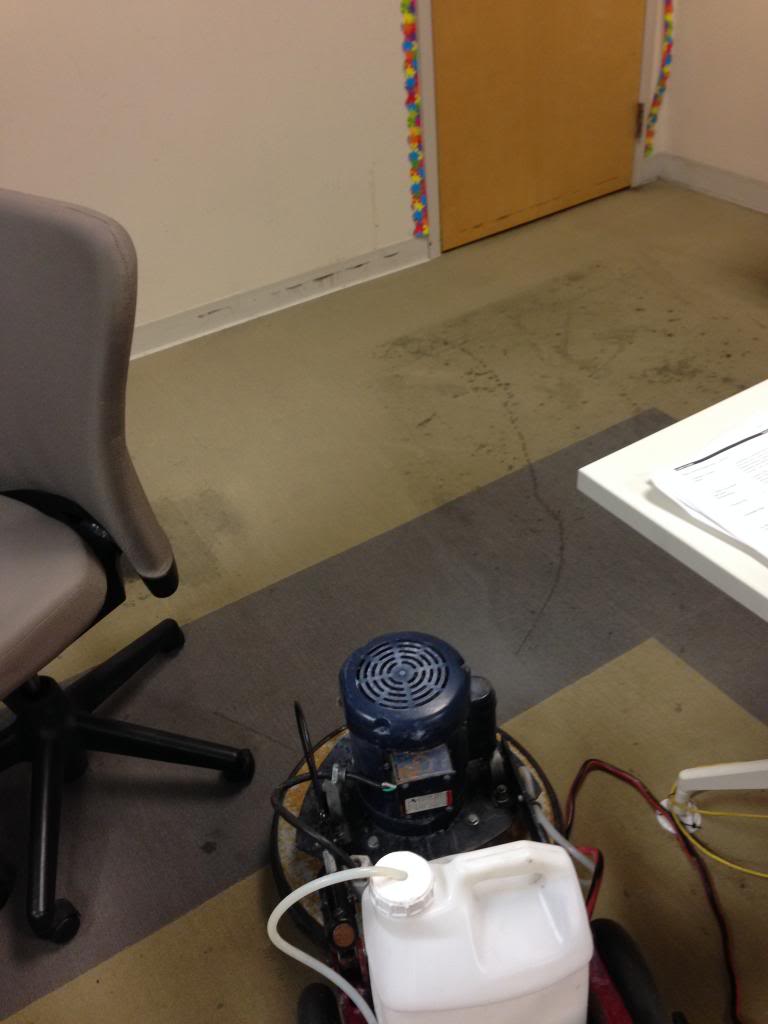

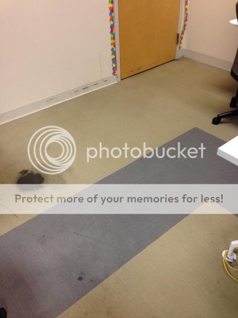

As ive said before, I own both a Trinity and a Vortex. I would NOT run my business solely on VLM or HWE...
I have NO ulterior motive, I simply go on the things I can SEE, real results.
Here are two examples,
1st, Photos of our Trinity cleaning Carpet squares we have NEVER been able to get clean with HWE. We can go over and over it until the water runs clear, nothing makes this stuff look better... Except Orbital Cleaning, Our Trinity out-performing our Orbots by about 10% faster cleaning speed, our Cimex's yeild the same results as well on these same carpet squares, but tend to have more wicking issues.
2nd photo is a heavily soiled area we clean weekly, mostly with the trinity as it yeilds great looking results and has almost zero wicking,
BUT due to all the back & forth on what removes more soil, I decided to do a real world test, Clean the entire thing with the Trinity, Pre-Vac with a super powered pile lifter, and follow with our fire breathing TM with a Zipper to see if we extract any soil, or if the sight tube would be clear:
(The right side is after being cleaned with HWE)
The sight tube not only looked like thick chocolate milk was coming out, our in-line filter was so full of grit and soil it must have weighed 10 pounds. This is with using both sides of 15 Microfiber pads, and 5 Gladiator pads afterwards to make sure it dried quickly. And our Pile lifter vacuum bag nearly full.
The carpet also was dry within 20 minutes after one additional dry stroke with the zipper, whereas we waited 45 minutes for it to dry after VLM cleaning.
The way I see it, VLM cleaning; especially with a superior tool like the Trinity will yield incredible visual results, But to truly remove the incredible amounts of soil I run in to, you need not only high flow/heat and insane vacuum, but good chemistry.
