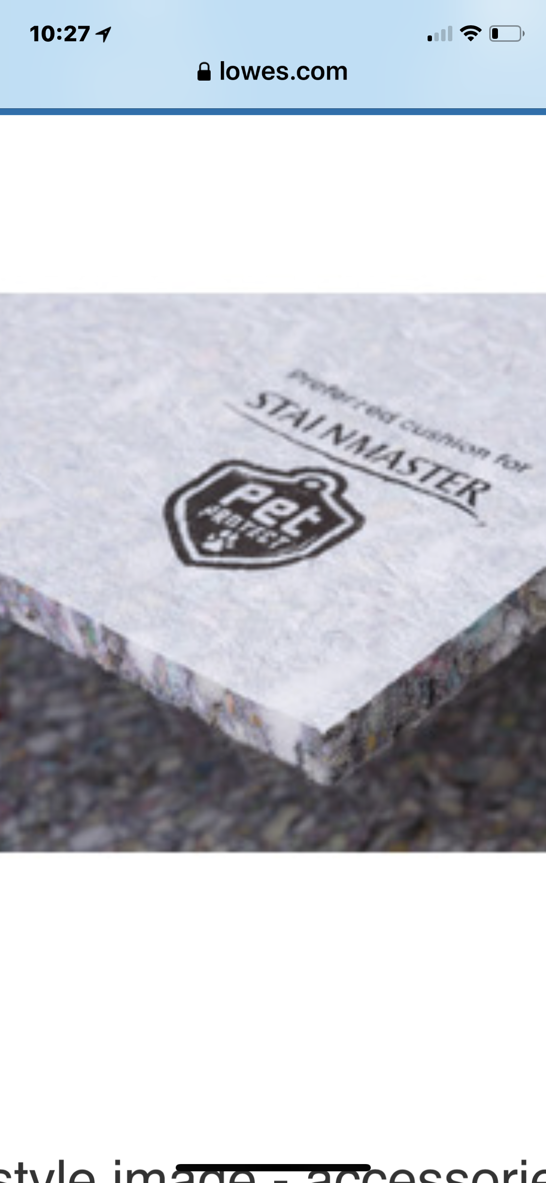

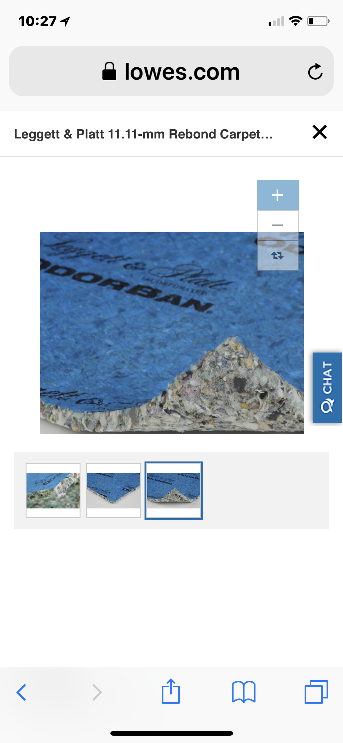

It’s Barrier keeping urine from going into
Pad and subfloor
Cleaning Professional
7,040
I bet that pet pad wont stop urine around the edges near tack strip, where males are likely to urinate.
if its stapled to the subfloor and seams aren't taped, it wont help much in the rest of the pad as well.

The Pet pad a lot of times just seems to allow the urine and any spills spread out more.... through out the carpet backing and such.
Seams are duct taped... Not always perfect.
