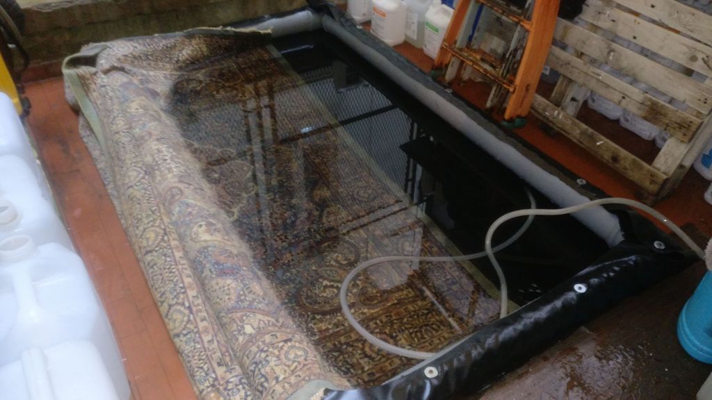

Work in Progress.................

At this moment I have soaked the carpet with acid water. How long do I leave him soaked?
After the soaking, what am I going to do?
Thanks!!!
