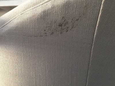

A big problem that they do have is “delivery damage”.
Even the most careful delivery personnel can rub the furniture against the doorway of their truck or the home, and when that happens, soiling will be present, much like you'll see in this picture:
"This is a common problem that furniture retailers and movers experience"
This may look like a simple spot to remove, but unlike carpet, removing spots from upholstery can be very challenging, even risky!
What problems could a cleaner face when asked to remove this spot?

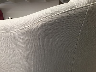

If this is a claim for a new item, perfection will be expected. Apply, blot, rinse, and dry until the spot has disappeared.
"This is how your work should look when you are done"
