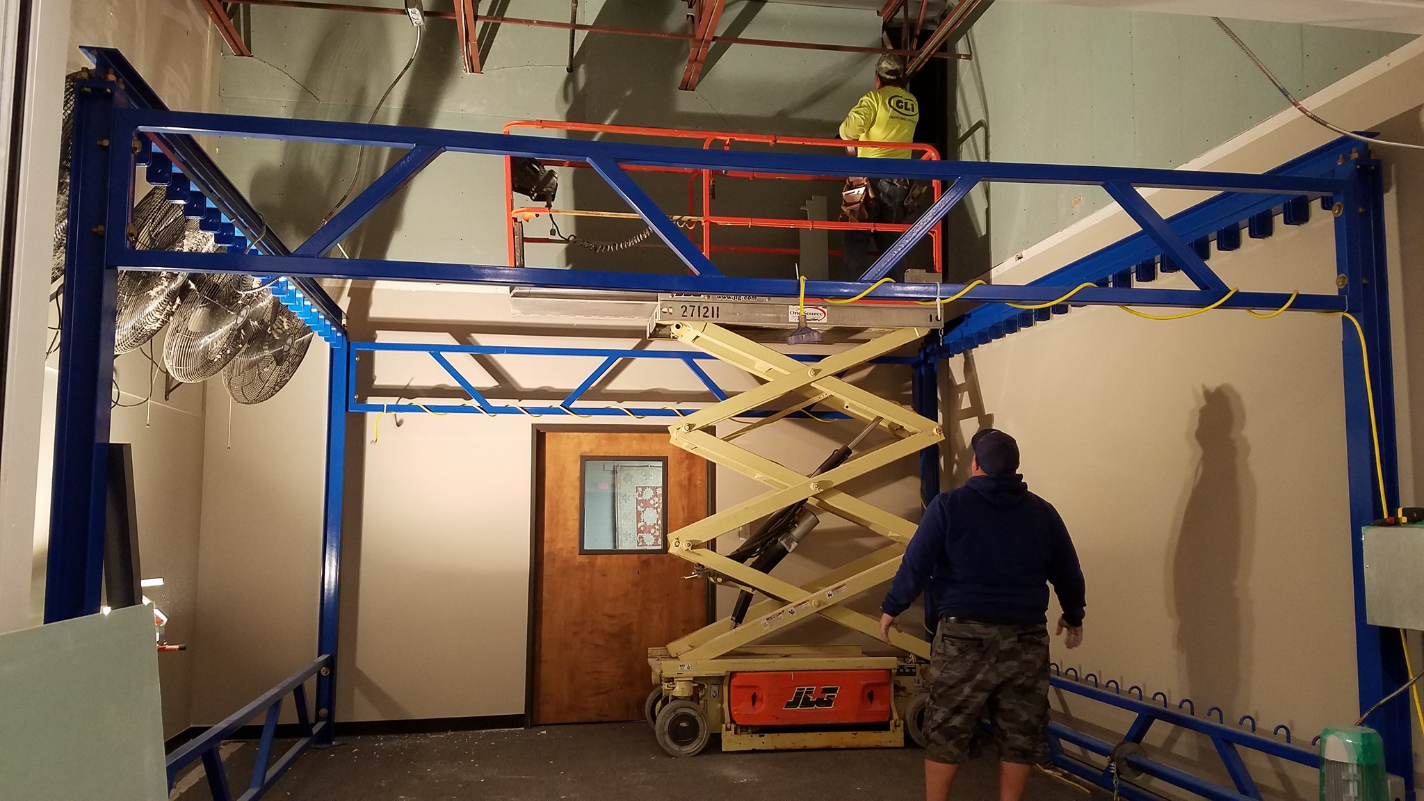

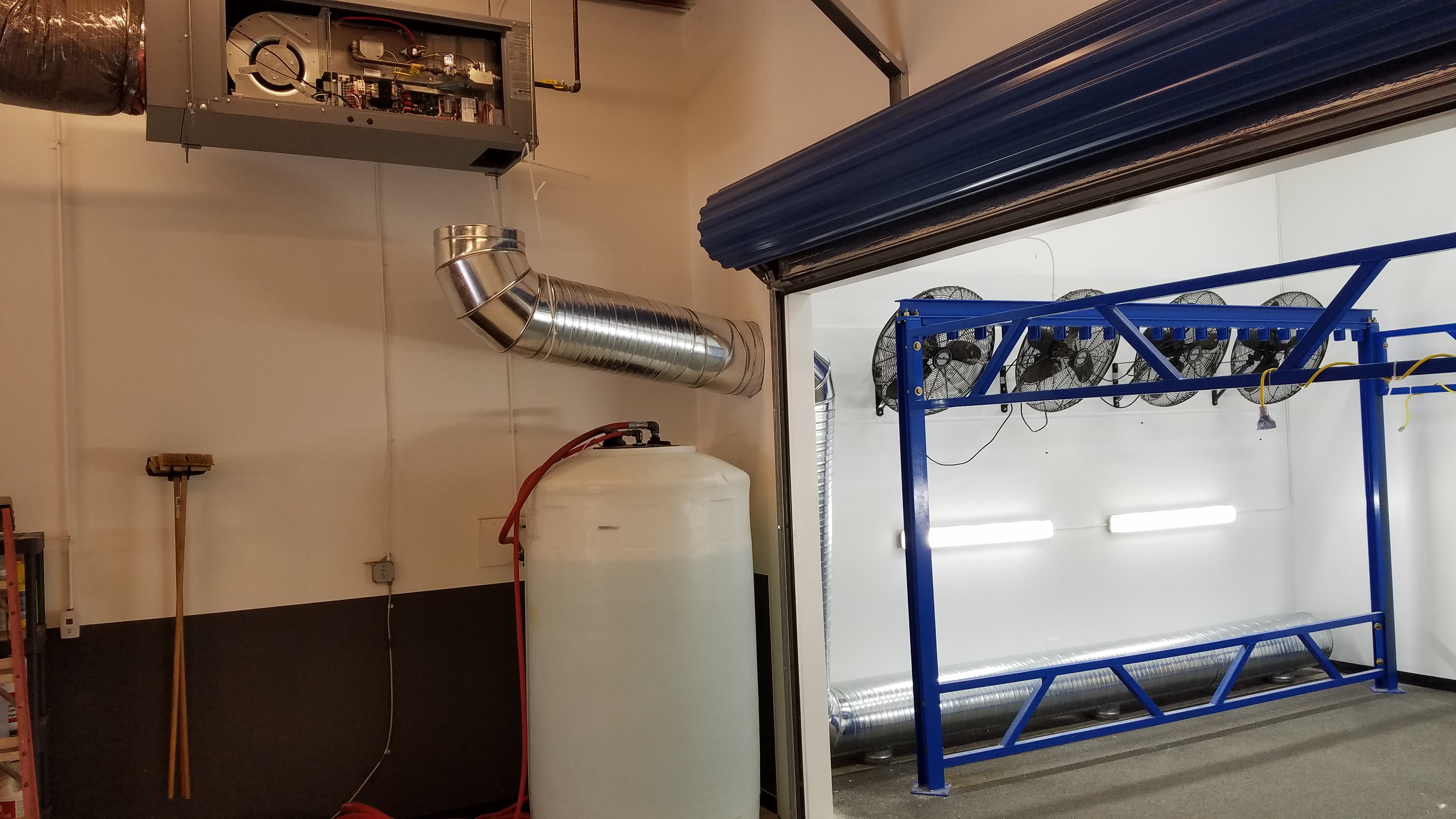

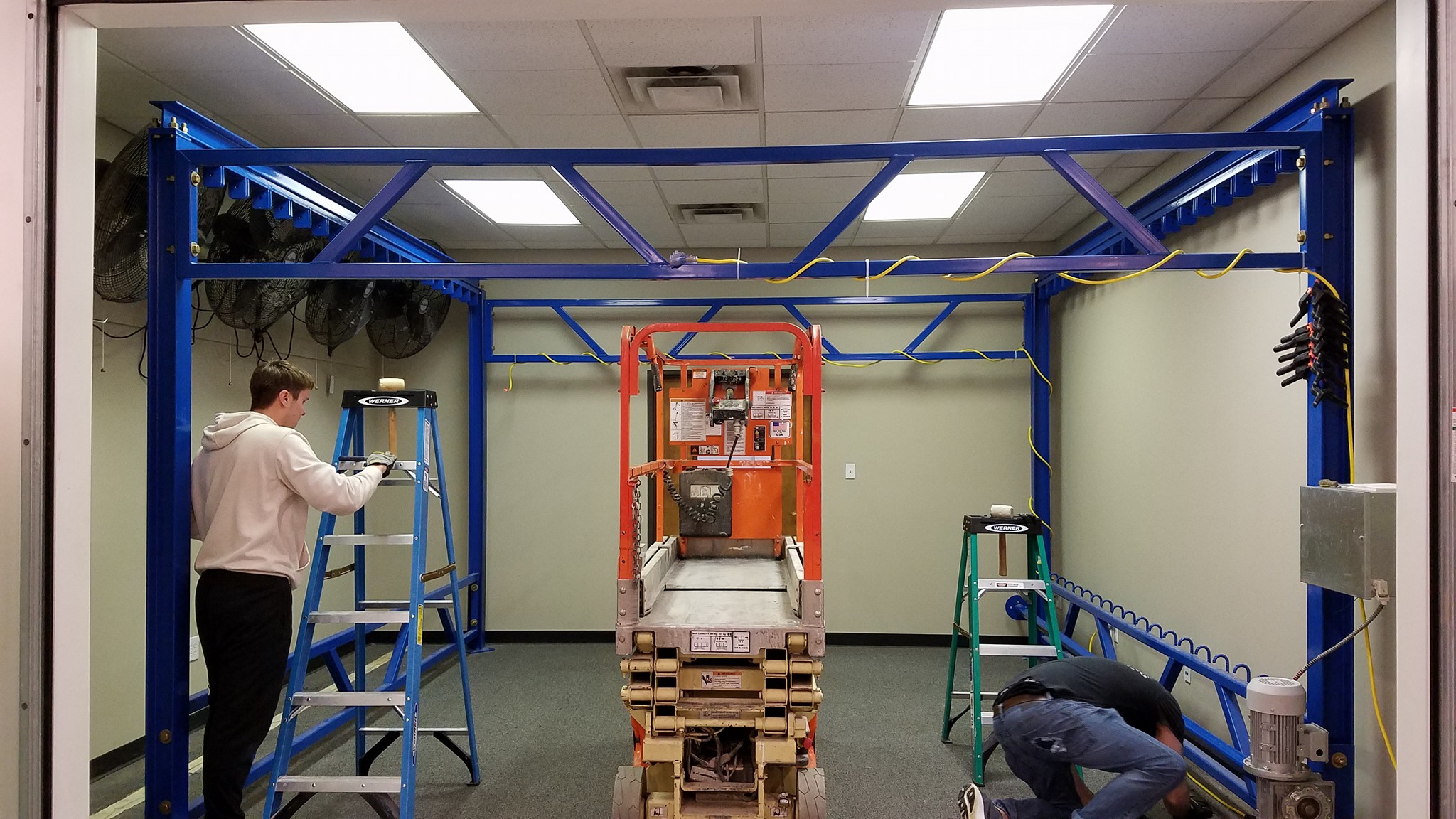

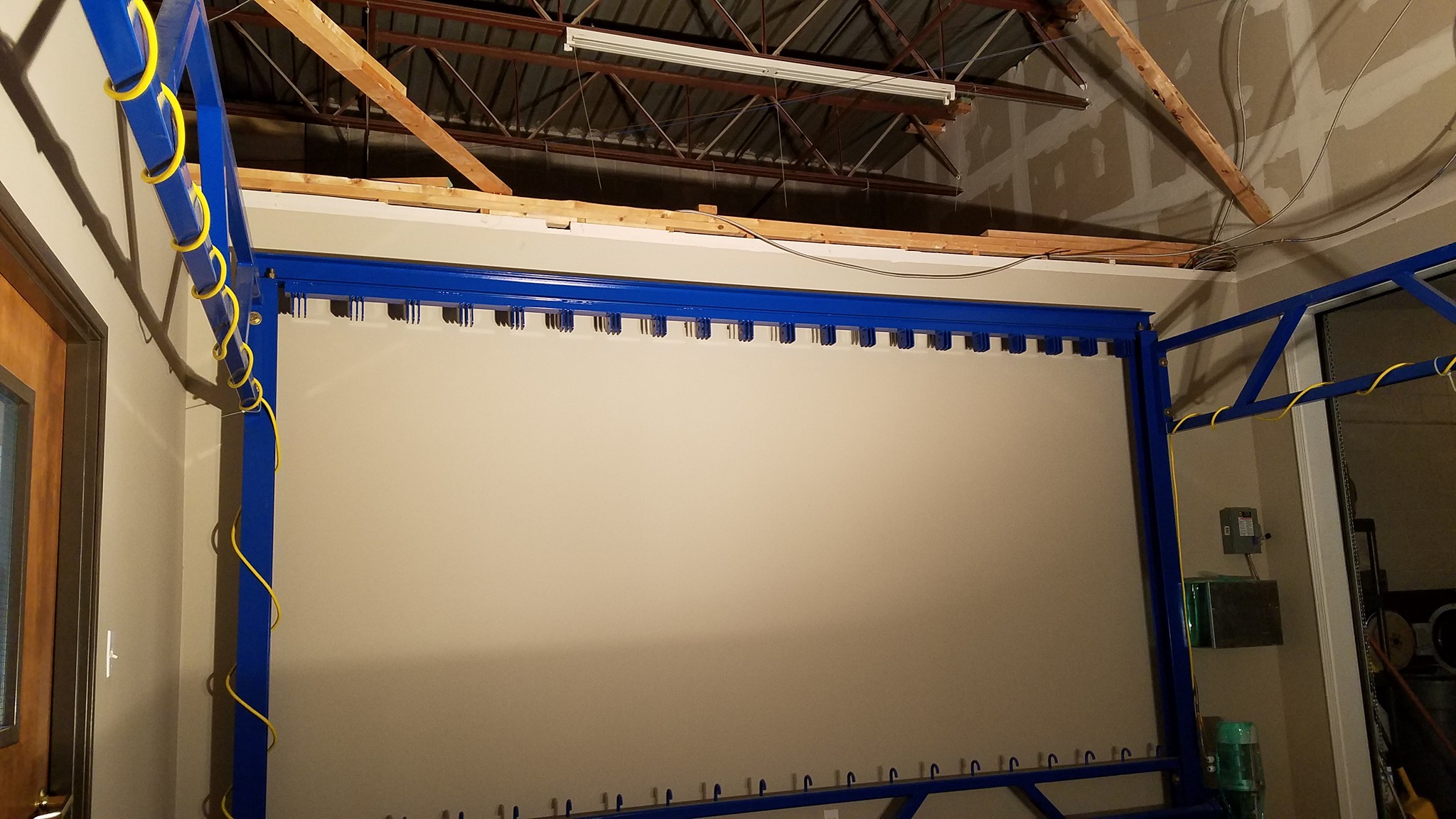

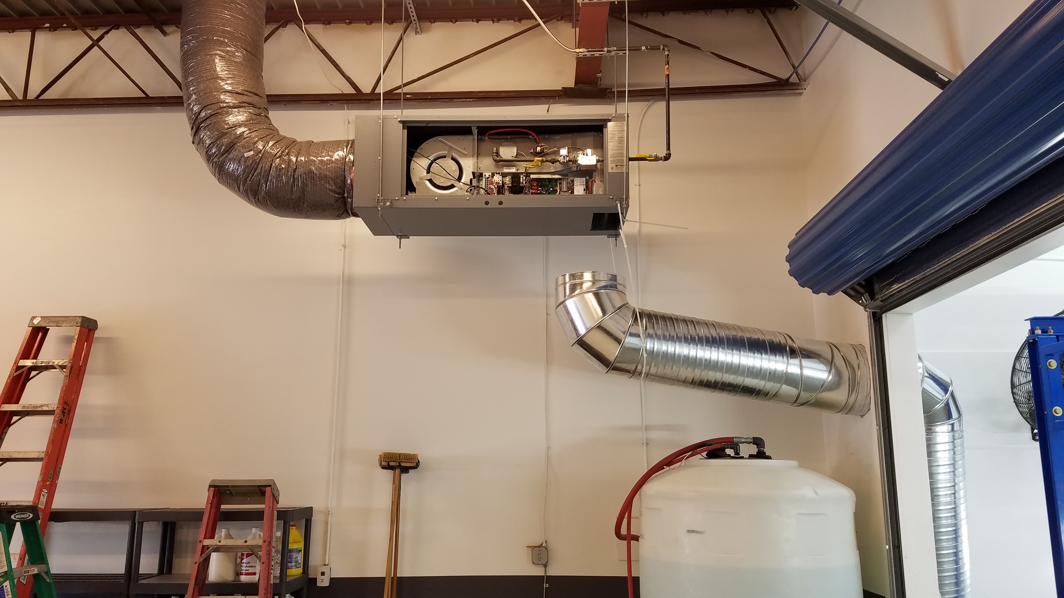

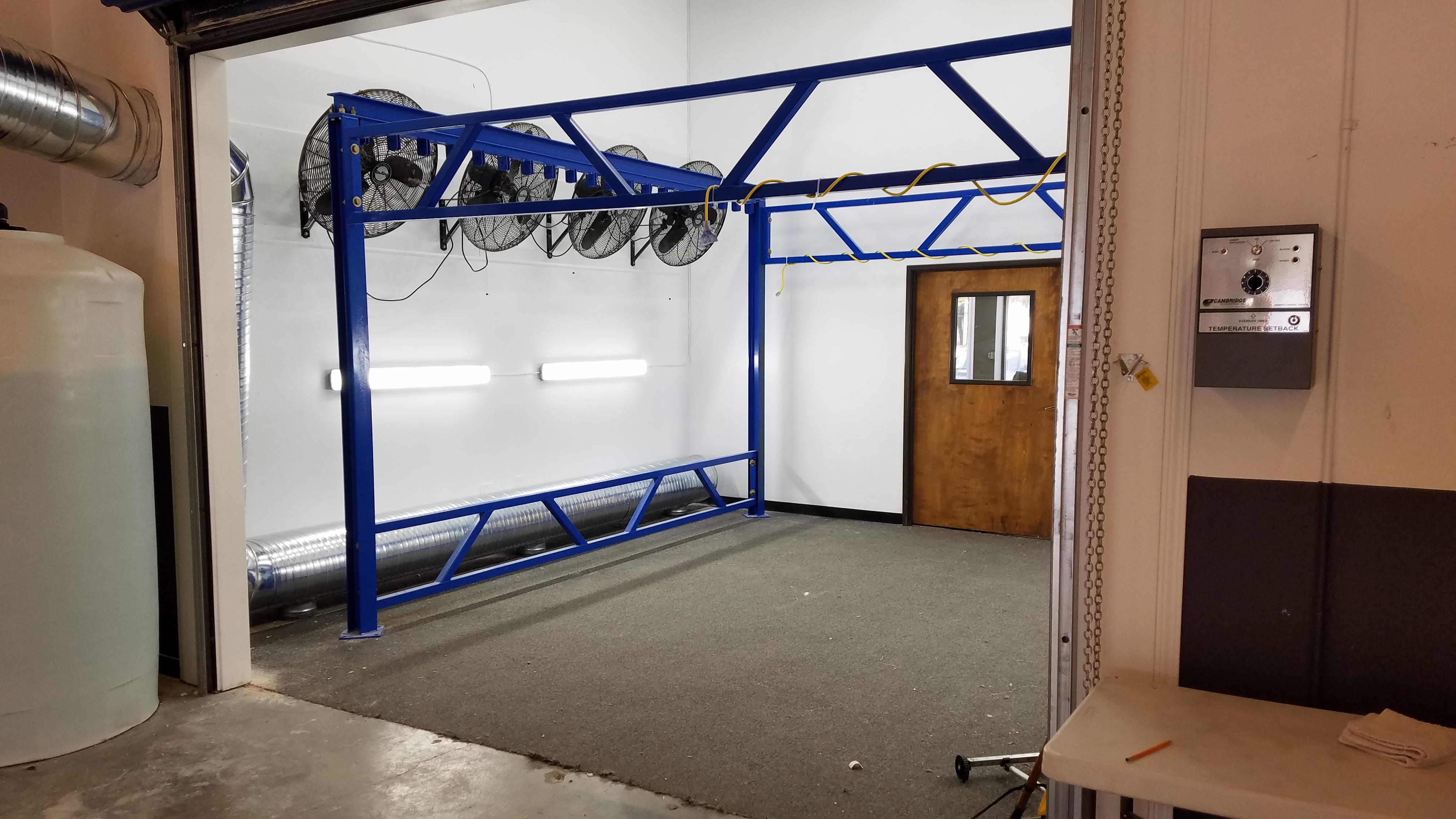

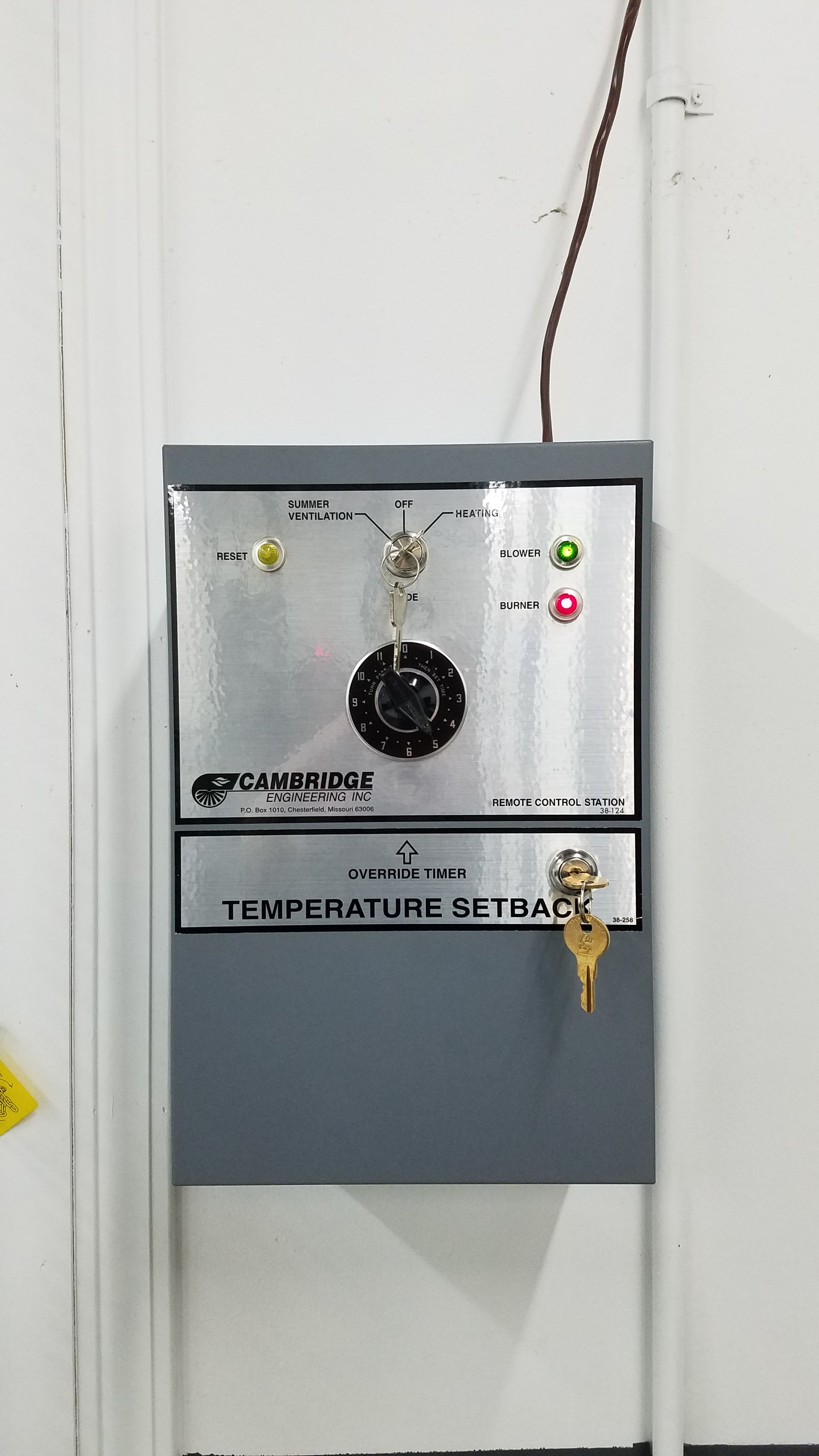

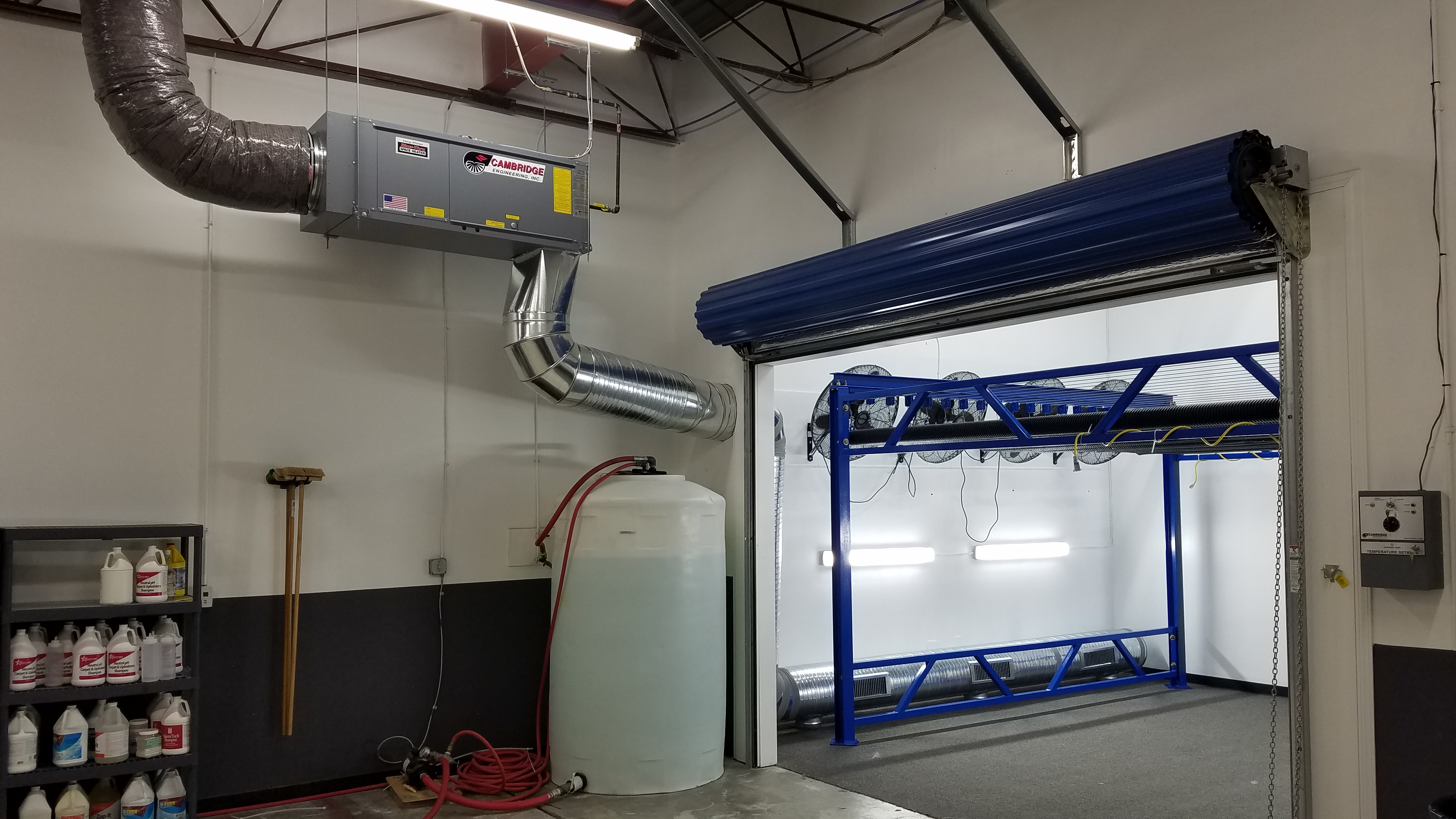

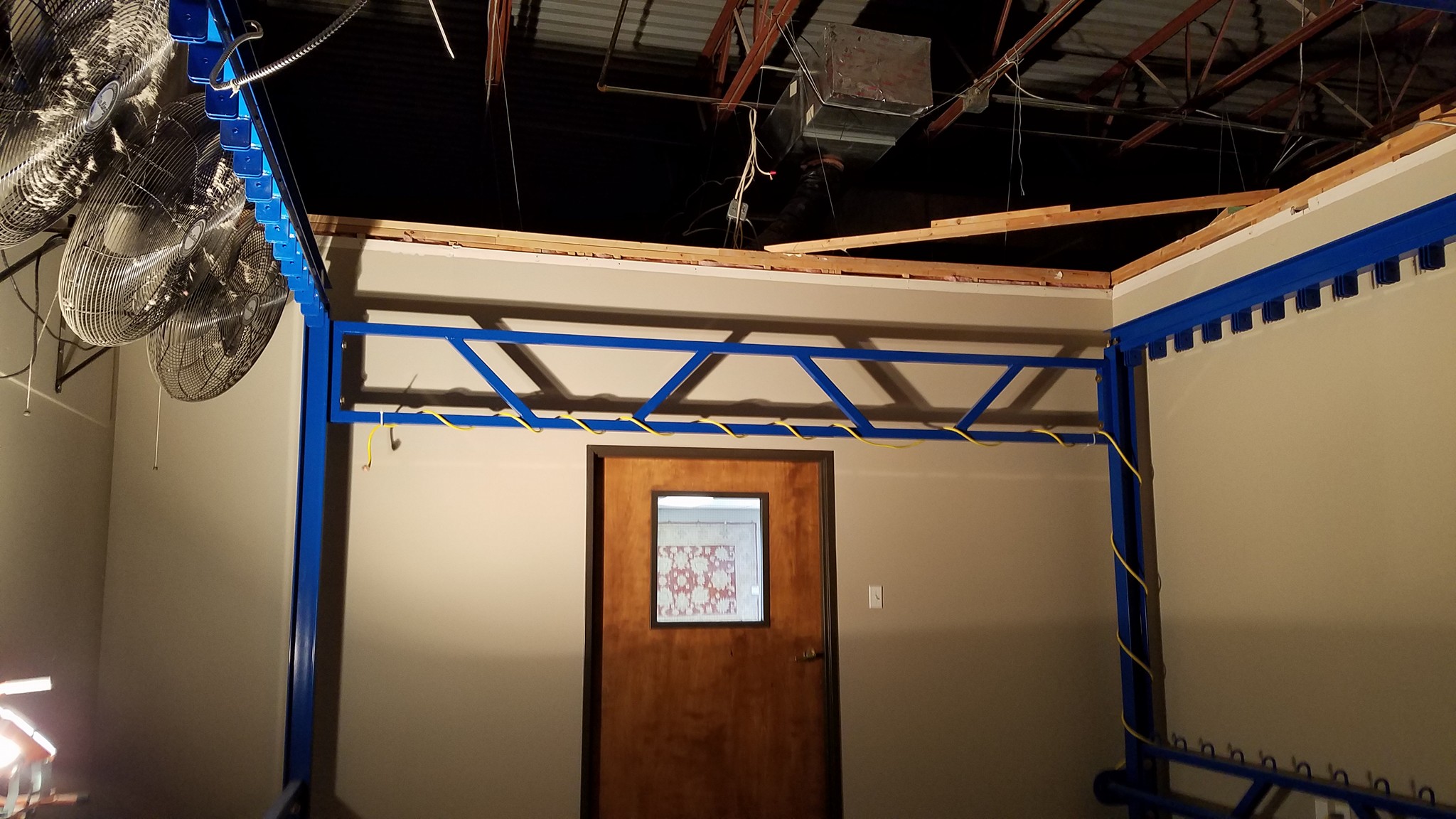

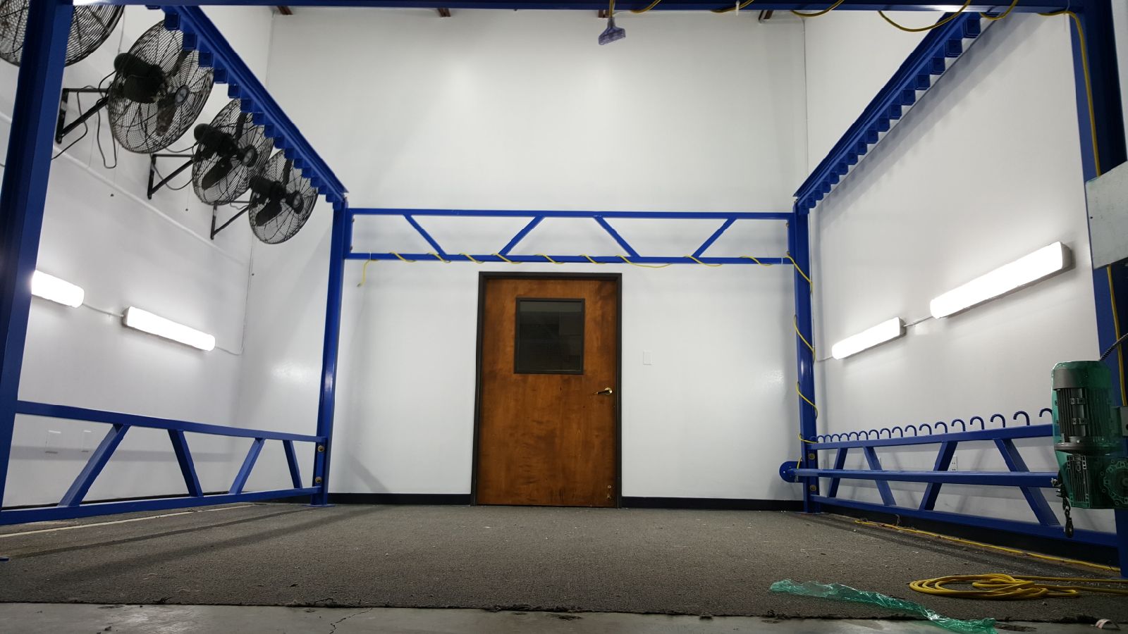

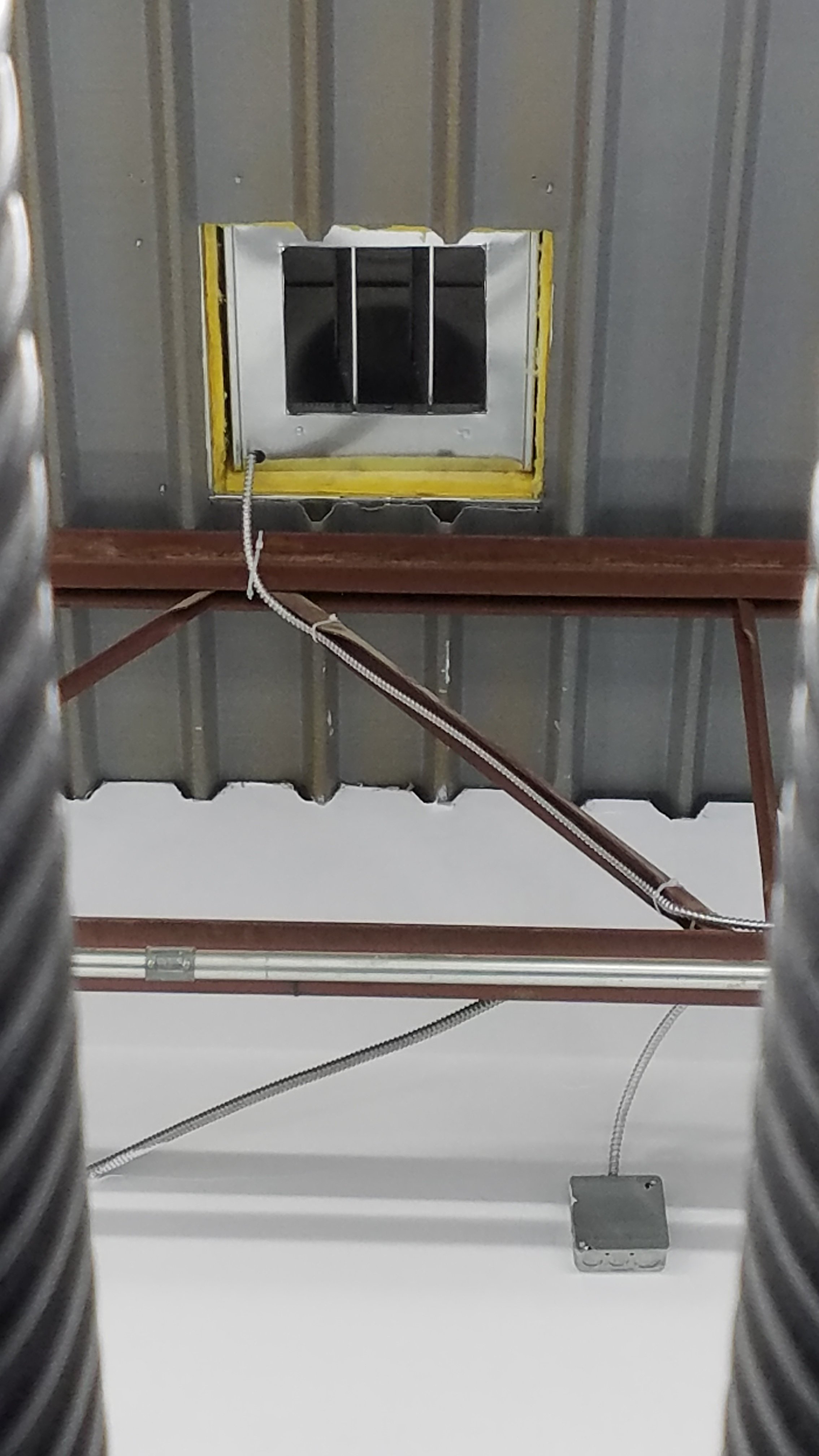

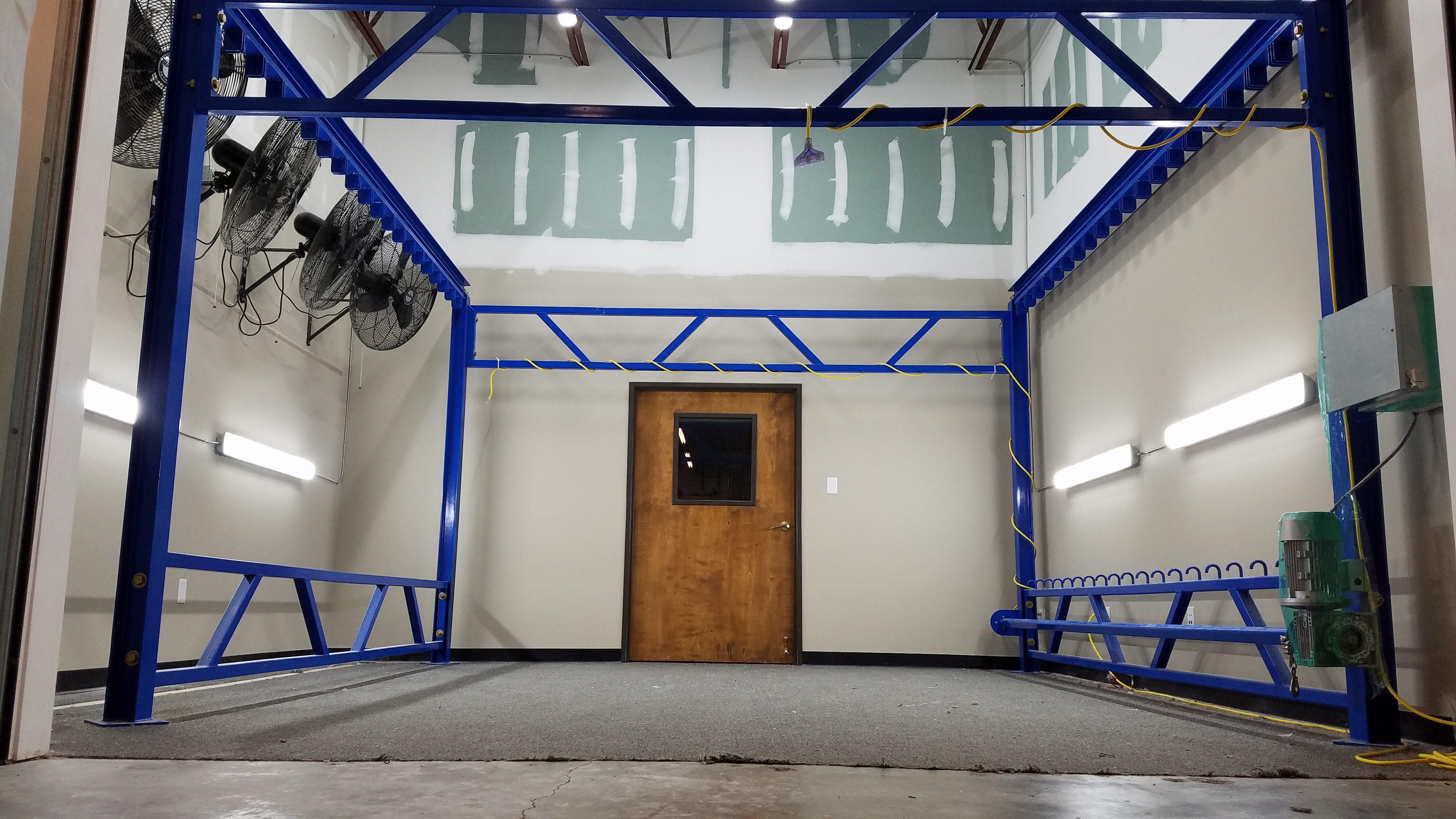

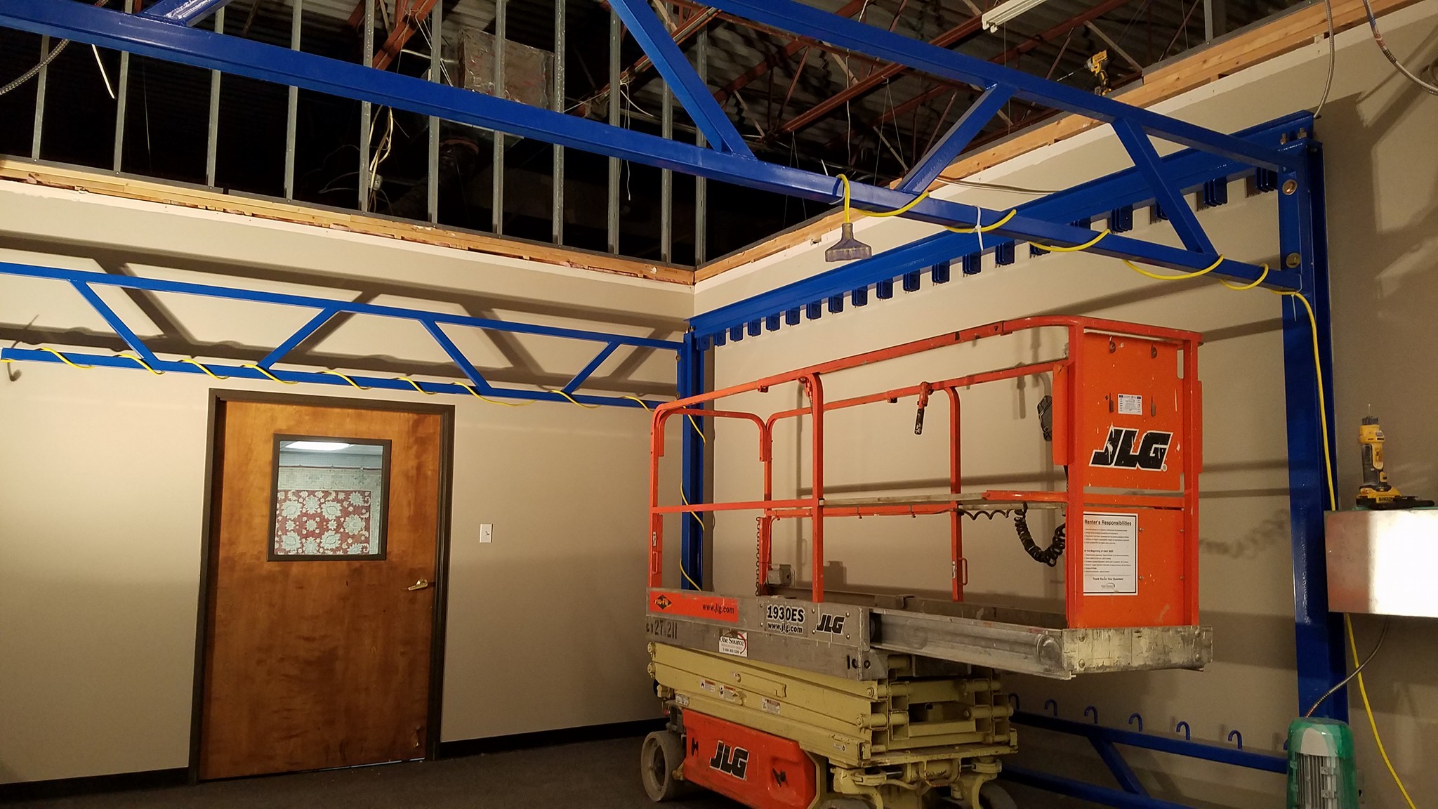

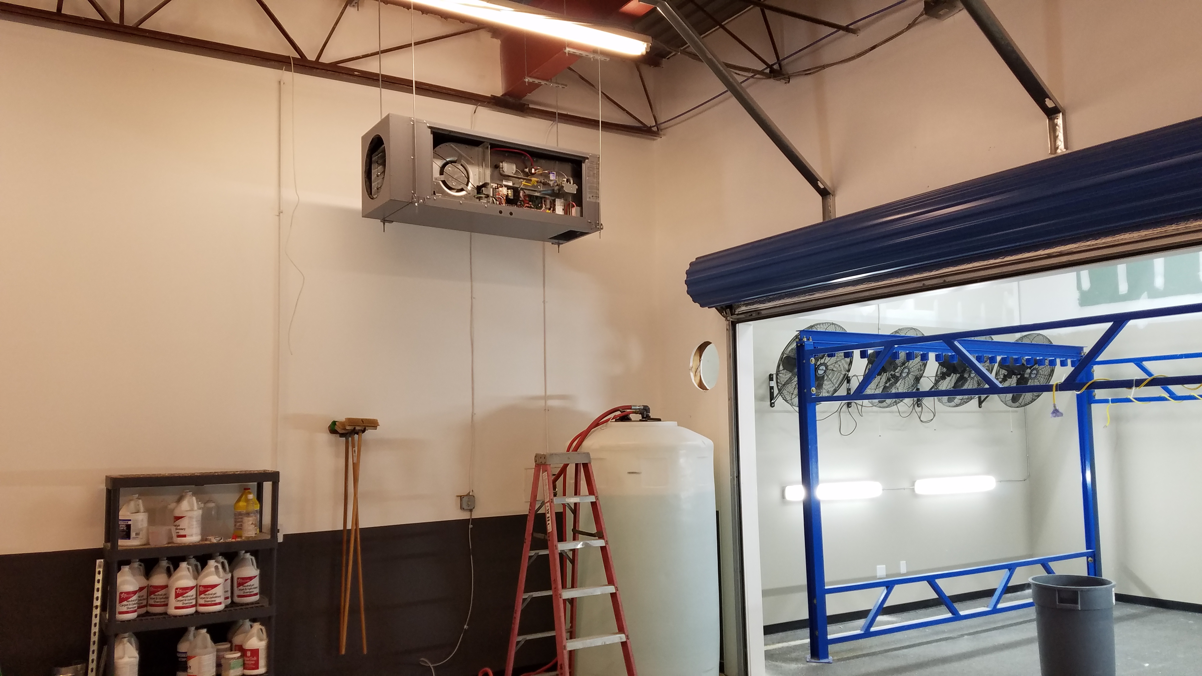

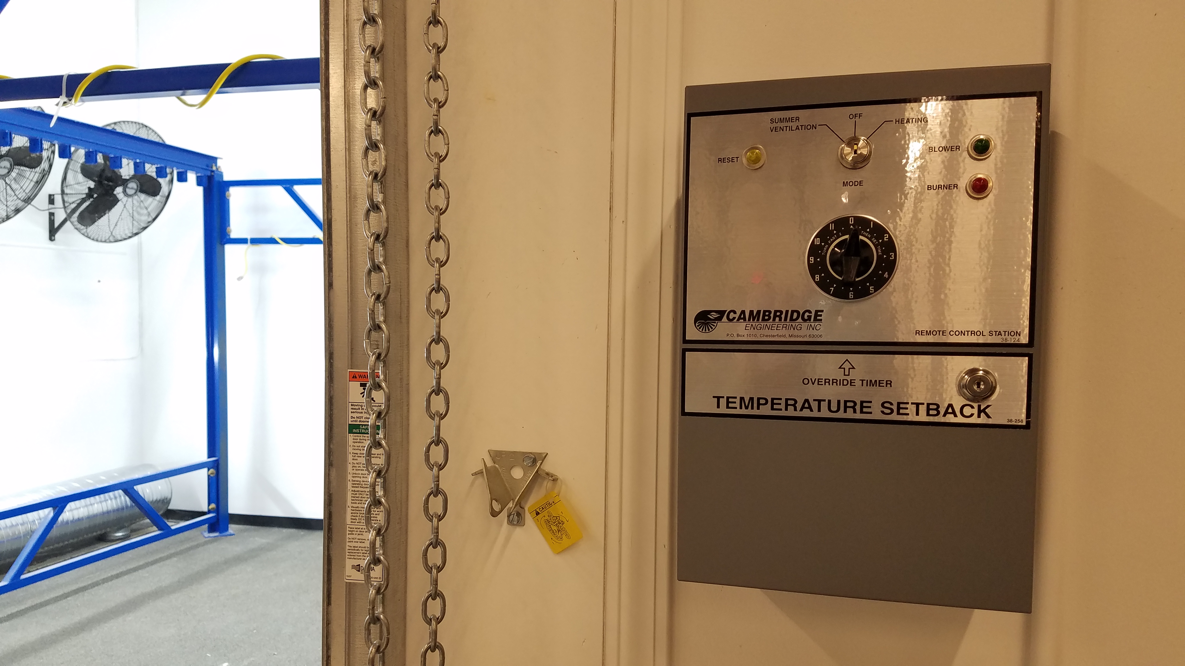

Our dry room upgrades are happening this week. We've been drying in this 16'x16' room with 2 dehumidifiers and air movers for the past few years. With our volume increasing, this method has become less and less effective. We are filling more poles every wash day which is equating to more moisture we are attempting to remove with humidification and our dry times have been suffering (12-20hr+ dry times).
With this new Cambridge SA-250 space heater we expect to see ambient room temperatures hovering around 120-140 degrees, shortening our dry times to consistently less than 8 hours. This allows us to get right into rug finishing the morning following a wash day, effectively allowing us to wash 4-5 days a week without compromising efficiency. We will be using less electricity and overall delivering a higher quality product to our clients.
More pictures to follow through the week...
