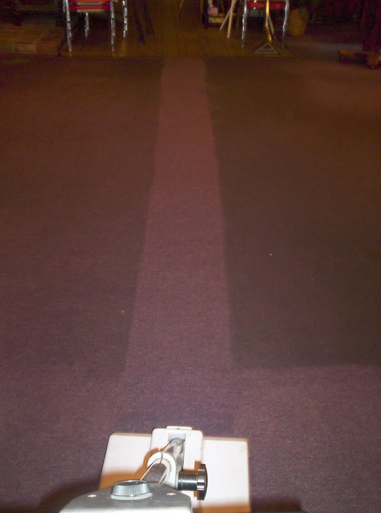

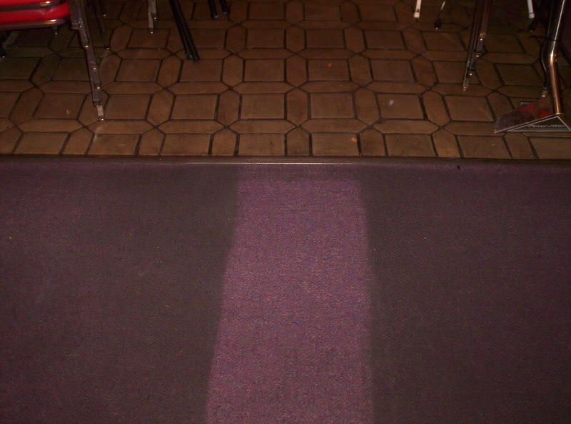

I've used Flex and its pretty strong at the 1:16 dilltion (i think thats what it is).. it will melt away grease.. when i got really really bad carpets like the greasy is so thick you cant hardly see the carpet. i mix it with boost all and citrus solve.. i got a pic of just a job like that..
btw. this is One single pass.
A closer look:
Jim Pemberton hooked me up with it about a year ago. and now its my nuke for the nasties..
