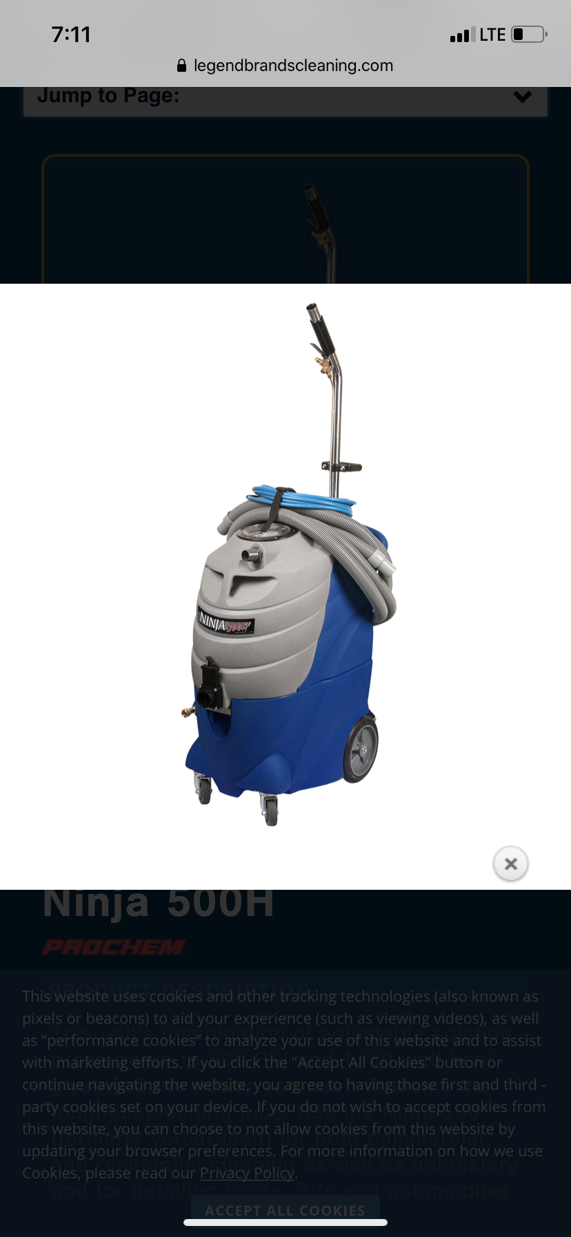

ok I’m probably gonna get the ninja warrior then. They said that the Ninja H had new vac motors. Here’s a picture of it.
27,065
The Warrior is a decent machine as long as you get the 3 stage vac motors. You want the 500 psi pump. Don't bother with heat. Heat comes at the expense of either vacuum or pump power. The Warrior has 2 inch plumbing allowing longer hose runs. Let's you keep the machine downstairs, just adding extra hose to do the upper level. Buy at least 50 feet of 2 inch vac hose and no more than 10 feet of 1.5 inch hose to use as a whip.
