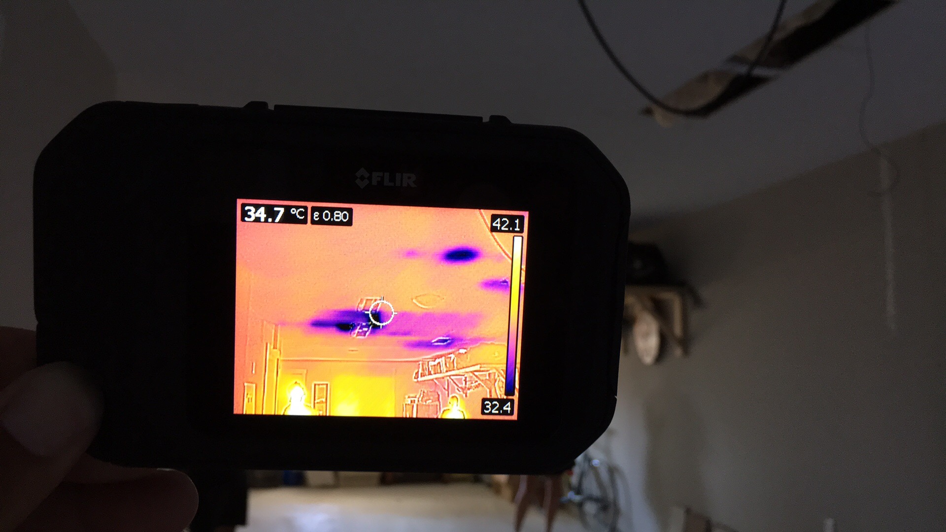

Posted a C2 pic for a job from yesterday. I don't use the actual camera of the C2, I guess habit from the old B Cam's we had. It's enough to point me to what I should be concerned about looking at further.
