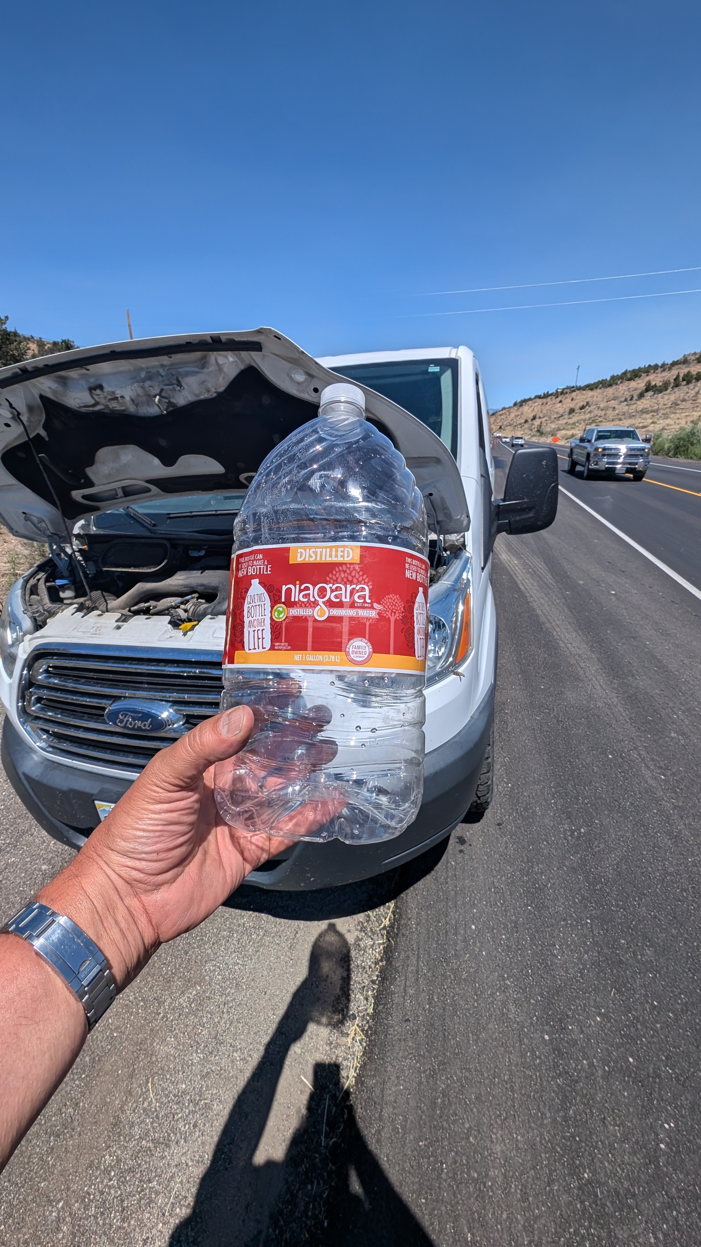

There's at least two reasons to always keep distilled water on your working vehicle
116,371
Virtually every two lane road in our county is being repaved this year and sitting in the stalled traffic at 95 degrees cuased it to over heat....
