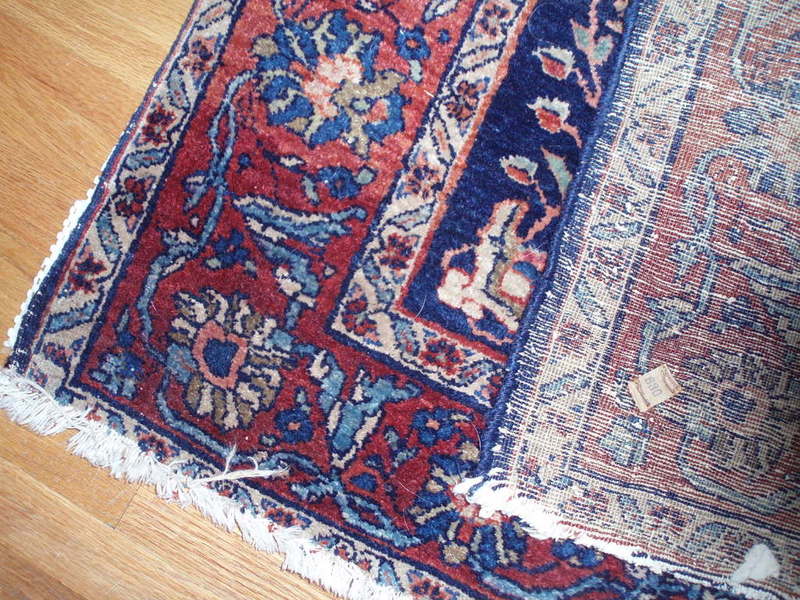

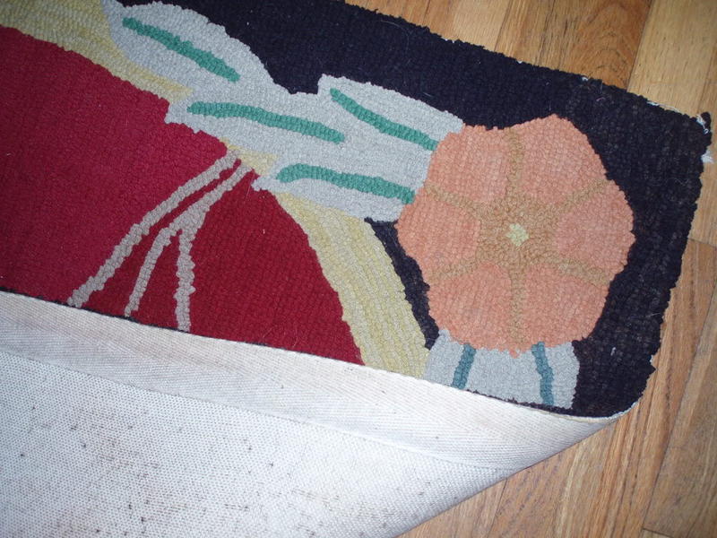

Got a few more..
( how long will this thread go?)

2. Sarouk is the quick answer although some are not actually Sarouk. Colors weave, design. Should wash fine dry rot is sometimes an issue be very careful when handling wet
3. Hooked rug. If the binding on the side is a glued on separate piece of material it’s Indian. Cinese if folded over usually hand sewn sometimes glued One way to tell a tufted rug is from China or India.

Hooked rug. If the binding on the side is a glued on separate piece of material it’s Indian. Chinese if folded over usually hand sewn sometimes glued One way to tell a tufted rug is from China or India.
I sort of put that hooked up as a joke but damn if I didn't learn something to impress Mrs Piftleton.
