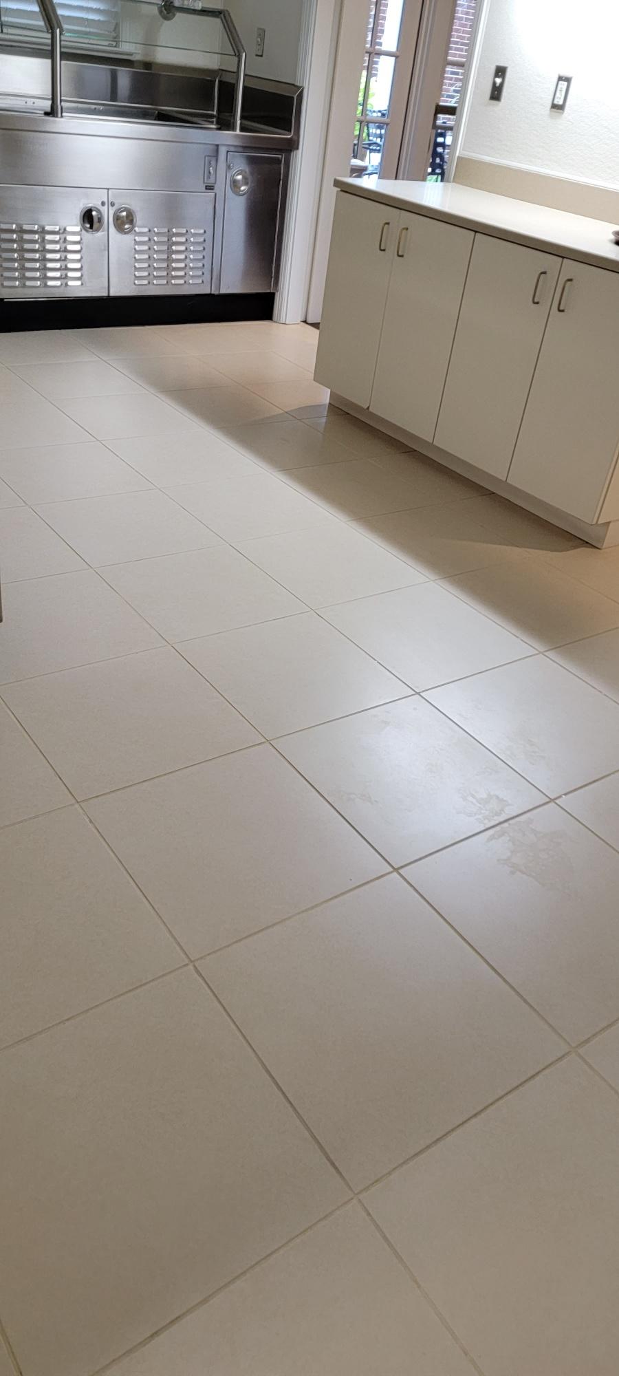

Crappy Chinese products again. Cool.
Fixing the problem is not my monkey. The whole circus belongs to the manufacturers and the retailers that sell Chinese psuedo-porcelain tile as if it were real porcelain.
As usual, we'll just get to give the homeowner the bad news.
PS: That reasearchgate article is great. I just summarized it above.

The "source is China...
Tile retailers here in the US are at fault for selling us this phony porcelain, but I truly believe that they don't know it, yet.

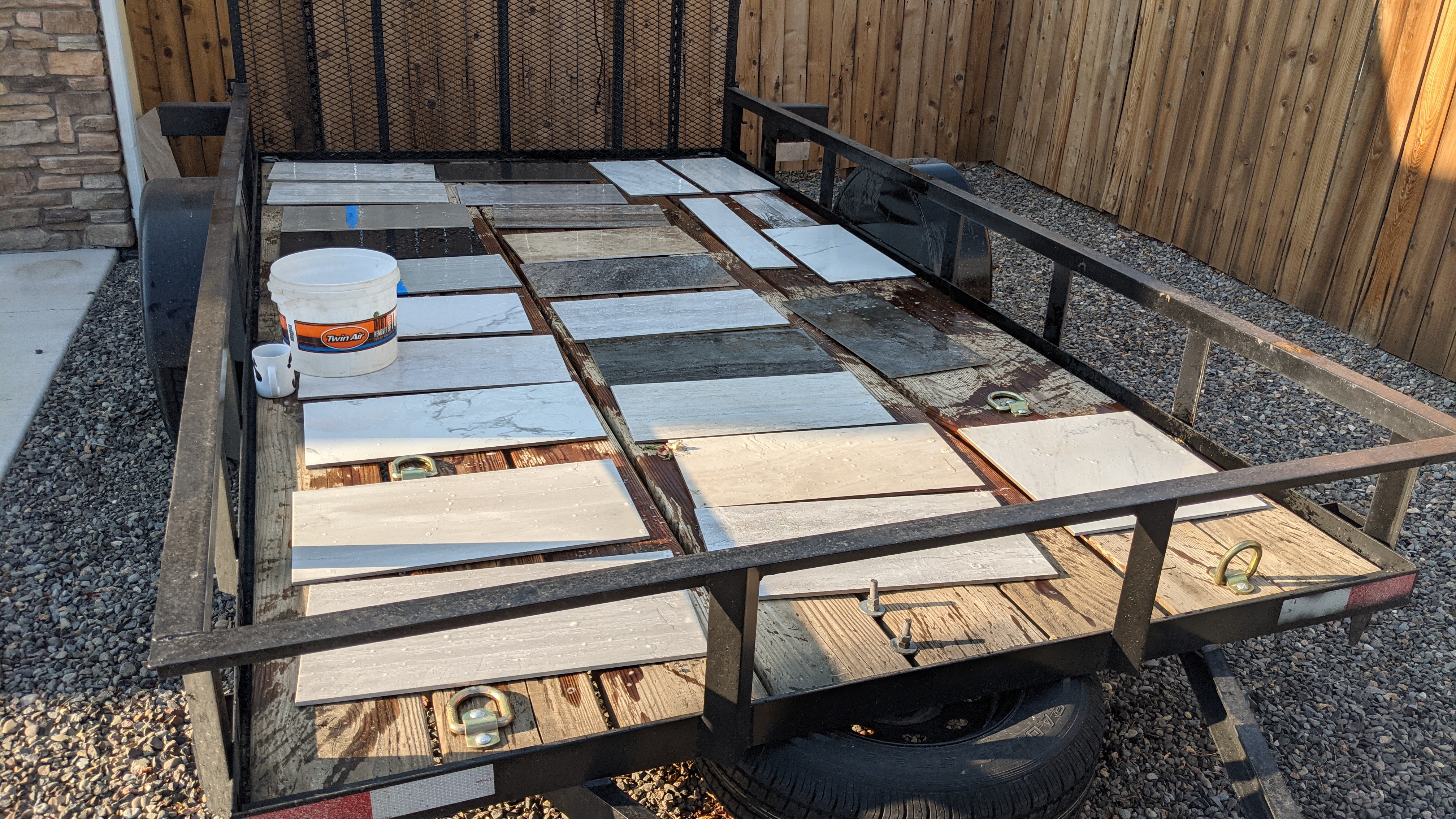

So I messed around in the garage today taking a different approach to five more pH burned tiles.
Using the same Italian cream that I had used mechanically before, this time I used a 3-in hog's hair punch out and spent about 1 minute per 9-in by 9-in section.
I didn't let the cream dry out and didn't put much weight into it and guess what, this worked beautifully.
I can now safely assume that a typical 90 lb 175 and maybe even a quality white pad would do the same thing very quickly.
I realize now that we were working too hard and too fast in Phoenix and ended up over polishing and in one case removing some of the glaze by sitting on the tiles too long working the cream from wet the dry.
Stu Rosen is still not sure he wants this to be the product that he recommends to carpet cleaners so we are waiting on something else to come in from Italy that may also have some protective qualities to it.
And speaking of protective qualities, I'm finding that this creme make the tiles much more resistant to pH burn.

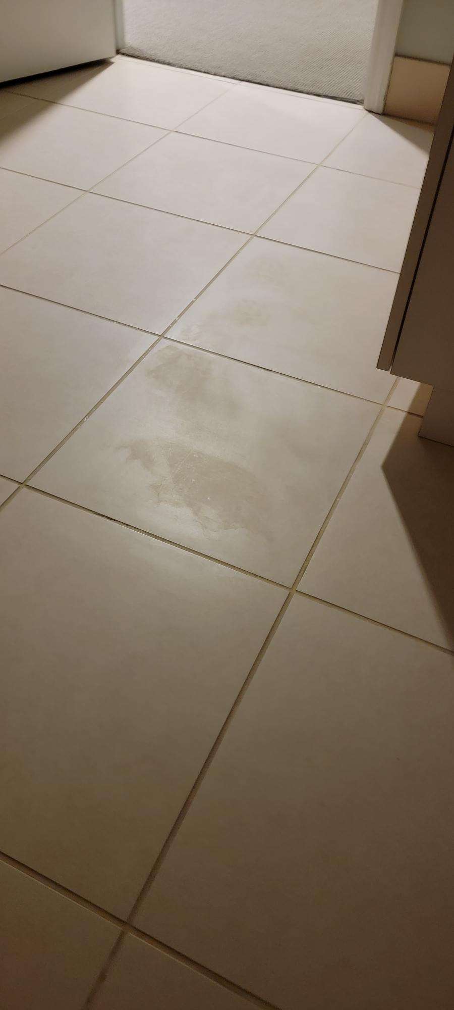

And another..
2006, college sorority house kitchen..
"Powder burns"...
Acid rinsing and buffing would not fix so it's time to try the restoration cream

Enlightened information has been found!!! Citrus solvent exists in a lot of powders that may be causing this too? Probably just high ph as I have used traffic slam and viper venom and have seen these results as well I believe but my memory is failing me, it may have just been a powder high ph with citrus that I have had problems with? And the plastic ring as Mikey has mentioned to stick with the brush ring I will take note of that ( I have had ring problems with plastic as well). Glad you are working on this, it's a nightmare for the clients and us.
Maybe I will try my wool perfect prespray and Ice rinse with DI water next time and see what happens.
