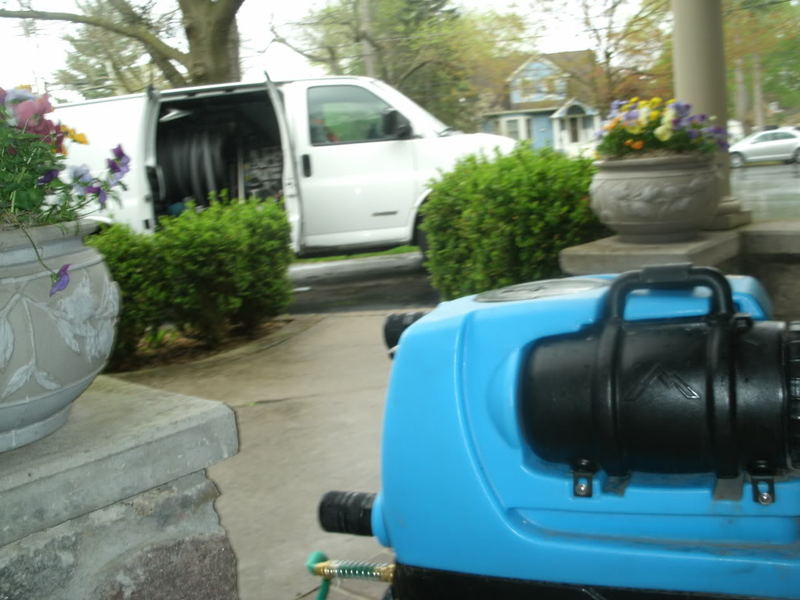

Wand was almost too hot to handle. Little giant #4. Tomorrow I will get my fuel reciept and see exactly how many gallons per hour it works out to be.
3 hours residential at high heat
1.5 hours restaurant at highest heat

TNT + Little Giant #4
Used 4.3 US gallons for 4.5 hours of run time = .95 gallons per hour
Under a gallon per hour for the TNT and LG combined!
