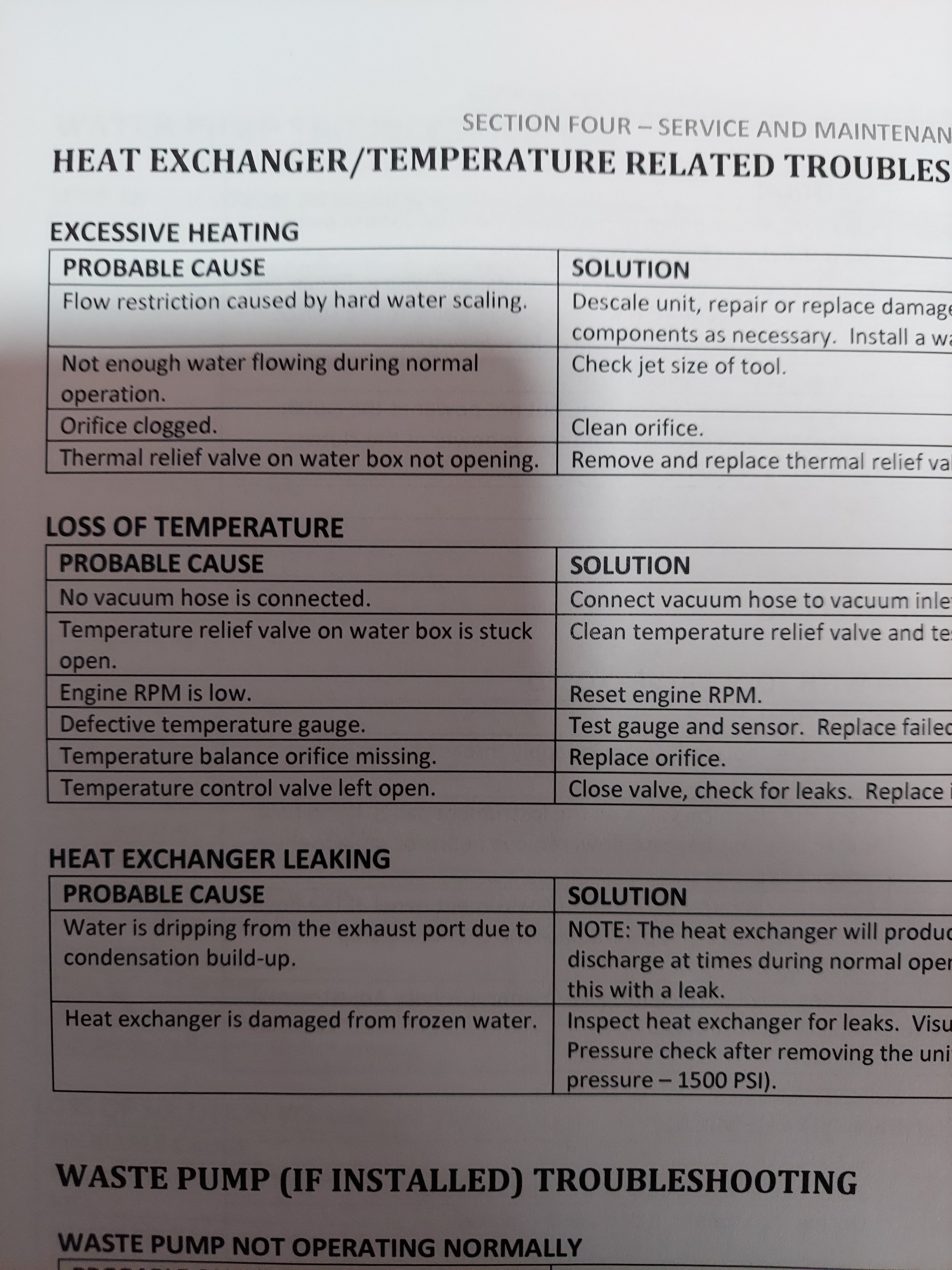

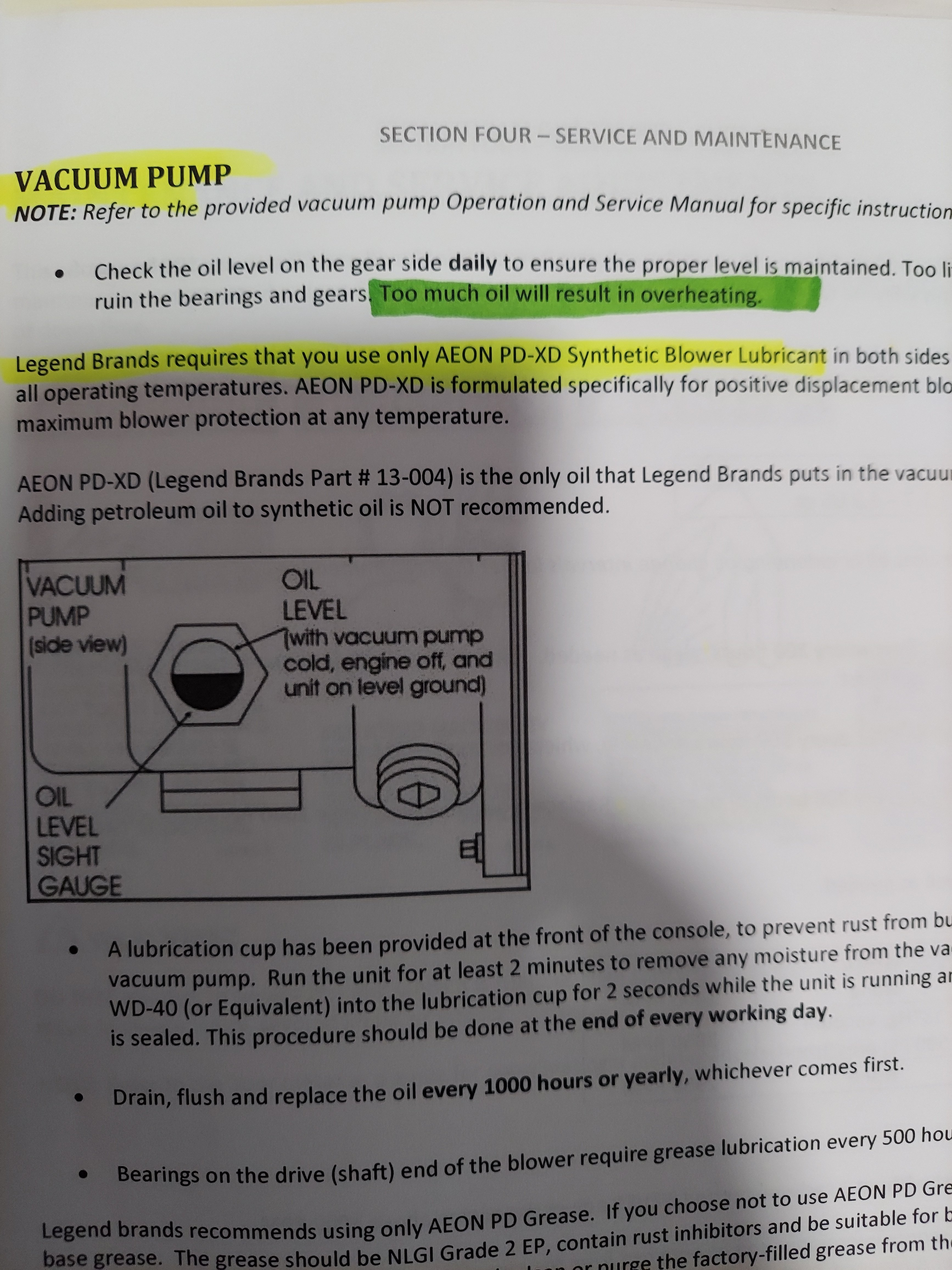

I discovered why my 370 was over heating:
SS 12 wand had only #4 flow and
Too much oil in blower.
:headscratch:
over fill can blow a seal, but doesn't cause excessive heat.
the flow doesn't make sense either .
How could someone use hand tools or most all upl tools??
I also greased the bimba.
