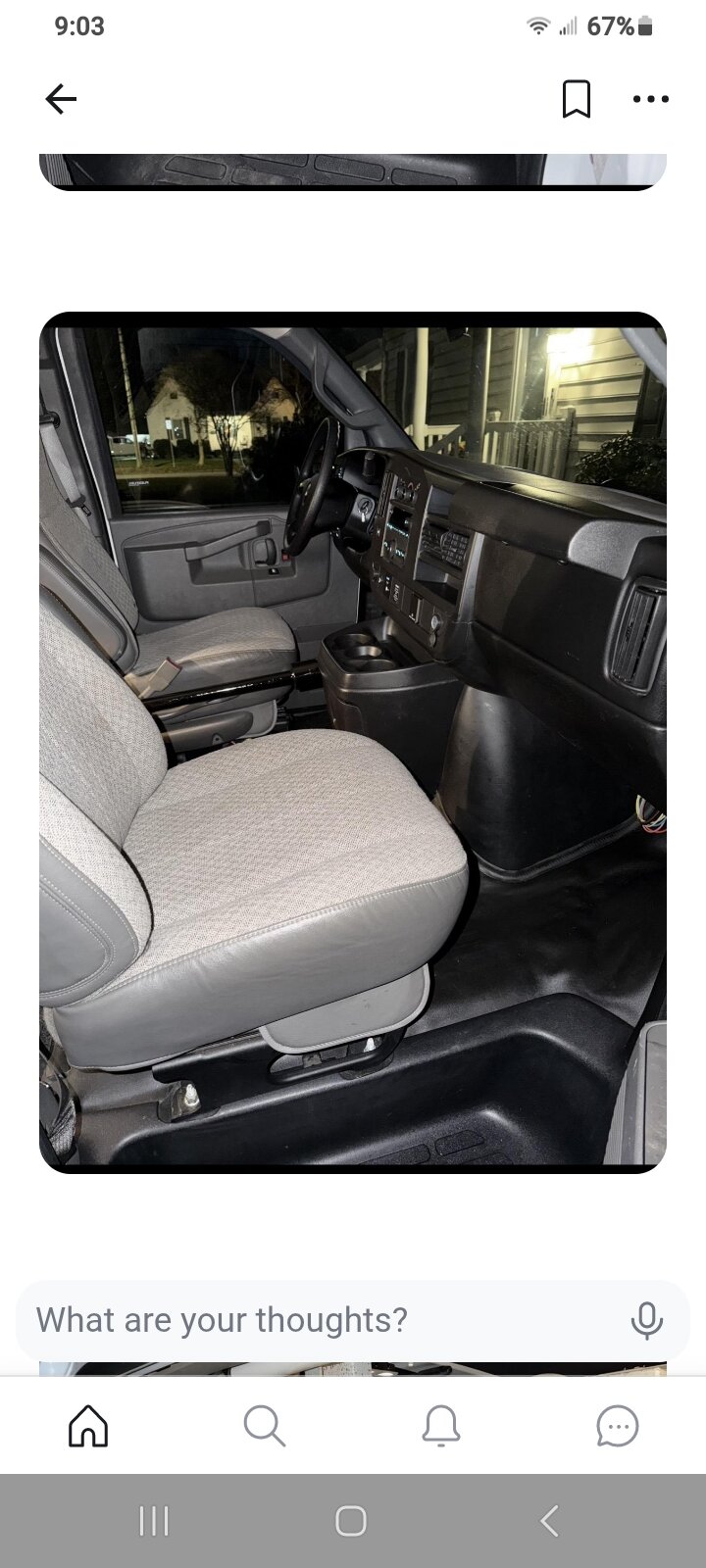

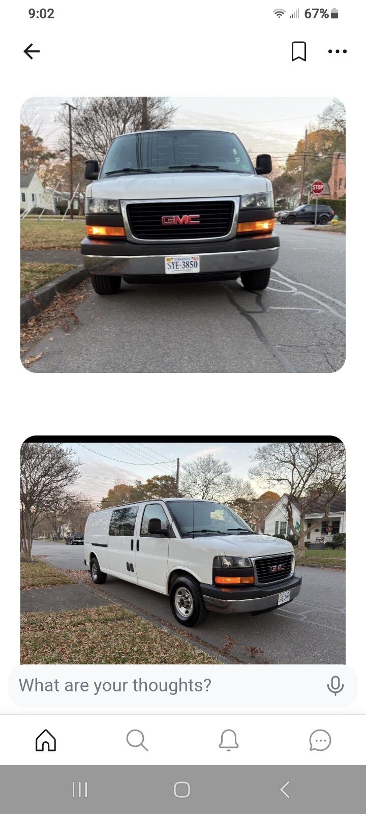

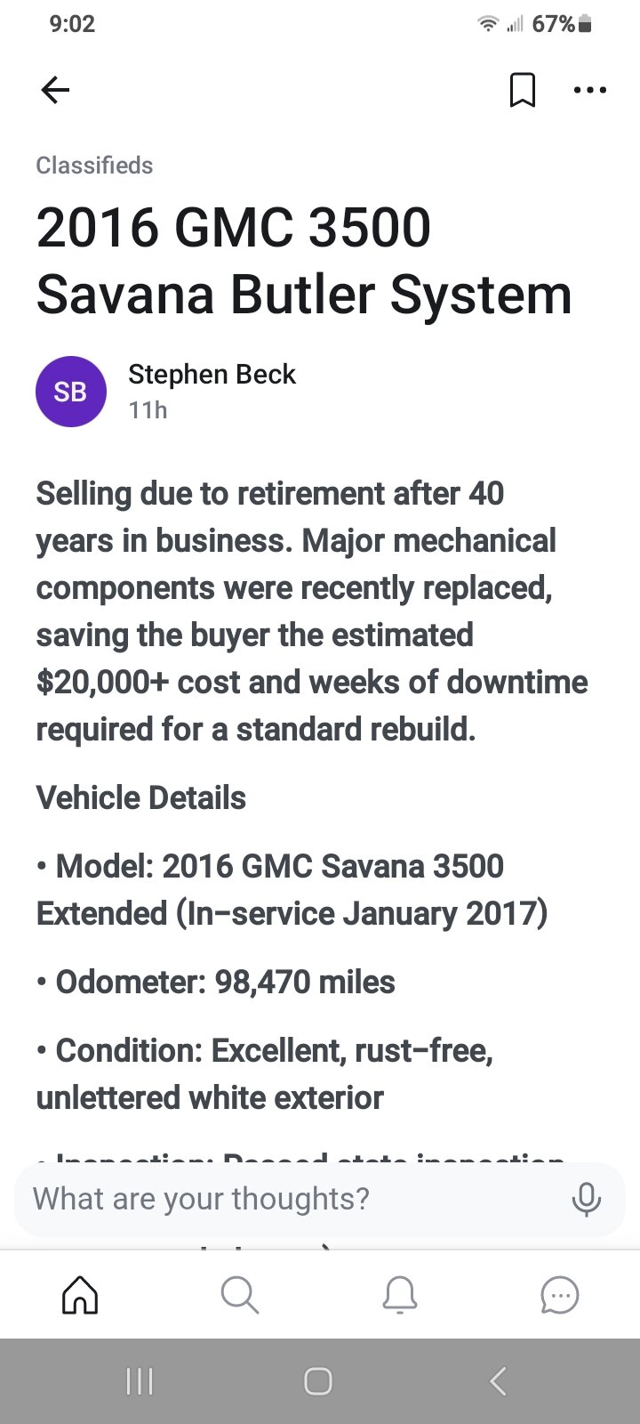

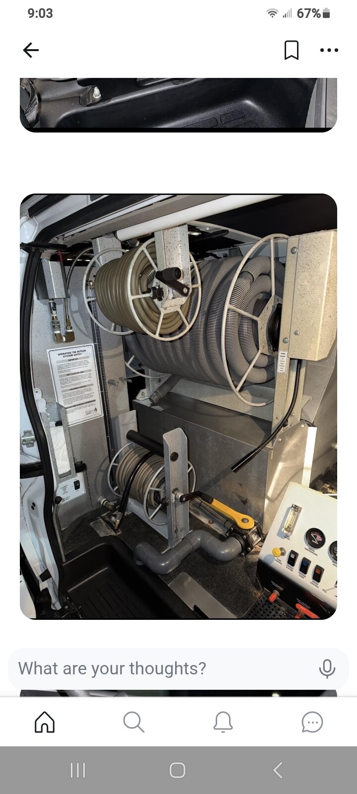

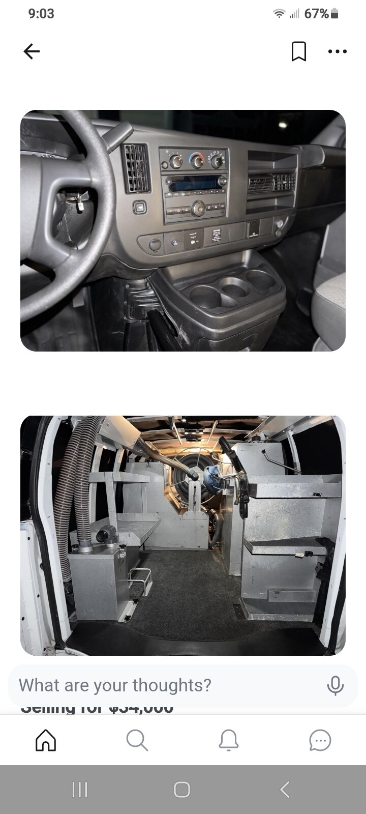

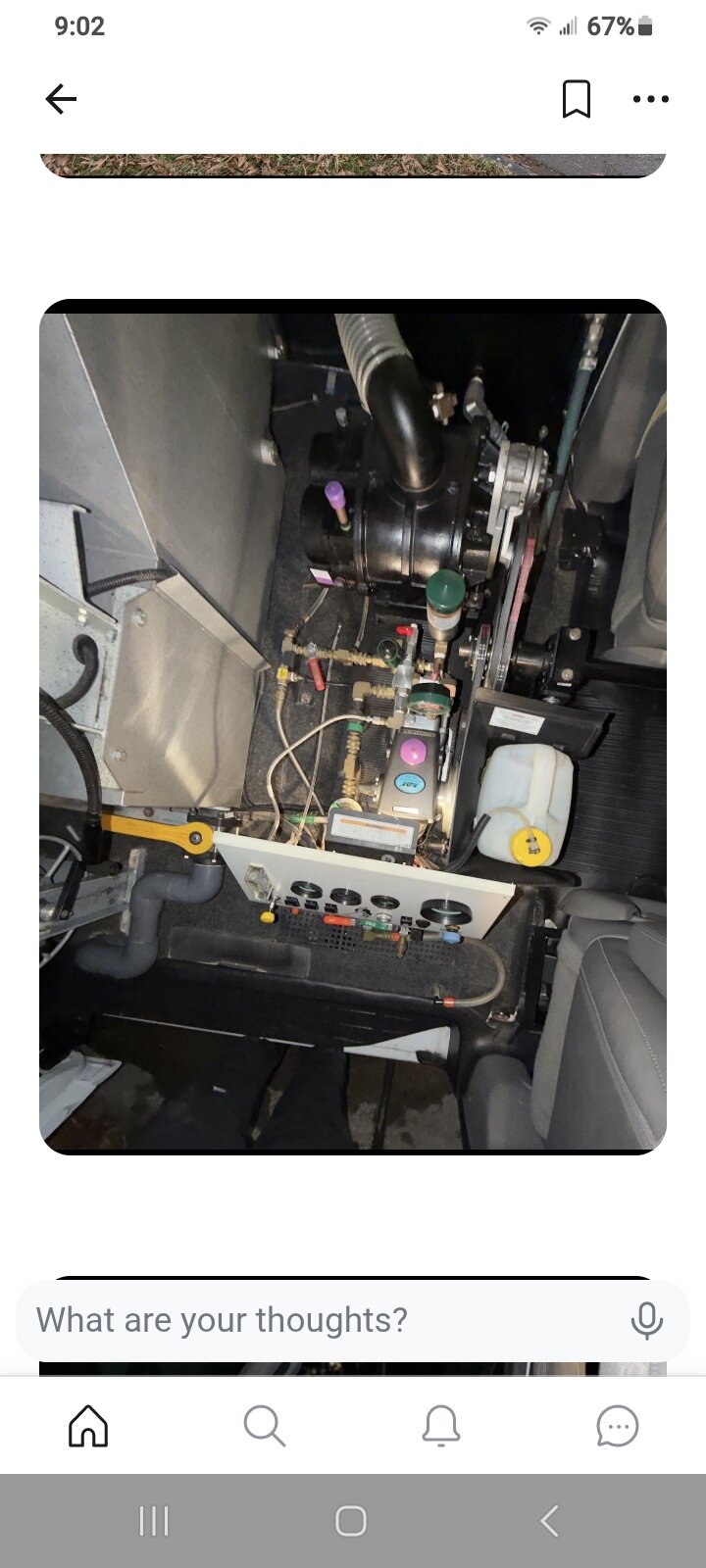

Theres a 2016 butler with a engine & transmission new and under warranty on tfm for sale pictures make it look well maintained asking 34k. Its new enough that a credit union may finance( according to the guys bio hes a few hours away from you in Norfolk Virginia)
Screenshot_20260315_210203_TMF Community.jpg Screenshot_20260315_210214_TMF Community.jpg Screenshot_20260315_210223_TMF Community.jpg Screenshot_20260315_210231_TMF Community.jpg Screenshot_20260315_210249_TMF Community.jpg Screenshot_20260315_210256_TMF Community.jpg Screenshot_20260315_210301_TMF Community.jpg Screenshot_20260315_210307_TMF Community.jpg Screenshot_20260315_210314_TMF Community.jpg Screenshot_20260315_210320_TMF Community.jpg
