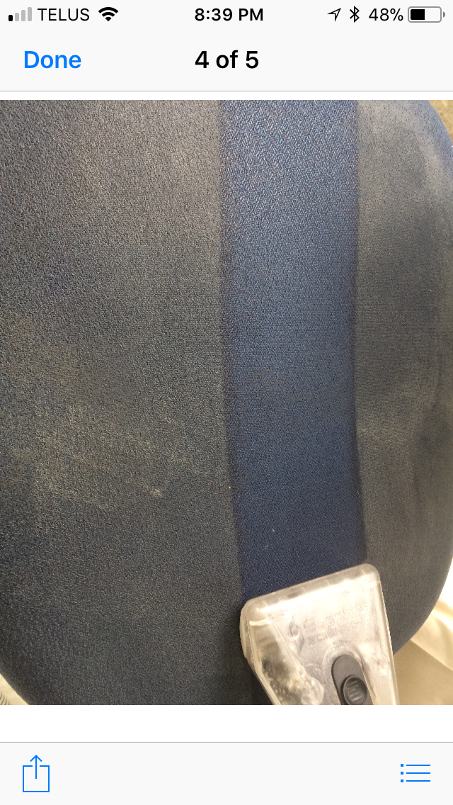

View attachment 79073 Here’s a chair they wanted ‘freshened up’.....
