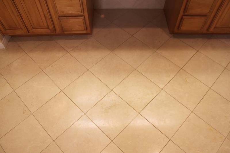

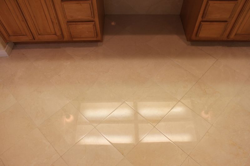

Yes. Like Ted mentioned, if you use a grout brush before vacuuming diamond renew, or any polishing compound, it should clean the the grout fairly well, but 5x will clean as you polish. It basically etches the grout clean. So when clients ask "what about cleaning" I say I am able to incorporate the cleaning process into the polishing process to save you money. Sold.
Here is before an after. The floor was diamond refinished, then polished with 5x. No grout scrubbing, no cleaner, just 5x with a white pad. Notice the grout looks new. The couple dark lines were just still wet, they dried out like the others.
