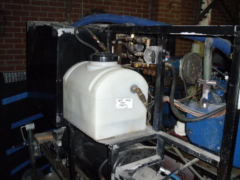

Chris....I will look for the pictures of my plastic tank conversion. About 8 gallons, screw-on lid, fits neat inplace of the aluminum box. Will send ASAP.

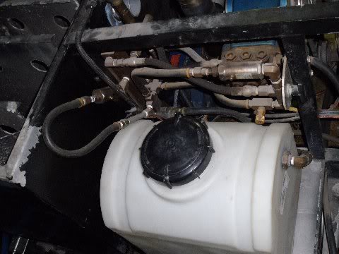

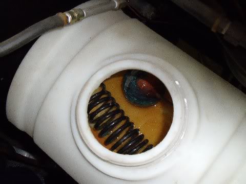

That's the tank I used in my conversion....the 8 gallon tank. Has 4 brass anchors molded into the bottom. I drilled out the holes for the float entry, and also kept the oil cooler lines at the bottom. Had to re-route the one pressure reg. I still can't find the pictures I took, so I'll take new ones tomorrow.
I found the original SW water tank to leak over the top, and down onto the burner coils, causing rusting of the steel heating coils.

Well, there's the pics. Thanks, Mikey. Some day I'll figure out how to post photos. As you can see, I used 2 - 45* brass elbows to angle the 1 regulator up and out of the way of the new tank. The coil is a factory installed oil cooler for the Kohler. I just matched the location of the original fittings on the tank and mounted the inlets and outlets and the oil cooler in the same spot as the original aluminum tank. Used lots of blue sealer, as u can see.

The original seals were foam tape, I believe. The problem I ran into were the nasty roads around here. The van would be bouncing all around, and with a full water box, it would find a way to spill over and on to the heater coil jacket. The new plastic tank with the screw on lid contains the water.
